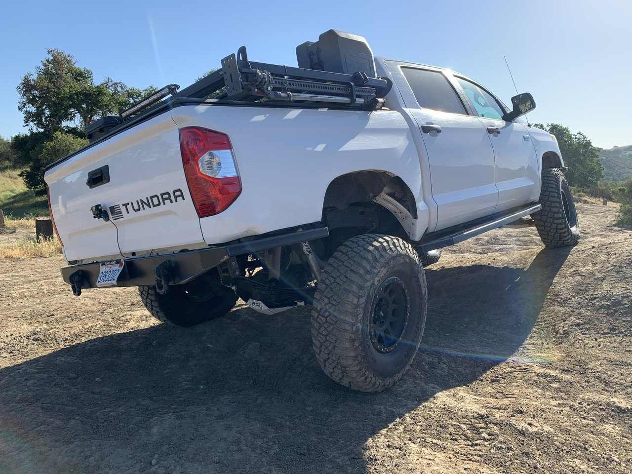

    When I first had 39s the rear tire would rub on the high clearance bumper when flexing.

    Sunnyvale, CA
    Build Page: Cruzer's Re-Build for the Rubicon
    Found a picture of it. Was on a little mound to test flex.

    Yeah I have a feeling when I tub the firewall and trim the fenders I'll end up having to build new bumpers for it. And I'll definitely be cutting enough out while I'm in there to go up a size just in case.

    I chopped off 4” from the rear bumper wings to clear 40s.
    Your 39s might rub harder than mine did cuz my truck is a lot taller so the bumper was further away from the tire.
