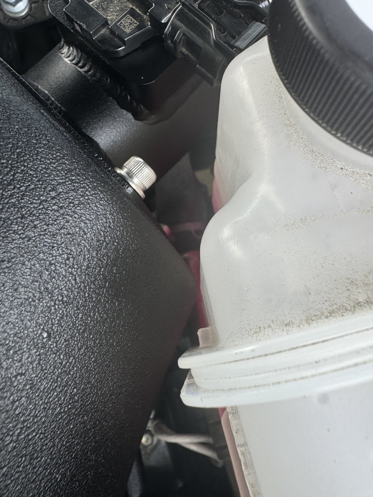

    https://youtube.com/shorts/0kZqsFIFAvw?si=VhjcOWQBjydWIY4kInstalled passenger side only (started raining) to test the fit and see if my CAI have the same problems like the others. After installing just the top box with the aluminum MAF tube and filter (no silicone tubes), the clip easily comes off like others have shown with little impact. But after installing everything else, the box was solid and stayed clipped after a few hard hits. The holes on the MAF tube were also the right size on mine. Took it for a spin to test it out and ran over a few pot holes at speed and the clip stayed secured. Now to see if the driver side will be the same.

    @DaveE that's good. Unfortunately, someone did share with me that their passenger side latch had let go after some driving.
    Can you comment on the lid to res tank contact?

    @eddiefromcali it’s about 2-3mm from the reservoir, very close. I will watch this closely to make sure it doesn’t damage the tank.
    I installed the driver side this evening and the latch on that won’t stay secure with light taps even with everything installed. It seems like the seal and fit on the driver side is better than the passenger side, so the latches don’t close tight. I will try crimping the latches some to see if that will help. I agree with @awpk03s as far as the seal and QC, did not expect this from Stillen. I also agree with the silicone tubes for the ram air that they seem short and the openings are a little big. I wonder if this by design to let water entering the ram air escape?

    Is that passenger side maf installed correctly? Thought instructions had you install it "sideways" parallel with the ground.

    I flipped it after that pic and still the same gap. I was hoping I could get away with it… wanted it uniform (same as driver side), but the wires butt up against the reservoir.
