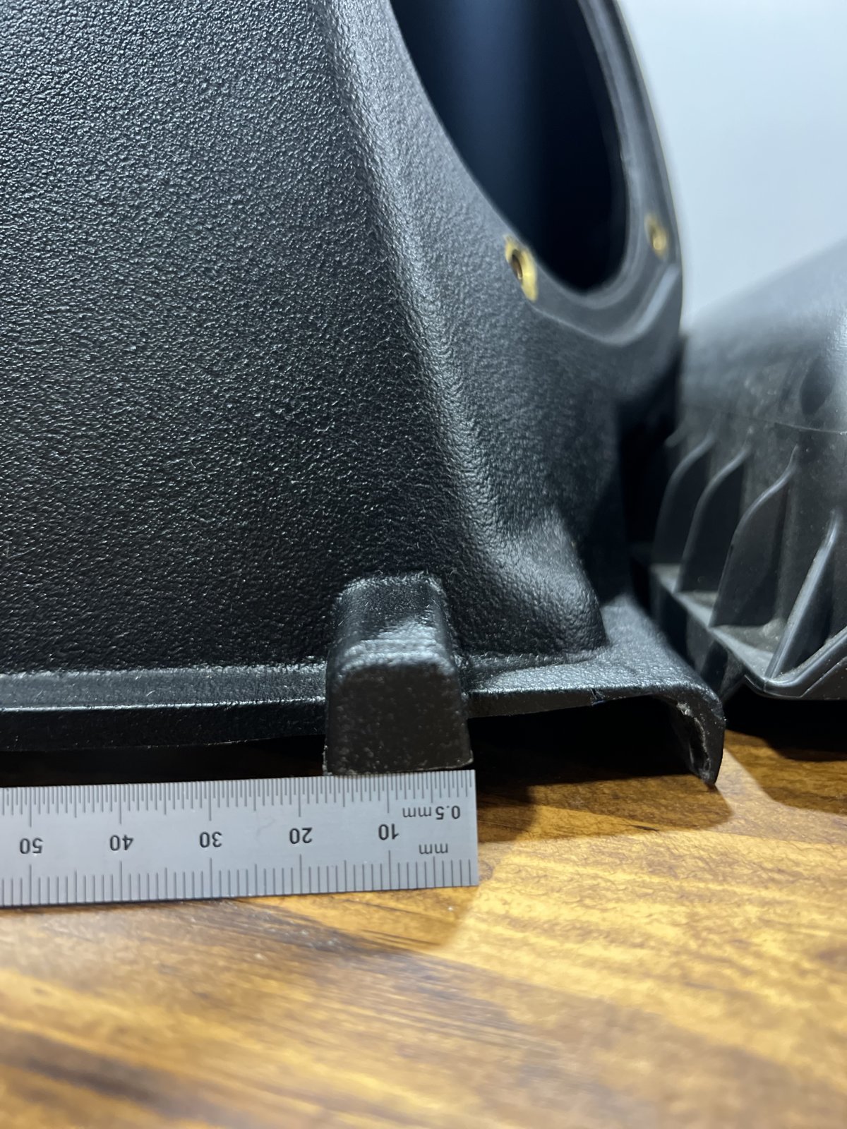

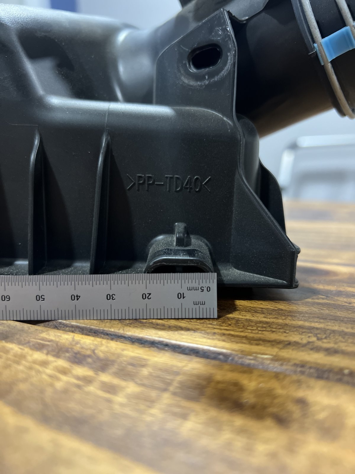

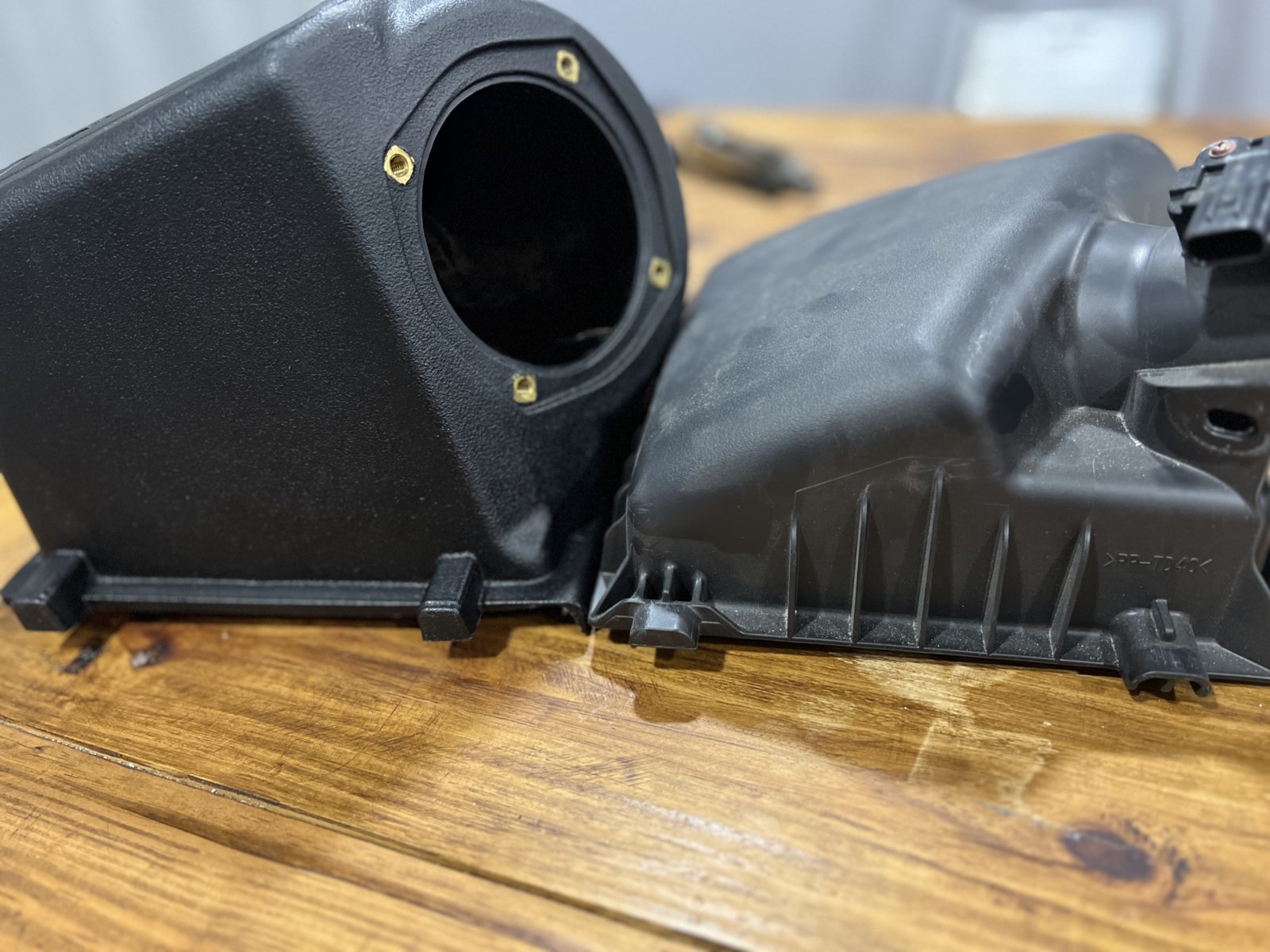

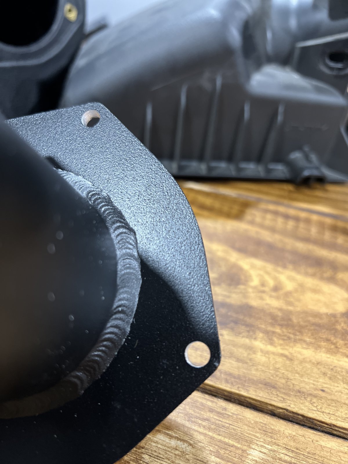

    Some clear revisions I noted were that the passenger side top box had been redesigned to allow for the proper clearance against the coolant reservoir tank so it now does not rub.
    Additionally the seating side (tabs and lip) of both top boxes now has a better QC as far as measurements to allow a closer to OEM fit on the lower box. I am unsure of a change to the molded nuts and how they line up with the holes for the aluminum MAF pipe.
    For the items I didn't see a change on or what still may be improved on.
    The silicone pipe from the front air inlet to the top box is the same length. I personally wish it was lengthened about an inch to allow for better register on both male ends of the top box and the added air scoop.
    Despite the better cut on the tabs that slide under the top box and the cross lip in the back, they're still a smidge thick. Original Toyota top box is around 11-12mm thick and the Stillen top box is around 14-15 mm thick. Also noticing some light leaking through when running a rough fit with a cube light inside. See images above.
