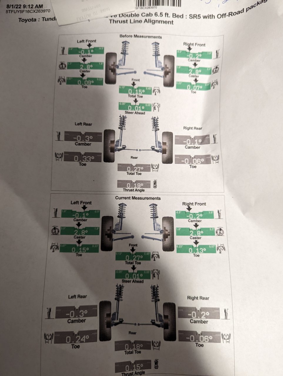

    For reference, here is my alignment sheet from earlier in this saga.
    I'm really out of ideas.
