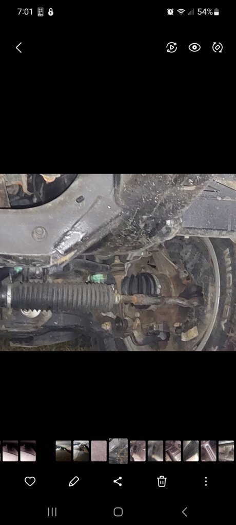

    Just for clarity- Are you refering to outer TRE bushing to "REAR LBJ" bushing as pictured below on right side? Screenshot_20241017_190106_Gallery.jpg
  25. Oct 17, 2024 at 4:07 PM
    #25
    KNABORES
    KNABORES [OP] Sarcasm incoming
    Jan 1, 2020
    #40572
    14,421
    Arkansas
    Referring to the 3 steering rack bushing points and both LBJs.
