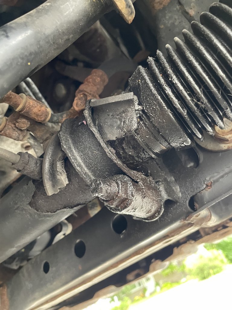

  5. Jul 29, 2025 at 6:48 PM
    #35
    PretzelRodBob
    PretzelRodBob New Member
    Apr 1, 2023
    #94783
    6
    Thank you all for the information! I knew I needed Lower Ball Joints replaced since the right side is making noise. I thought that was my steering issue but after reading this and looking closer, my steering rack bushing is blown out! I'm getting bad tire wear, can't hold a straight line on the road, and now it makes sense why my steering feels like a wet noodle is holding the tires on track. I just got the Dorman 905-400 bushings and they seem extremely stiff which should be a lot nicer. Haven't installed them yet.
    Also probably the seal is leaking...
