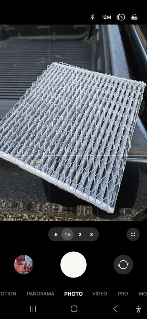

    Had the same problem - my fan was making weird noises when I turned on heat or AC. Turned out my squirrel somehow wedged his way into the cabin filter but eventually got out. Had to pull the glovebox, the cover in the back to pull out a shredded filter, then had to drop the fan behind it to clean out the rest of the mess. Perhaps look back there for the culprit or any other damage?

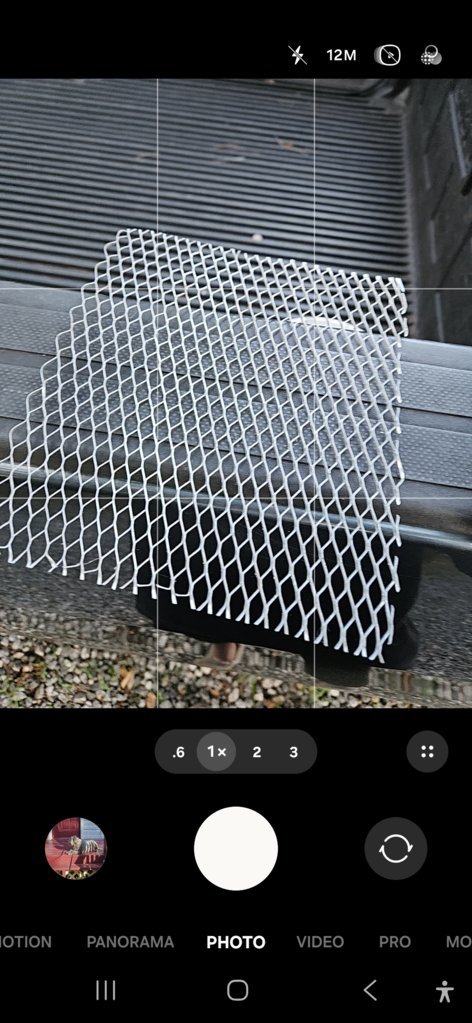

    I cut galvanized lathe from home depot the size of air filter and slid it in along with cabin filter. That way, if squirrel or other rat gets in there, she won't be able to chew it.
