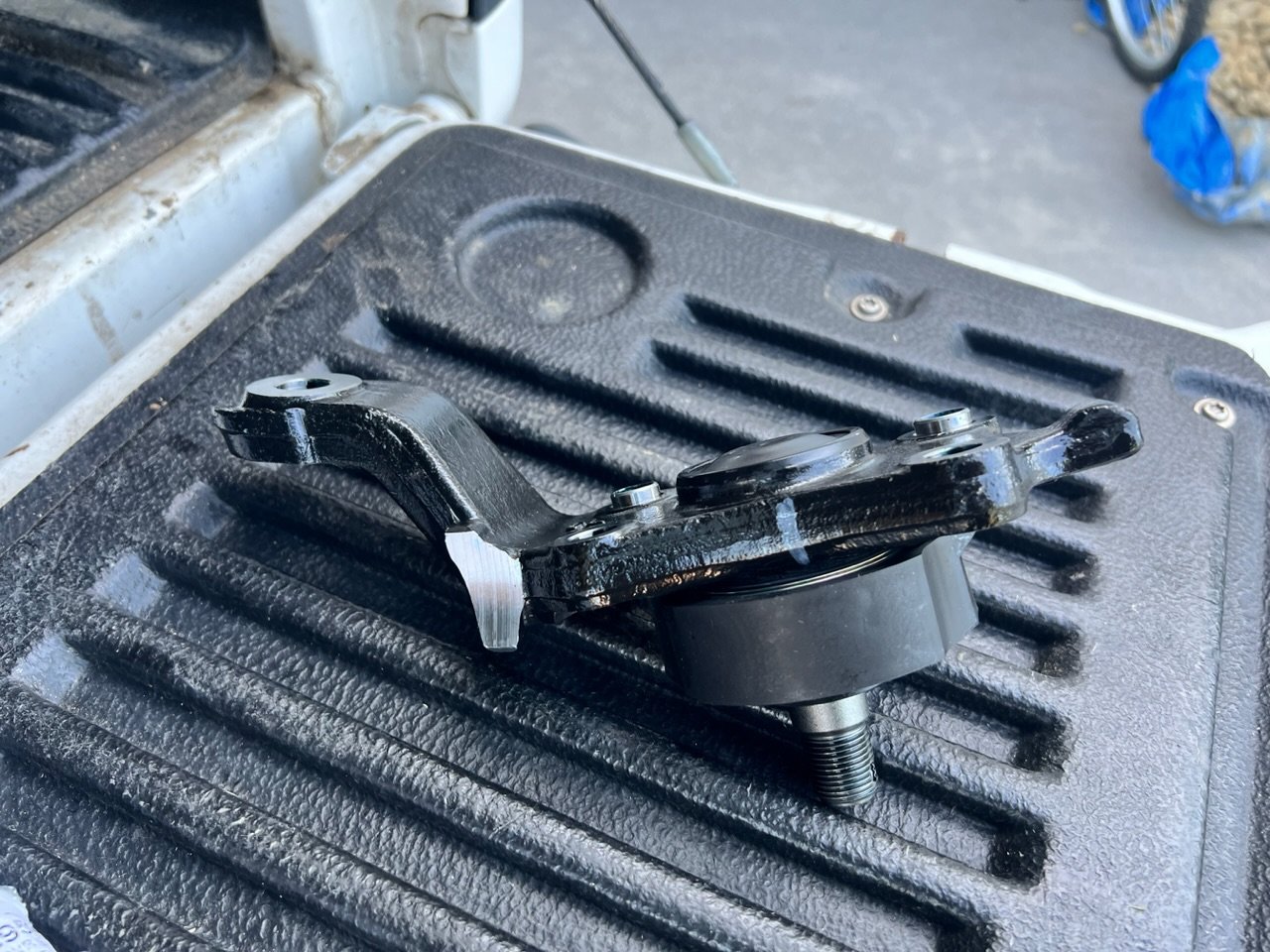

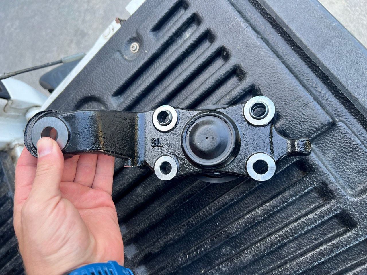

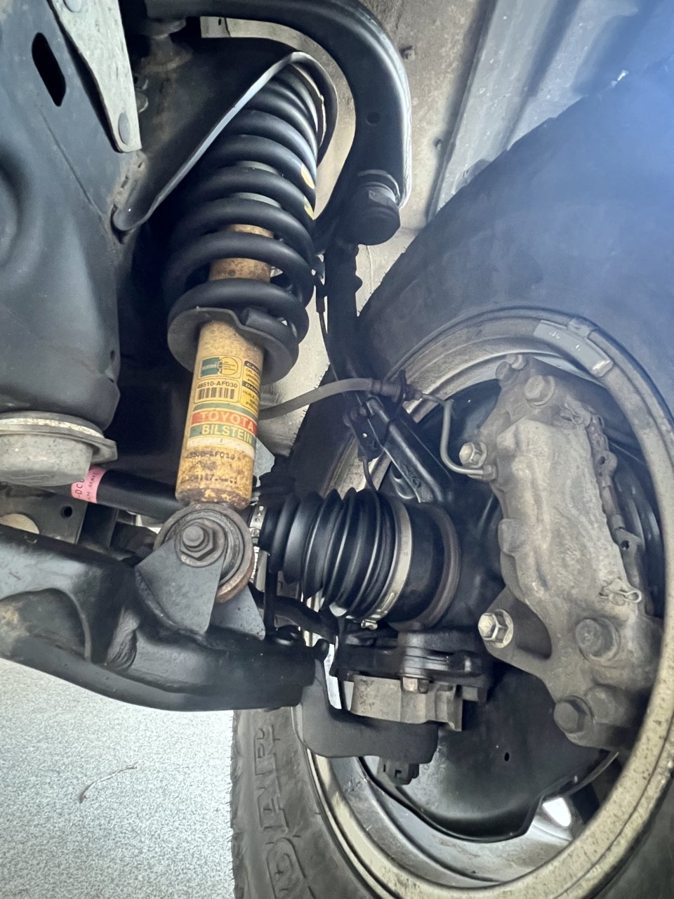

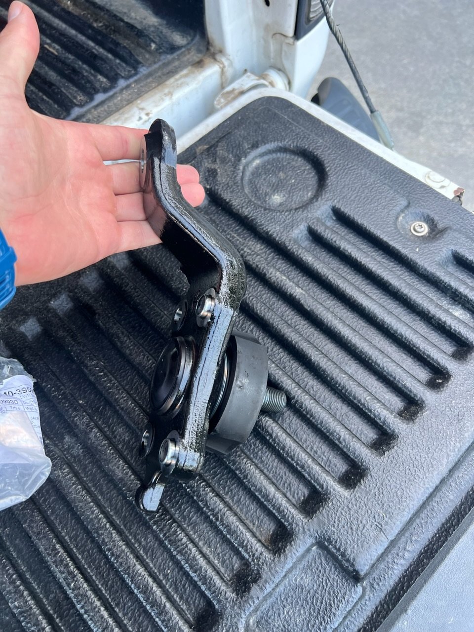

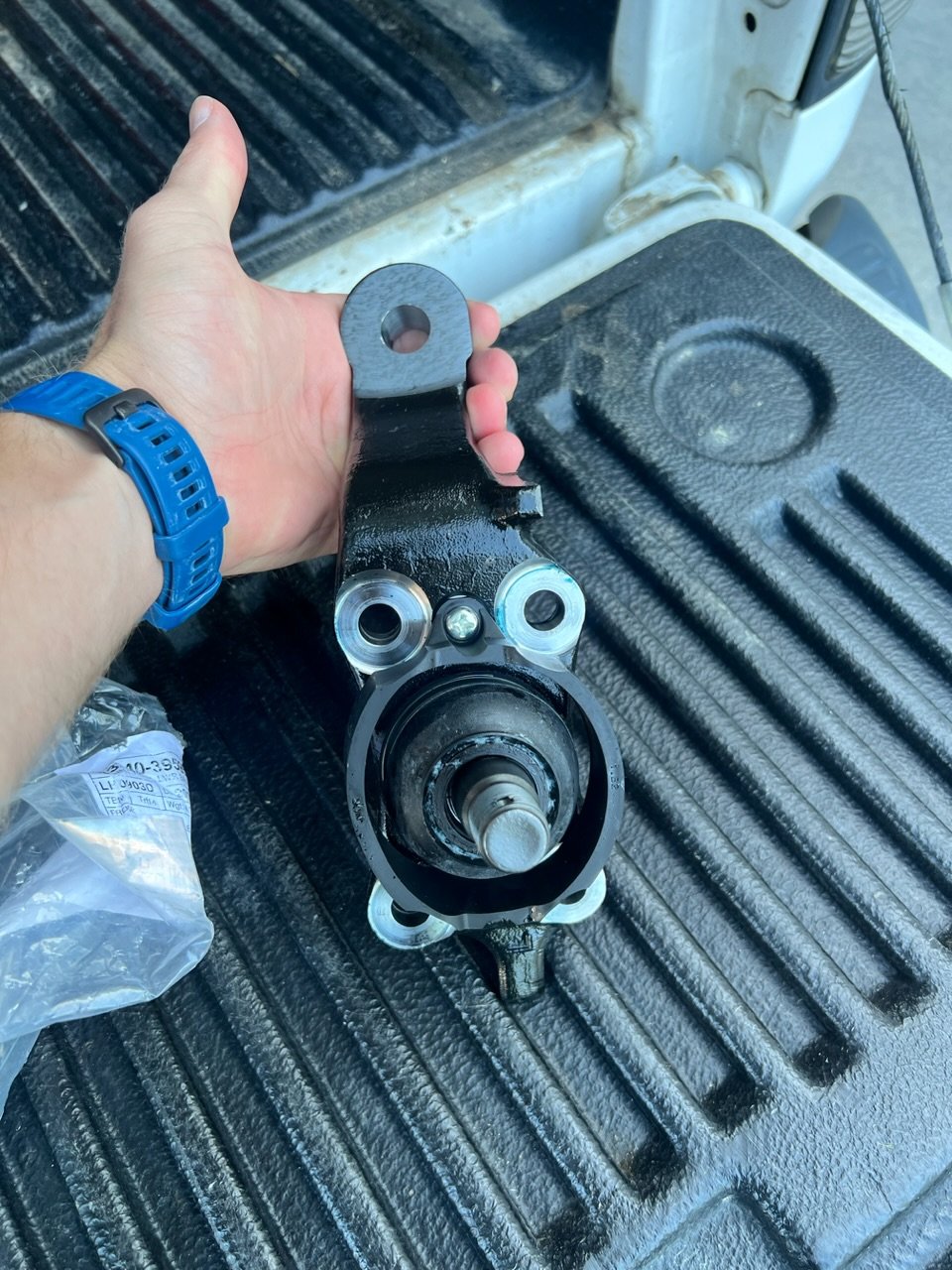

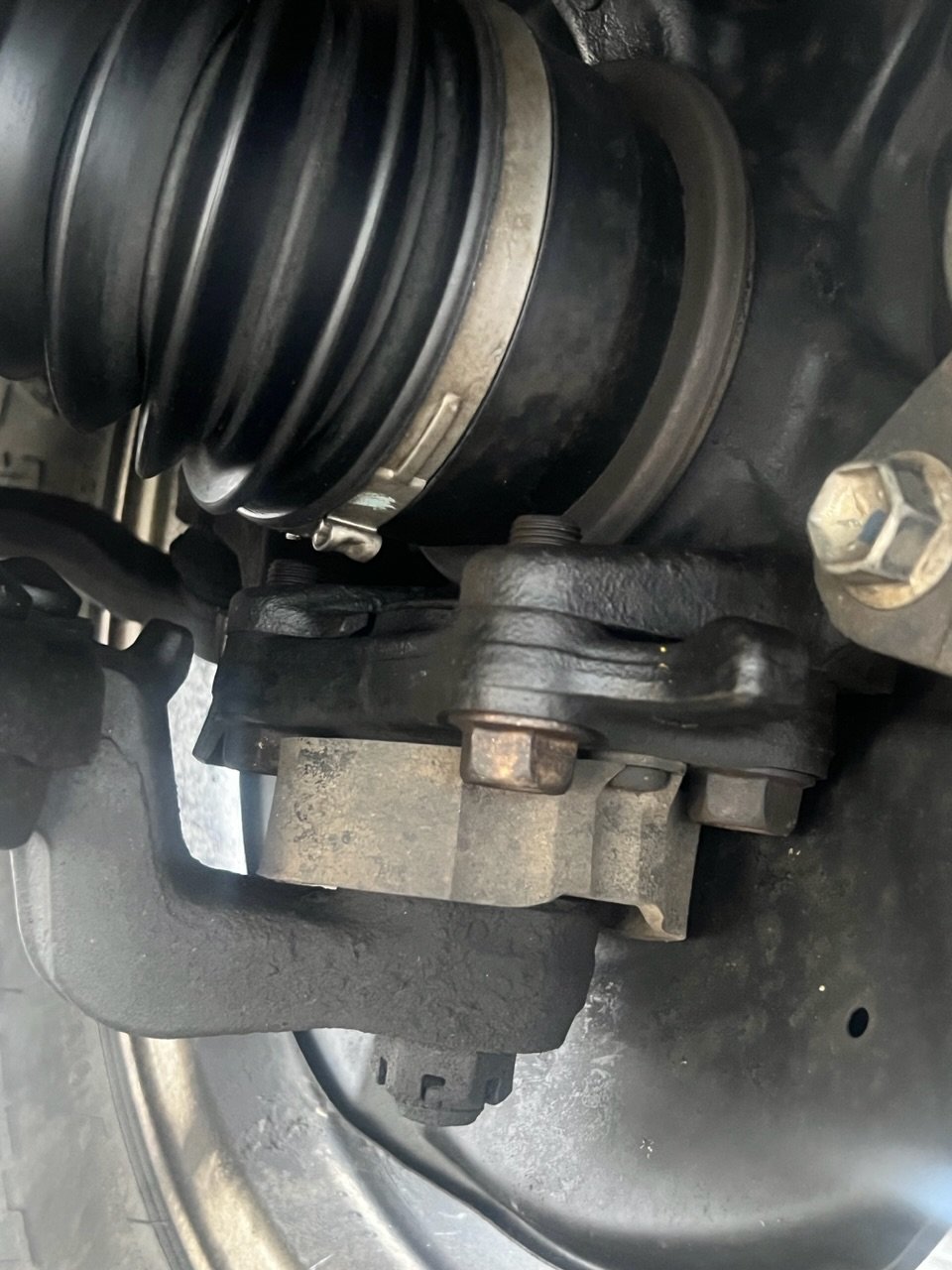

    So the manufacture date is 02/04. Here are some photos of what’s on the truck and what I received from the dealer.

  11. Jul 24, 2023 at 7:20 AM

    shifty`[QUOTED] likes this.

    Man, if you're replacing your UCA to compensate for the lift you're putting in, I hope your upper balljoints aren't as much of a bitch as mine. I could've done everything I needed to on each side in under 30 minutes. Spent probably 2.5 hours trying to get that bastard UBJ out.

    Wanting to keep the lift less than 2.5. Don’t currently plan on replacing the UCAs. I’ll cross that road if I need to.

    Those look to be the bigger joints to me. I was hoping someone else would chime in as I haven't even seen the 04-06 set in person before. In that case you'd need the 9010512316.
