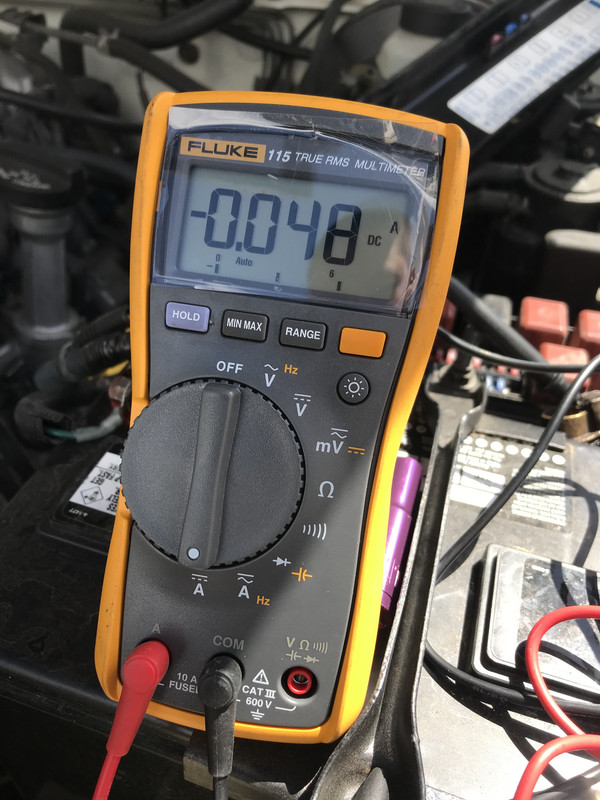

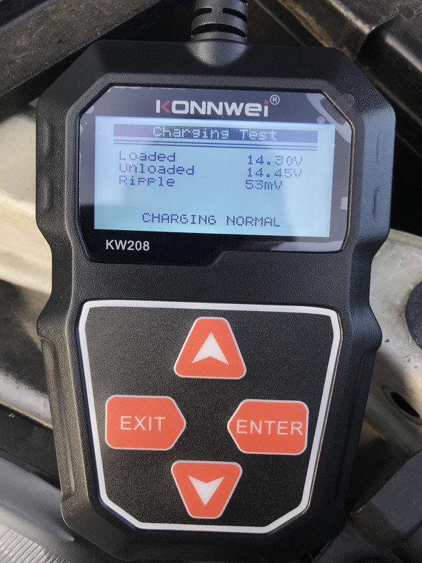

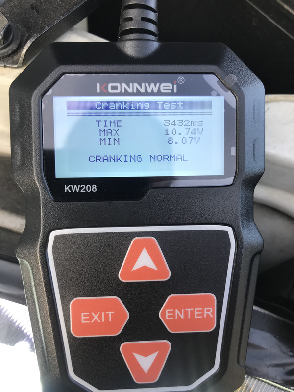

    No major updates. I’ve been battling a battery/charging issue for awhile now but hopefully got it narrowed down. I had a very small parasitic draw but I think it was just enough to kill the battery if I wasn’t driving it at least once a week. Battery and alternator have tested good multiple times on different testers. I even bought my own to check it randomly so I don’t have to drive to the parts store all the time. For $30, it works Damn good.
    Originally, had a draw of 0.048ma. After disconnecting the illuminated portion to my aux light rocker switches, it dropped to 0.035ma. They say anything below 0.050ma is within in spec. I think that little extra draw was enough to kill it over a weeks time. After driving it around for a bit, retested the battery and it was good with 690cca.
    Before:
    After:

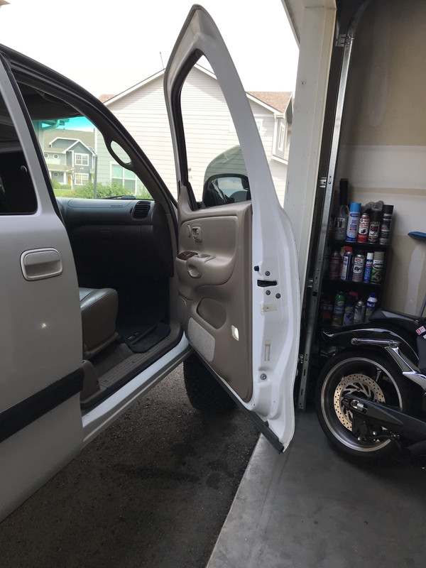

    Finally received my door check rebuild kit earlier this week and had some time today to put them. The TL;DR version, well worth it and they are SOLID. For the price, you can’t beat it. Highly recommended. Now my doors stay open at all positions and angles. I’m still getting used to it.
    Here is the kit and contents. Comes with (8) fixators, graphite lube, and shims/plates. Took just under two weeks to come in:
    My door checks were already out since I replaced them with units from a Camry but here is what my ‘spot welds’ looked liked. Someone at the factory got a little carried away and it was more welded than just a spot. I ended up having to drill out the weld and then use a dremel with a cut off wheel to open it from the side.
    Lots of banging/prying and the first one finally opened. Don’t worry about the metal bending as it can be reshaped back to its original form.
    Drivers side went together first. It’s hard to capture but my truck is at a pretty good angle sitting here and the door doesn’t move on the first notch or second notch.
    Passenger side. Notice the garage door
    frame vs the truck door.
    Looking at the old ones vs new, I figure the channel portion on each side is what wore out. It wasn’t till I looked at them for a different angle I realized what was wore. Old on the left, new on the right:
