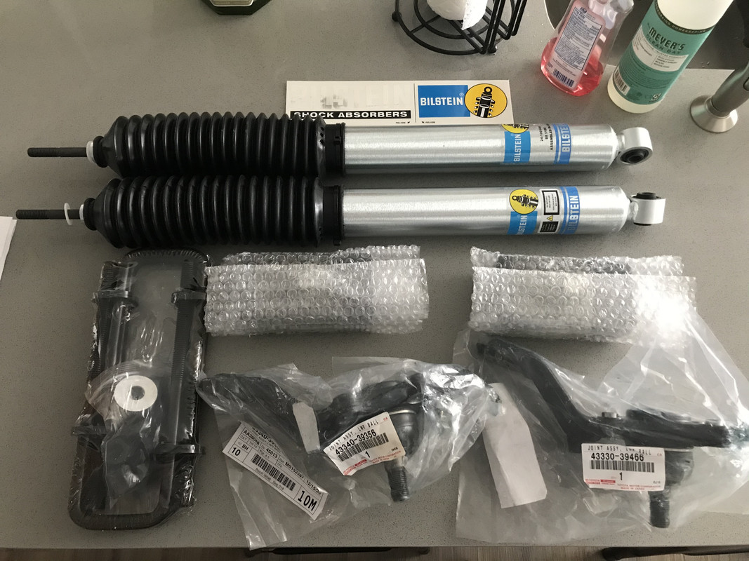

    Picked up the rest of the parts today and a few extras for NYE. I’ll stop by the local Wally World later this week for some gear oil and I’ll be set.
    I got some Altrom OEM/OEM style sway bar links. I’m not sure if I will use them or opt for the suspension maxx extended ones. Seems like the guys that run them but not sure if they are really worth the extra $100. Anyone have feedback on the suspension maxx ones if they are worth the extra coin?

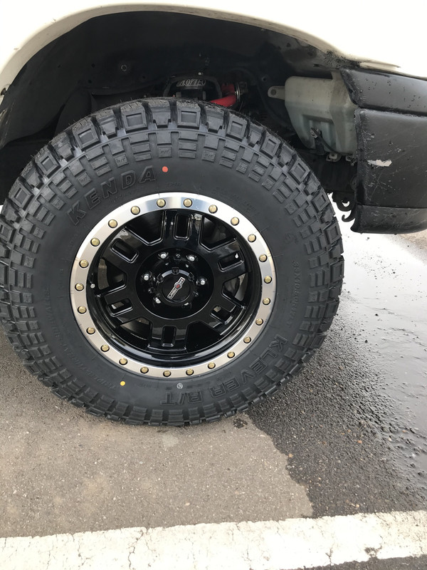

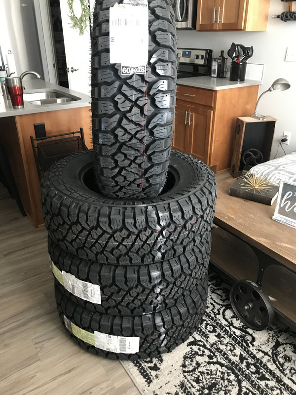

    Doorbell rang and these were sitting outside:
    They look even better in person. I always heard stories about buying ‘internet’ tires and them possibly being old, new stock. Date code puts these manufactured 10/2020. The wheels have an ETA of next Tuesday and hopefully that same weekend, I’ll get everything else put on.

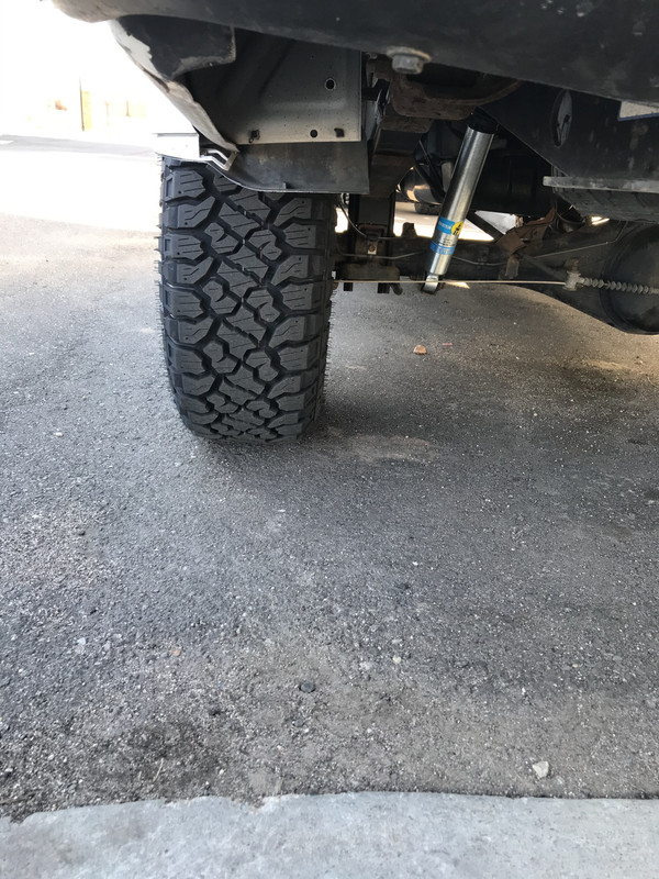

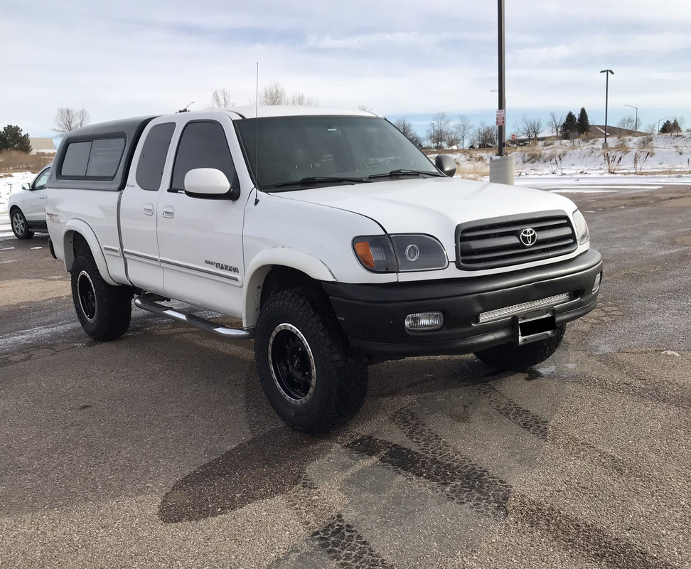

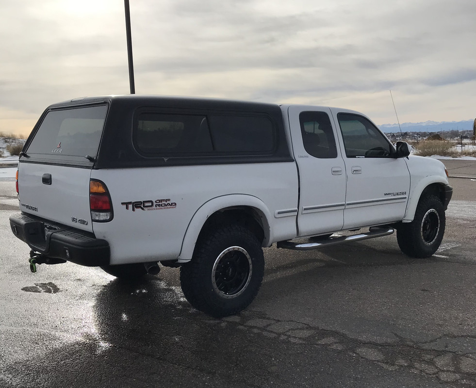

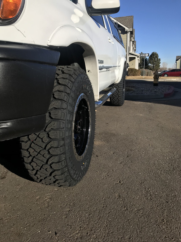

    Well it’s never done, but it’s come a long way. Finally got everything installed and got it aligned today. It drives so much better as you can imagine some of these parts were original with 188k on them. This is the final result:
    Comparison from stock with 265/75/16 to now:
    I have to say, I am blown away with these tires. For one, they took less weight to balance than my duratracs (-3oz per tire), they handle great and have far less road noise. I figured they would be at least as loud if not louder than the Goodyear’s. With this setup, there is zero rubbing anywhere. When I first bought this truck, this is exactly how I imagined it to look when I was done. I’ll snap a few more pics but you get the idea.

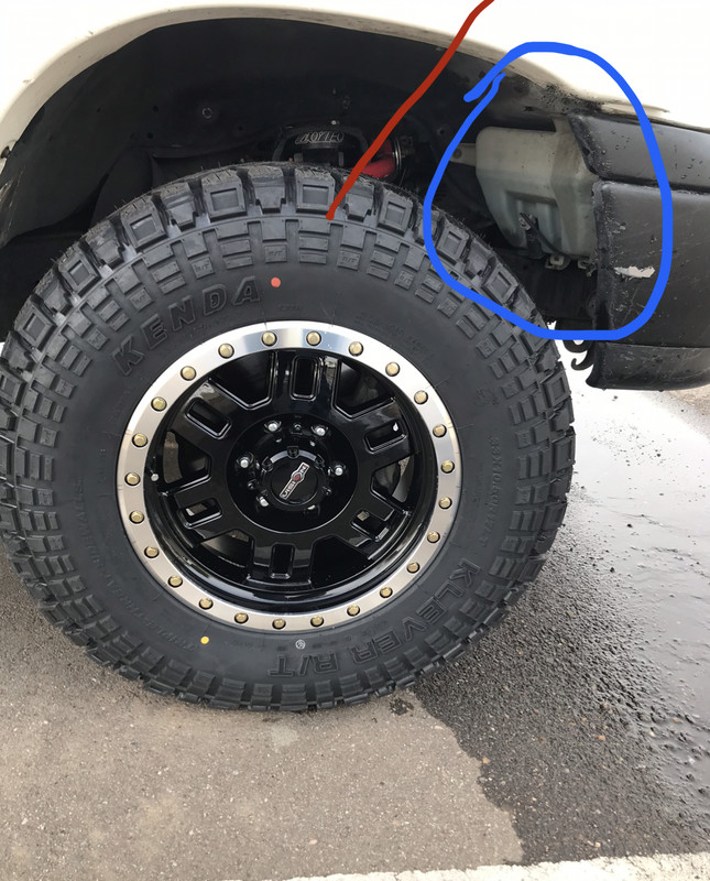

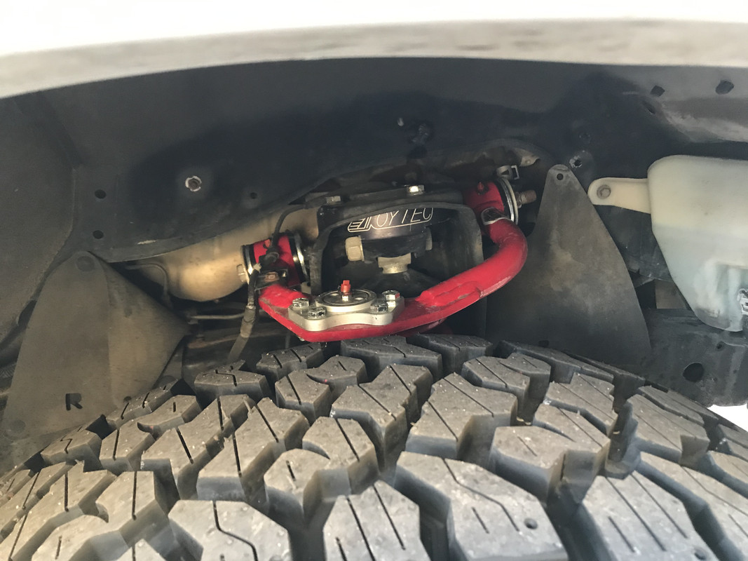

    I was looking at my suspension yesterday and realized half of my passenger wheel well liner is missing. It’s like it cracked and fell off somewhere. I found new ones on eBay for $30 shipped so those are on the way. I also noticed all the rubber flaps(?) were missing some clips and dangling. The driver side front one is also torn in half so I am going to attempt and make my own.
    Drivers side:
    Passenger side:
    Is there supposed to be a cover above the UCA as well?
  17. Feb 4, 2021 at 10:41 AM
    #107
    FirstGenVol
    Dec 13, 2018
    #22934
    14,355
    East TN
    2002 AC TRD 4x4 V8
    I don't think so.
    SouthPaw[QUOTED][OP] likes this.

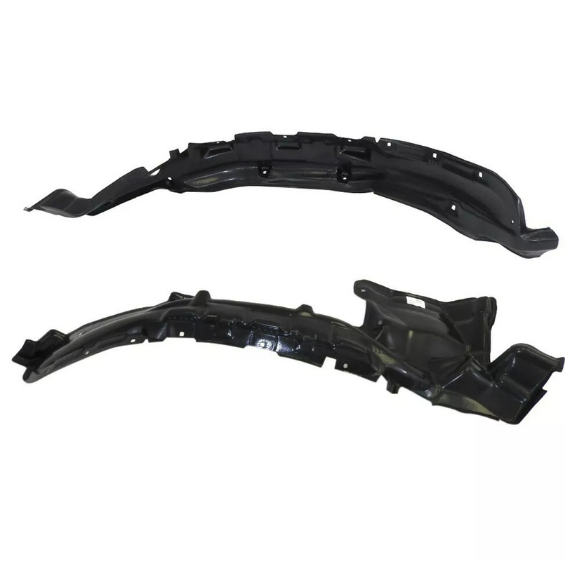

    New liners came in today. For $30 shipped for both fronts, I was pretty happy with the quality. They are really pliable (in a good way) which helped since they needed to be fit to my truck. Every one of old clips snapped when I removed the old liners. I have an assortment of automotive body clips and found some that fit nice and snug. The driver side was only missing some clips which were replaced but the passenger side was missing the entire front half of the liner. It was exposing the intake tube to all the elements for a true CAIo_O . Good thing I change the air filter every oil change...
    Broke off at the red line and missing the whole price circled in blue:
    FleaBay specials
    Back passenger side
    Front passenger side

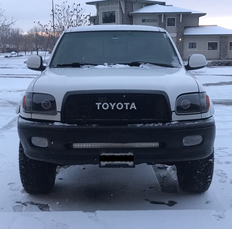

    Been a little absent lately but finally got a nice day to get the new grille installed. This grille is for a 2003-2006 Tundra and required a little modification to fit. The trim that runs order the grille has to be cut out for clearance and longer bolts need to be used to reach the latch handle now. Install was pretty straight forward other than all the original hardware was rusted and had to be cut out. The original grille had multiple broken tabs and the hood release handle broke off so it will need to be replaced. Total time was about two hours but it was totally worth it. Really updated the look and the FJ cruiser emblem completes it.
    This is the trim piece that needs the center cut out.
    I also got the front suspension leveled out. I didn’t notice it right away but one day I was looking at it and noticed the drivers side looked lower. Talking to ToyTec, they measure center of the hub to the fender flare to determine how much lift the springs are providing. Factory measures 20”. The drivers side measured 22” center of hub to flare and passenger side measured 22-3/4” lol. Of course, the driver side adjusting nut was seized and took quite a bit to free up. I pressure washed them off, soaked them in PB blaster and they still wouldn’t budge and I ended up busting the provided wrench trying to turn them. We ended having to take a torch to them and using some big channel locks and it finally started to spin. Adjusted them 1/2” up which provided 1” lift. Both sides measure 22-3/4” on both sides now, no more Toyota lean! I was still under the warranty period for my alignment and got it in today. The rear is still an inch higher but as funds allow, I’ll maybe remove the lift blocks and do an add-a-leaf in the summer.

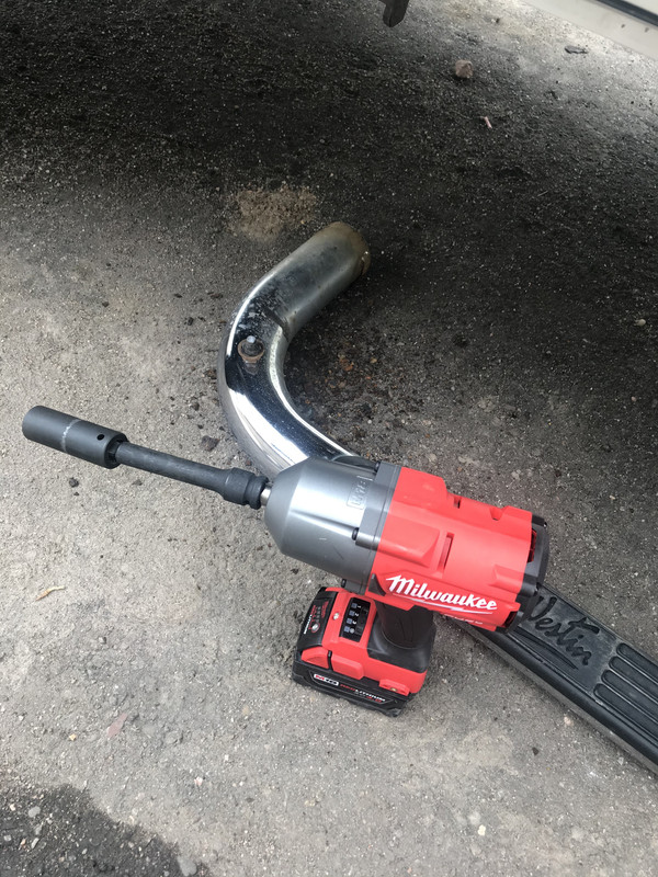

    Running boards are finally off!
