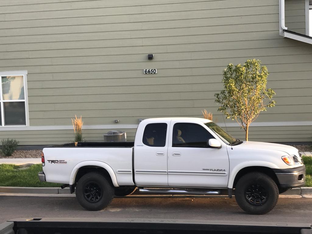

    Update - 04/23/20

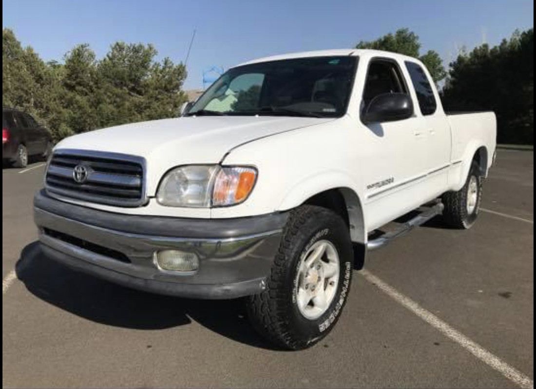

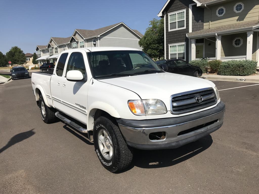

    Day that I brought it home:
    09/2019
    Details:
    2000 Toyota Tundra
    4.7L 4x4
    Bone stock
    172k on the clock
    After making a post here, first suggestion was to get all new fluid in everything along with a full service (oil, air and fuel filter). I drained the trans, tcase and rear diff. The front diff drain plug was already rounded but the all the fluid that came out of everything else was super clean. I did order a Allen bolt extractor and will probably remove it and drain in the next month or so. It also received a full detail inside and out. The seats had been covered in some direct fit seat covers for quite some time because after peeling them off, the original leather was in great condition! No rips, stains or any blemishes. I believe the seat covers had been on there since new.

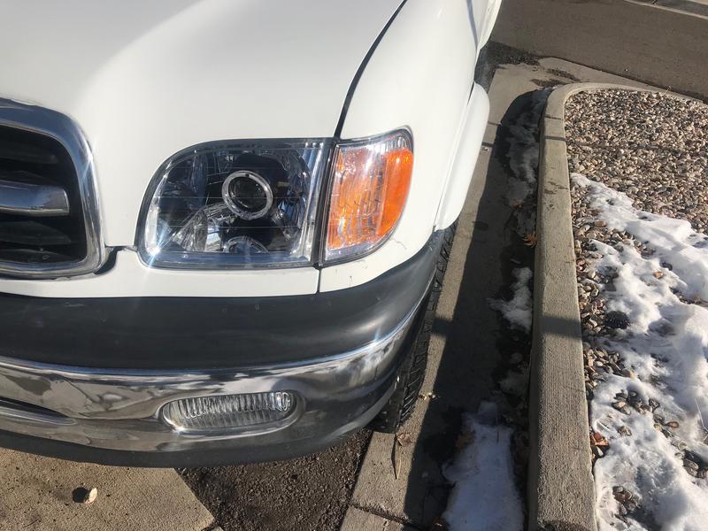

    The next step was replacing the missing/yellowing lights. Upon removing removing the fog lights, the old nuts were so rusty, they all snapped off.... every single one except for the top. I did spray them down the night before with PB blaster but it had no effect. This directed me to cut off the remainder of the stud, drill new holes and secure them with new bolts, washers, lock washers and nuts. Looking back, I could have saved myself so time with self tapping screws and not had to drill new holes but self tappers just look so cheesy to me.
    After looking at the exterior, one of the TRD logos was missing and the other severely weathered. The wheels were also in very poor shape. I found a set of decals on eBay and some new wheels from the friendly boys at Discount Tire. The wheels were on sale and in stock so it was a win win. The current tires are brand new all terrains that still had the chalk marks on them so I’m going to run them for now. I may change them out for some more aggressive tires like some Ridge Grapplers later.
    I knew right away to make this old girl acceptable by the old lady, it was going to need a backup camera. $60 on Amazon and some hard work, it now has one. The install of the radio wasn’t terrible but the dash bezel wasn’t as excepting of the double din. It required me to whittle out the bezel with my dremel to make it fit. I’m not sure if it was the radio that didn’t fit or the bezel was too small. Either way, it’s in there now and it works great.
    Next was integrating the factory key fobs. After researching that it did have the factory security system (RS3000), I opted to order the fobs online. Well after a bit more research and winter coming up, I made some calls about adding remote start. I called the local Car Toys and they quoted me $500! I was a bit shocked for an older vehicle and decided to call around. I called another local car toys type of place and they guy actually had a 2002 Sequioa 4.7L and began telling me how easy it was to install on these trucks. $250 out the door for a viper 4105v remote/alarm with a lifetime warranty, SOLD! It goes in next week.

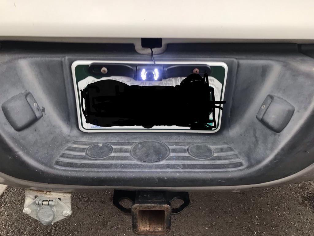

    If you are looking for a good bang-buck project. Might I suggest getting your camera installed in your tailgate latch handle recess. I love mine

    I like that idea! Just afraid someone not paying attention opening my tailgate would rip it off lol.

    Which camera did you go with? I bought one off Amazon and the image is flipped. I can't find any setting on the head unit to rotate the image... Might need the camera you have to pull this mod off
  11. Sep 27, 2019 at 5:28 PM
    KarmaKannon
    KarmaKannon Master of None
    Jun 3, 2019
    #31428
    1,919
    Utah
    2006 Double Cab w/long travel
    Some junk
    https://www.amazon.com/Downside-COOLINT-Multifunction-Switchers-Design-Black/dp/B016I91IK2
    That's the one I used. This one can be flipped by cutting an extra wire that I think was green.

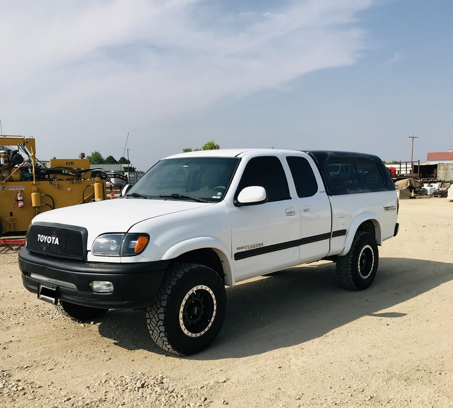

    I got tired of people asking me if it was a V6 so I decided to slap a new exhaust on it. I decided on an Aero Turbine AT2525. I’ve used Aero’s on all my previous trucks and they have all sounded nice. Nice low rumble at idle, pretty quiet while cruising but a nice bark when you open it up. It does have a slight drone around 60mph/2KRPM but it’s not terrible. This truck is a lot smaller than the others I put Aero’s on so I’m assuming it’s because I’m closer to the muffler. I also threw a cheap black tip on from Amazon and it looks pretty damn good.

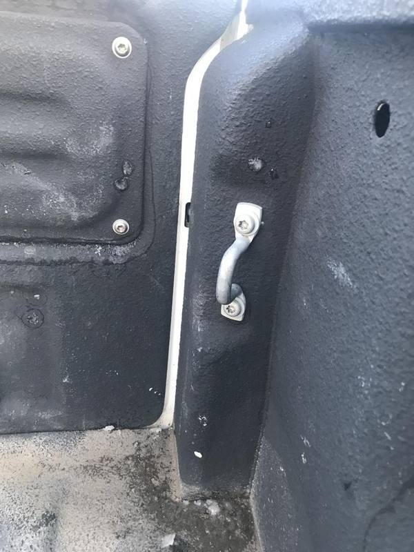

    Scored on a few things off craigslist today. New battery strap and bed anchors for $15. I was just about to order some online for $40, without the bolts.

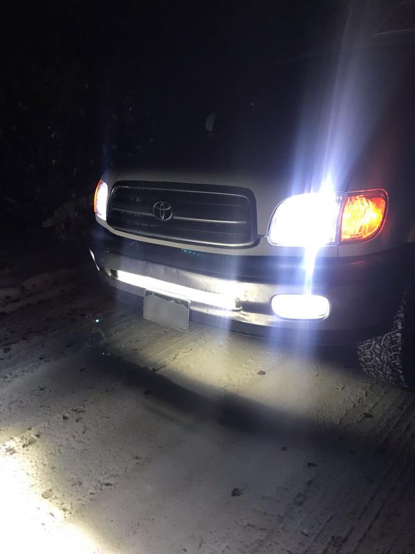

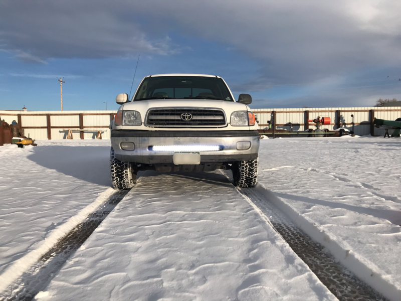

    Finally got everything done. One weekend did the rear lights, next weekend the front light bar and inverter. I’m really glad I bought the fuse block as it was much needed. I could have gotten things done a lot quicker but I wanted to make sure all the wires were tucked away and were wrapped in loom. I also made some custom brackets for the front light bar so I didn’t have to drill into anything.
    Here is the switch panel mounted. It fit perfect right here and required very little fitting behind the kick panel.

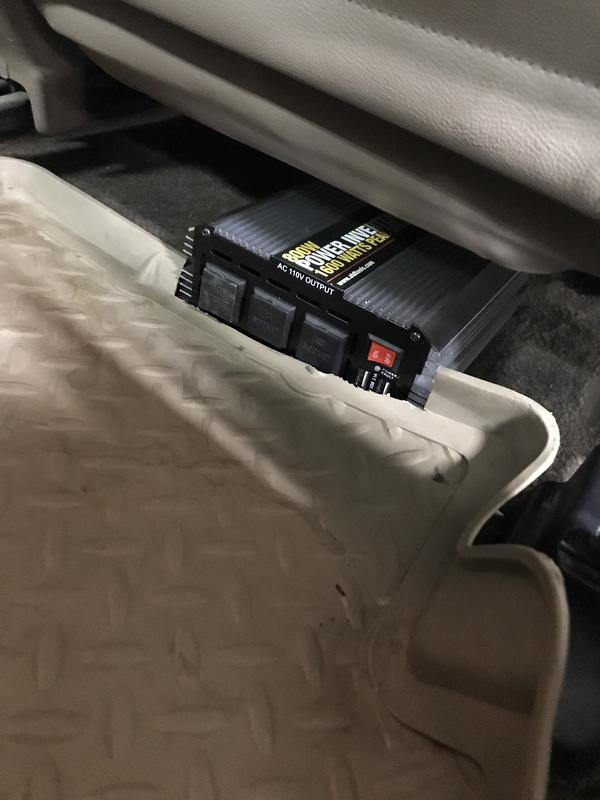

    Also got the inverter mounted under the passenger seat. Super easy to do and I highly recommend it. I was able to get an inverter for free from work since I’m mobile a lot and need a way to charge my laptop.
    I had to modify the floor mat a bit with a razor but it fits well.

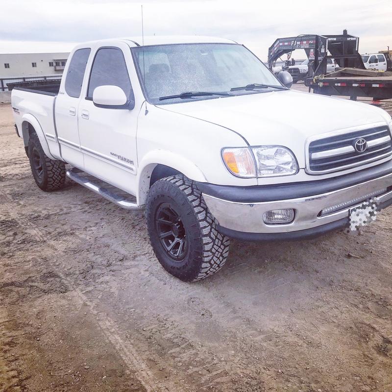

    She got some ‘new’ skins today. Found a great deal on a like new set of LT265/75/16 Goodyear Duratracs. The duratracs were the last tires on my list and I was actually going to pick up a set of Falken Wildpeak’s until these popped up. The price was right so I jumped on them. They are a little louder than Pathfinder AT’s I had but it was expected. They rub a little more too so I might need to do some trimming. I think they look great and give the truck a whole new look.

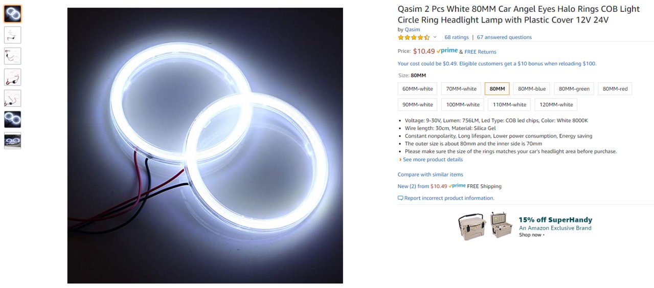

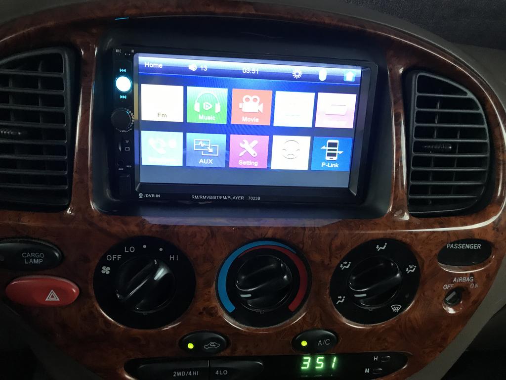

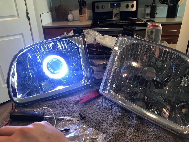

    I'm probably going to regret this but I am going to attempt to retrofit my Tundra with some mini H1 projectors. @KarmaKannon just made it look so dang easy! The only thing I am doing different is adding some halos so I can make it easier to see when it's remote started. As of now, the parking lights turn on when it's running but in the daytime, it's really hard to see. Hopefully the halos don't look too cheesy. I ordered two 'kits' and will be returning one if the halo does not fit the Ni-light kit. I am actually hopefully as the last retro fit I did (2015 Silverado 1500 LTZ) was a total PITA. I did not separate the lens from the housing but snuck it in through the back which was extremely difficult. I am hoping since these headlights are easy to take on/off, this should go pretty smooth. I already have the HID kit so I ordered new bulbs. I'll do my best to document on how to do it but another member posted a pretty good write up already.
    Darkness, imDementeD and KarmaKannon like this.
  26. Jan 2, 2020 at 1:17 PM
    #26
    SouthPaw
    SouthPaw [OP] The headlight guy
    Sep 11, 2019
    #35992
    1,284
    2000 Limited 4x4 AC
    Well -

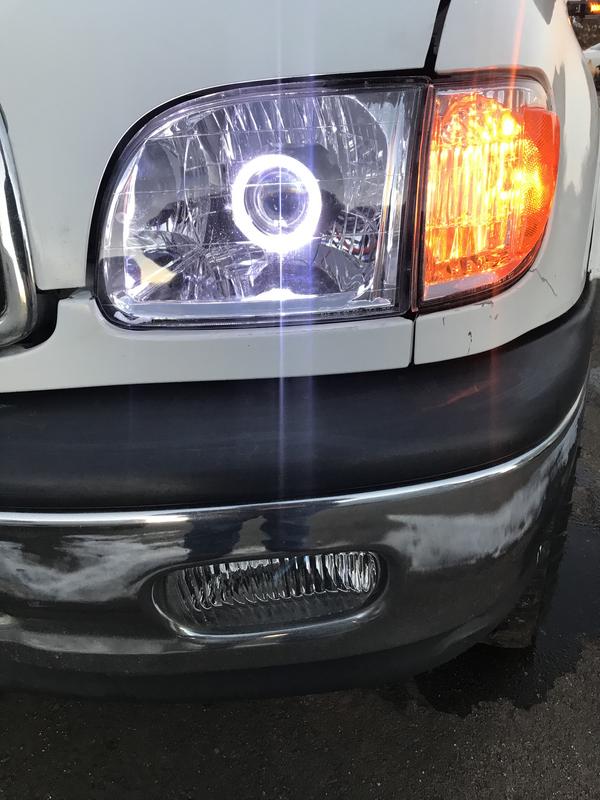

    Got them in yesterday. For the most part, it was a smooth install. I did a few extra things which took a little more time to complete but worth it in the end. I ended using the brand with the built in halos. They seem to be great quality and the cutoff line was pretty good. When comparing the halos side by side, the halos were 100x brighter the others ones I purchased. This is a picture of them side by side with them both being powered:
    Setup my work station:
    The YUFANYA kit came with everything that was needed and the halos snap into the shroud they provide. They don't quite sit flush so I got them all even and tightened down the screws. I also painted the black since I hate chrome (sponsored by Modelo)
    Pretty much followed the instructions here and modified a few things along the way (https://www.tundras.com/threads/how...ofit-w-mini-h1-7-0-bi-xenon-projectors.41187/). This was an excellent post.
    One thing I didn't notice in the How-To thread was it didn't mention about putting the lens back together. I lined the housing with butyl tape and put them back in the over for 10min@225* to pushed them back together. It works great.
    Here is the finished product.
    I did have one major screw up on the install for the halos. When they were shipped, there was a tiny black box connected to them that had two wires to the halos (+/-) and three wires coming out the other end (red+/black-/white+). I ASSUMED that the black box was only to run the white wire and not needed so I took it off. Well the halos ran fine on the bench every time I tested them and they ran fine when I put them on the truck and powered them via the park lights. After a few test drives, they died. Speaking to the supplier, they said the black box is the driver and has to be used otherwise it will kill them. So I killed them after I sealed up the headlight :annoyed:. Lesson learned and I have the replacements on their way. I think this time around, I should be able to get it done pretty quick since I know what I am doing. Overall, I think the upgrade is defeintely worth it as long as you don't make the mistake I did. The light output is so much better and it actually is usable. I will be the first to admit, the HID's in the stock housing SUCKED! This is really worth it.

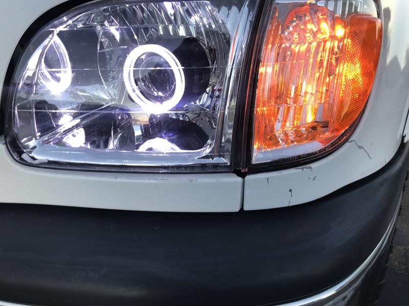

    Got the new halos in today and this time around, it went a lot smoother. Anyways, I’m pretty happy the way they turned out.
