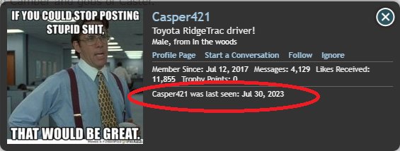

    Casper is sorely missed. Haven't seen him posting for the better part of a year now.
