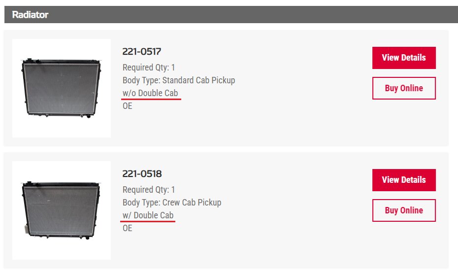

    Maybe I should just ask here.....I've seen videos online about getting the radiator replaced. Where to go to buy a new radiator? Does the transmission cooler come with it?
    *I've seen at least one video talk of the Tundra's radiator leaking coolant into the transmission....is that a thing?

    Denso. Rock Auto or any parts store that carries Denso. No, the transmission cooler doesn't come with it, you just reuse your old one unless you think it needs to be replaced for some reason.
    Yes, it's a thing. It's why many here recommend proactively replacing an old radiator.

    Yes, "pink milkshake" is a thing and gets touched on in the 1st reply of this thread. It's possible they fixed the radiator design at some point, because it seems like not all radiators have the shit fittings that separated.
    RockAuto has been pretty good to members as far as getting radiators to them undamaged. I've had great experiences with Summit Racing too. But don't rely on their website to get you right. Always go to www.densoautoparts.com to look up your part number, then search those sites for the part number you need. With radiators, be careful to read their instructions. They'll typically have notes "with double cab" or "w/o double cab". The radiator size is different, one is taller. If you have a double cab - i.e. a 4door truck where all four doors open normally, not the 4 door where the rear doors open backwards - then order the correct radiator for "with double cab". This is only an example - look up your own part number at that website I linked!

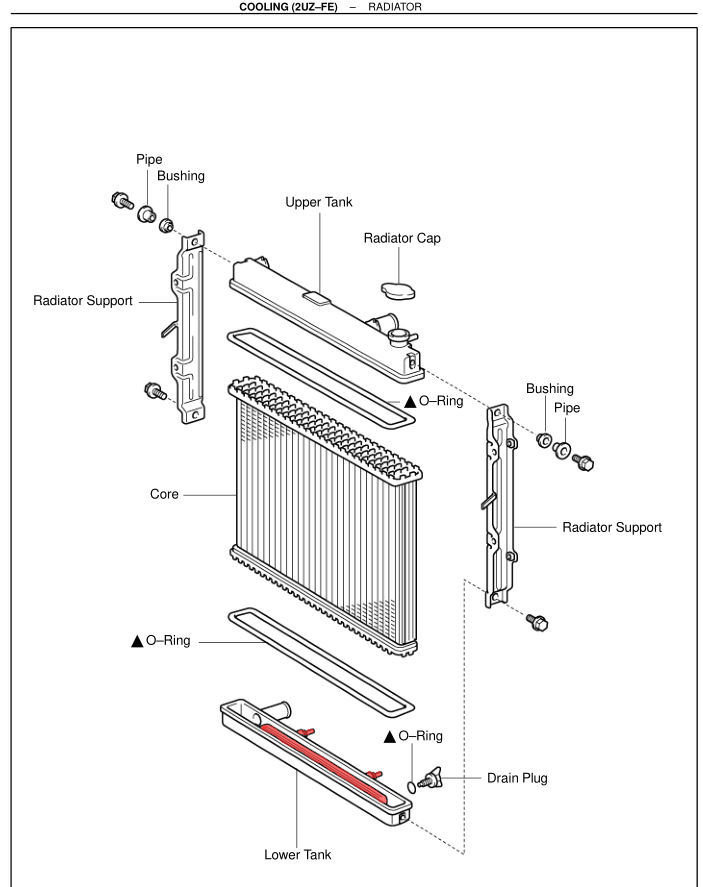

    Iron oxide weight reduction
    Its a "warmer", inside the base.

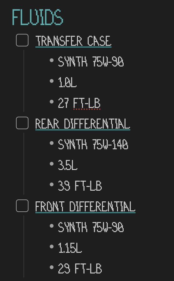

    Went back and double checked the manual, does this look right? Should I just use 75W-140 on both diffs? Planning to use 75W-90 on transfer.
    I'm in northern New Hampshire. Things get cold here, but p much the same as back from Buffalo NY, and I don't drive a whole, tow even less than that, lot so I'm not gonna stress this too much. Just want to make sure I have it right so I can unflinchingly trust my notes here forward

    75W90 in all diffs and transfer case. If no LSD, then synthetic is fine.
    edit: 75W140 is good for rear diff w/non-LSD. I’ve always run 75W90 in mine.
