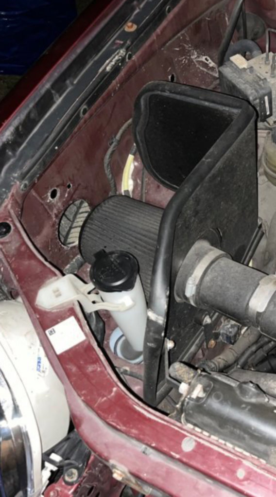

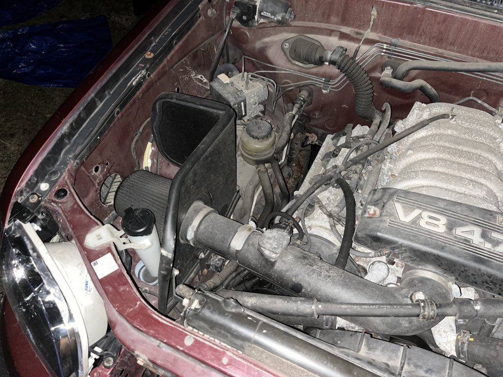

    -Fuel injectors (dirty deeds) -Cold (hot?) air intake -Long tube jab headers -Down pipe, American thunder exhaust -Tow package -Blow and go
    Bro please give us an update.. I’ve got a similar set up so far on my 2004 tundra.
    - k&n “hot” air intake
    - jba long tube headers
    - down pipe & American thunder flow master exhaust
    - fuel injectors from @dirtydeeds
    been thinking about throwing a turbo or super charger on it for a couple years now and would love to hear what you went with on your truck build

    Which one? The stock airbox is technically a cold air intake. Many of the aftermarket units are a hot air intake, and some even result in power loss.

    Ah, yep, you have a hot air intake. Thats the style associated with power loss in our trucks. You’ll get more power if you reinstall the OEM air box. See that hole in front of the filter cone? That’s where the OEM air box pulls true Cold air from. The current setup you have pulls hot air mixture from the engine bay. Not good.

    Who said the OEM airbox gives bad performance? If you use it with the OEM Toyota filters, which flow less restrictively than aftermarket filters, you’ll get better performance throughout the full power band than what you’ve got in there. Did you do any research before you replace the OEM airbox? There’s dynotesting data out there from normal 3rd parties. Have you read the community megathread yet?
    And if that’s an oiled filter, you’re doing your throttlebody a disservice dude. You know about boiled filters and the added shit they allow to collect, right?

    Ok yea I will have to do some research but I’ll see if I can find my OEM filter to throw back in there for the time being.
    just finished reading the mega thread, I actually wandered over to it right after my last input on the thread I chuckled to myself when the first thing I saw after reading it was your comment mentioning exactly what I just read aha
    I’m not really sure what kind of filter the k&n I’ve got in there right now is, I got it probably four years ago when I first got the truck and I’m not the most mechanically inclined guy (cue the “hot air” intake purchase) but I’m trying to learn more about it all and educate myself as I go.
    I’ve been looking at this web page since probably not long after I got my truck four years ago but finally just made a username today so I can figure stuff out and ask questions and stuff aha
    thanks for the tips man

    You know, you will benefit from the smoother intake pathway of the K&N. You can adapt the intake tube to attach to the stock airbox and get the best of both worlds…
    I’m intending to do similar in the future to help reduce clutter, will probably do it when I start to overhaul all the vacuum hoses in the engine bay with new rubber.

    And here’s a pic of what that looks like on a 2UZ-FE in a land cruiser, how much cleanup in the bay to expect.
