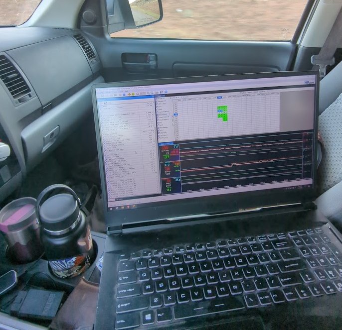

    281,700 mile update. This is mainly to log tuning notes. I installed Prospeed "750cc" injectors (really 715cc) on November 26th. Those details can be found here: https://www.tundras.com/threads/general-supercharger-thread.85513/page-146#post-2993868 Not a fan of the Prospeed injectors.
    Prior to the injectors I had really bad knock at ~2500ft elevation (I live at 5500ft). The TRD Green 535cc injectors were 100% maxed out even at higher elevation, and no doubt contributing to the knock at lower elevation which is why I got the 715s. Since the bad knocking, I had had the truck at lower elevation a number of times but just avoided WOT. Two days ago we went down the hill and didn't have a lot of plans so grabbed the laptop to see if I could dial the truck in down there. The knock retard on my first run looked like this:
    This was still using the timing map that Viktor had given me (last year?) and was fine before I increased the boost. During this run the max boost I saw was 10.7psia, which means the supercharger itself was making upwards of 12psi and after compensating for the altitude pressure loss was providing 10.7psi beyond what a sea level engine would make. Obviously there is a lot of knock happening at 5200rpm, but otherwise it doesn't look too bad, and was nowhere near as bad as the small injectors. I had already dialed in the large injectors a bit, and was targeting an AFR of 10.5. I then modified the timing base map and high octane map, not drastically but there were a couple areas that could get smoothed out and I dropped the timing 1 or 2 degrees around the 5200rpm range. I also was seeing the AFR fluctuate a bit leaner than I wanted, which is normal, the AFR isn't locked in and is very dynamic, but I wanted 10.5 to be the worst case level of lean at WOT so I richened the truck out a bit more to 10.2. This is the limit of the 715cc injectors, I am at 95% duty cycle but this is only at lower elevation, at home I'm around 80% which is perfect. After those tweaking the data log looked like this:
    Much better! I'm not sure what a bad level of knocking is, but -3.0 is nominal operation and anything lower is bad. In my mind these numbers are all relatively low, so the truck is retarding for knock a little but nothing drastic. My next issue was hitting the rev limiter through most gear shifts. I had this issue in my 2-3 shift before and fixed that, but was now happening through most of the other shifts. The truck seems to have the rpms increase so fast it can't anticipate and shift fast enough, so the tuning solution is to decrease the shift rpm so it doesn't hit the limiter. I dropped all shift points at WOT by 5%, and that was perfect and the truck didn't hit the limiter anymore and shifted around 6000rpm!
    I did one timed 0-60 run once that was all looking good, and this was the quick data log and dragy run:
    The data log was really fast, so not sure how much can be gleaned from it, but the truck seemed very happy with the changes. It also did the fastest 0-60 by far, at 4.58 or 4.37 (depending which number you compare). I only did the one run since I had spent the last hour doing WOT runs and wanted to let it rest, but I am extremely happy with how it's performing. I can now drive down the hill and not worry about knocking and can use all the power on tap safely; I may have lost a little power at higher elevation but I suspect it's minimal since I didn't change the timing by much (and mostly over 5000rpm).

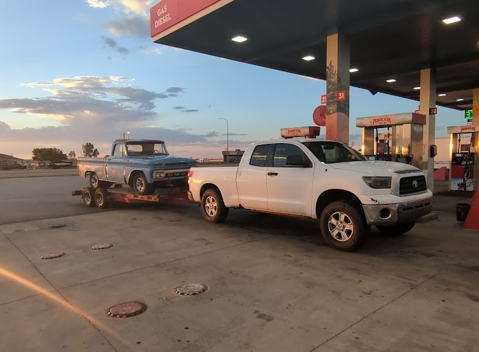

    I had some work stuff on the far side of the state, and my buddy bought a truck in Salt Lake City so I said I could pick it up for him. I towed my trailer up (and got to have fun with it blowing a tire), dropped the trailer off, then picked it up on the return south and then got the truck.
    On the way up the Tundra got like 10mpg with the empty flat bed which weighs like 2500lbs and doing 87mph. Unloaded it got 12.7mpg. On the way back got 7.4mpg at 78mph.
    I even datalogged a bit on the way down just to see what the truck would do running 4-5psi for an extended period on hills since I can't monitor knock feedback with Torque Pro.
    The truck did great for MOST of the drive. Had cruise control set in 5th gear, an occasional hill steep enough I'd pop it out of cruise and let it slow down. But she seemed happy chugging at 4psi and maintaining speed up hills. In typical fashion if it's in boost for an extended time (multiple minutes) the engine temps will climb a bit and that's it. The truck is extremely consistent of peaking at 203deg normally, and in boost might go to like 208. Trans was locked in at 190-200deg (thermostat is pinned open, and tune is set to lockup the converter in 4/5/6 always).
    The LAST hill is when something seemed to go wrong. Another hill where the truck hit 5psi or so for a moment or two, but was otherwise fine. Engine temp climbed up a bit, but crested the hill and was home free on the flats the rest of the way. But the engine temp didn't drop. It was at 208 or so, and then climbed to 212 and then locked in there. For the next 30 minutes or so all the way home I experimented trying to figure out what was going on. The engine temp would drop only if the rpm dropped, so upshifting to 6th it would drop a bit with cruise control still on at 78mph. If I slowed down more it would drop more. If I slowed down and downshifted and was on the throttle a bit, the temp would climb. So the temperature was definitely influenced by the rpm, which usually it's the other way of revving the engine up and pumping more coolant tends to cool it down faster (assuming low load). Even once I got off the interstate, doing 55mph the engine temp would climb right back to 212 (saw 214 for one instant) if I was driving in a low gear. So low gear, revved out to 3-4k but essentially just idling along and temps would go to 212 and just hold there.

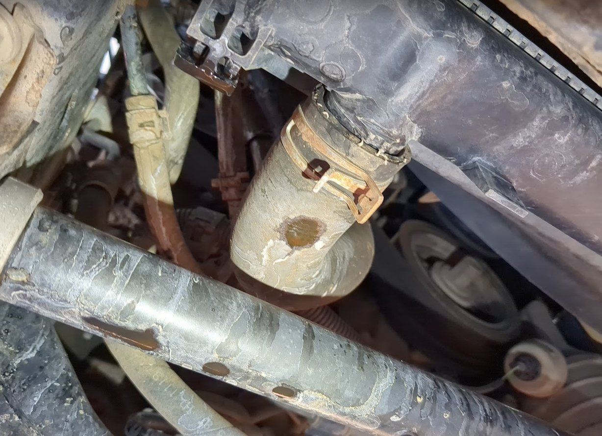

    And on any of my other vehicles this wouldn't remotely be a concern. The Hilux, the buggy, their temps fluctuate all over the place and when working hard will hit 212 all day. 212 isn't that hot for coolant, and if you're not actively monitoring the exact temperature you wouldn't even know anything was wrong. No hiccups, such a small temp change the gauge isn't registering it (even a good analog gauge probably wouldn't pick it up), but the Tundra is so consistent that I know something is up with it. The whole trip and it's solid and repeatable, and it was in 100+ degree weather earlier in the day with the trailer. But the last flat land at night and all of a sudden the temperature baseline has moved from 203 to 212. Such a small change, but big implications.
    Crawling around it a little this morning, the biggest clue is there is coolant (and lots of stains from coolant it appears) on the lower radiator hose and fan shroud. I'm not entirely sure where these are coming from, but I would bet is the issue.
    A few years ago I had the radiator develop a crack and had similar results then too. I don't know if this is the radiator again or something else. But I suspect it's bleeding pressure and that's what's making the temperature rise, and is so small that's why the coolant level isn't dropping very fast. At one point I had the serpentine belt kissing the lower radiator hose and causing a tiny pin hole that was spewing coolant, maybe that same thing has happened again?
    Won't be until next week that I can really look into this. Will probably tow the truck to my friend's house an hour away, get some more miles on the Tundra and see if that helps reveal where the issue is coming from. All in all, I can't complain too much. The truck just did 650 miles the last two days, 200 towing an empty trailer, 200 towing a truck. The thing is an absolute animal.
