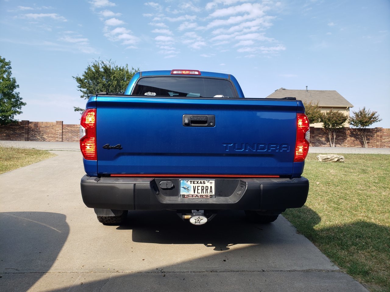

    Seems I skipped over doing the HotTails mod. I did Option A, (reverse switch back to amber blinker) and absolutely love it. So much brighter and makes me more visible, I'm often driving late at night when other folks are not at their most attentive, so this gives me some added peace of mind that I'm making myself more visible and making it clearer that I'm turning or stopping. I can definitely see the vehicles behind me in a glow of red but I've yet to see anyone shield their eyes. With the tailgate lightbar, I'm definitely doing some overkill but I'm happy and have yet to be rear ended :rofl:
    I had looked at aftermarket tails but really didn't like most options, I have no issues with the stock ones so this was a great alternative for me.
    https://www.tundras.com/threads/tundra-total-taillight-kits-hotshot-offroad.96590/

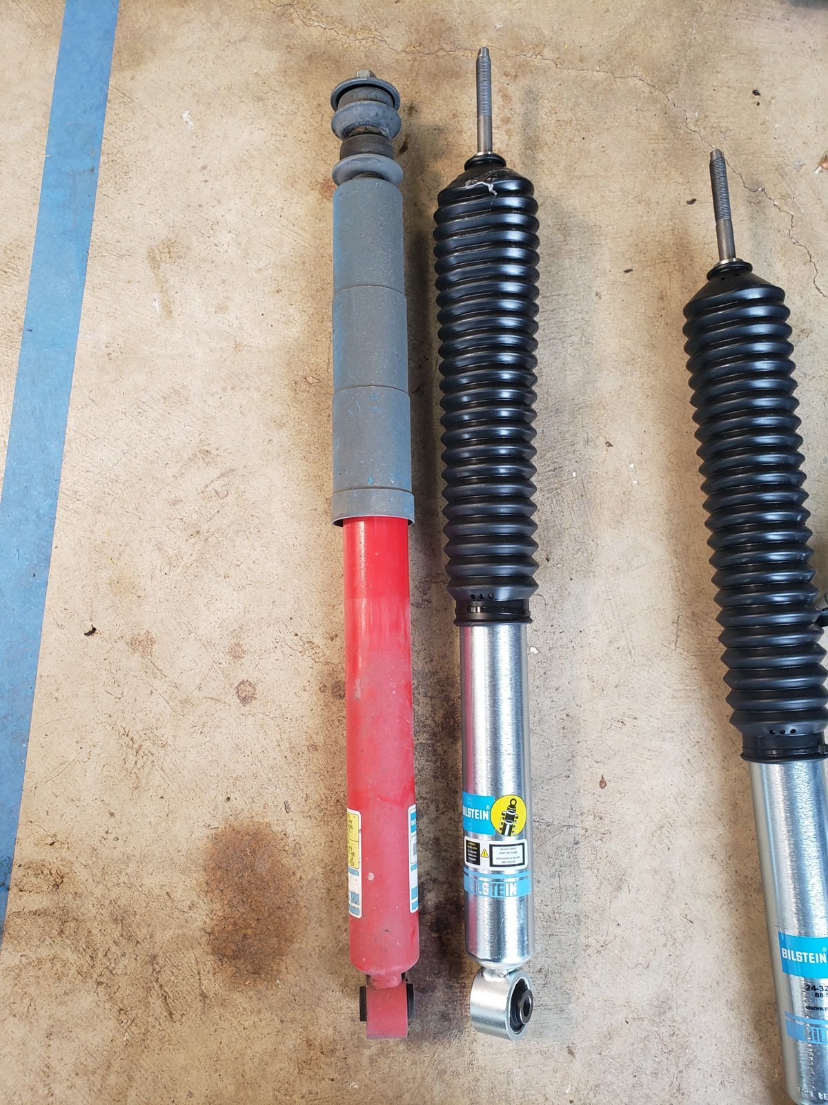

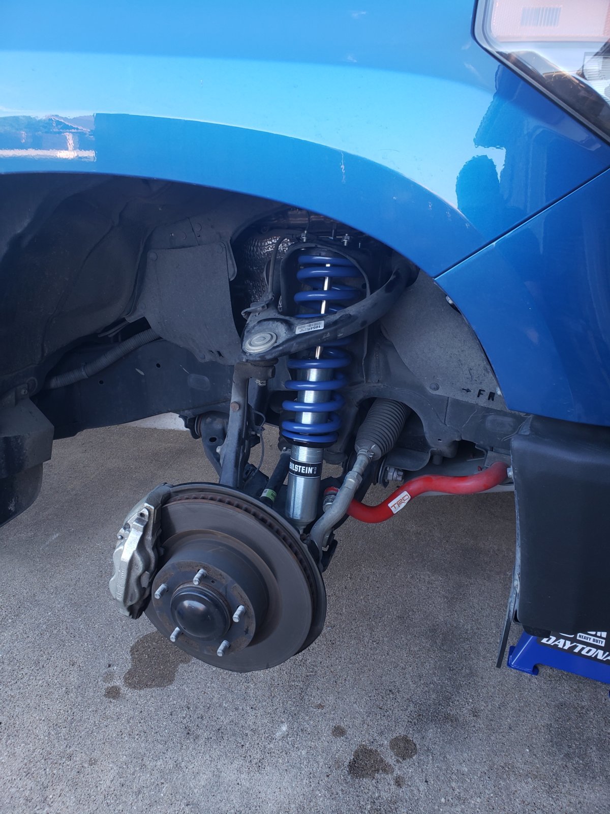

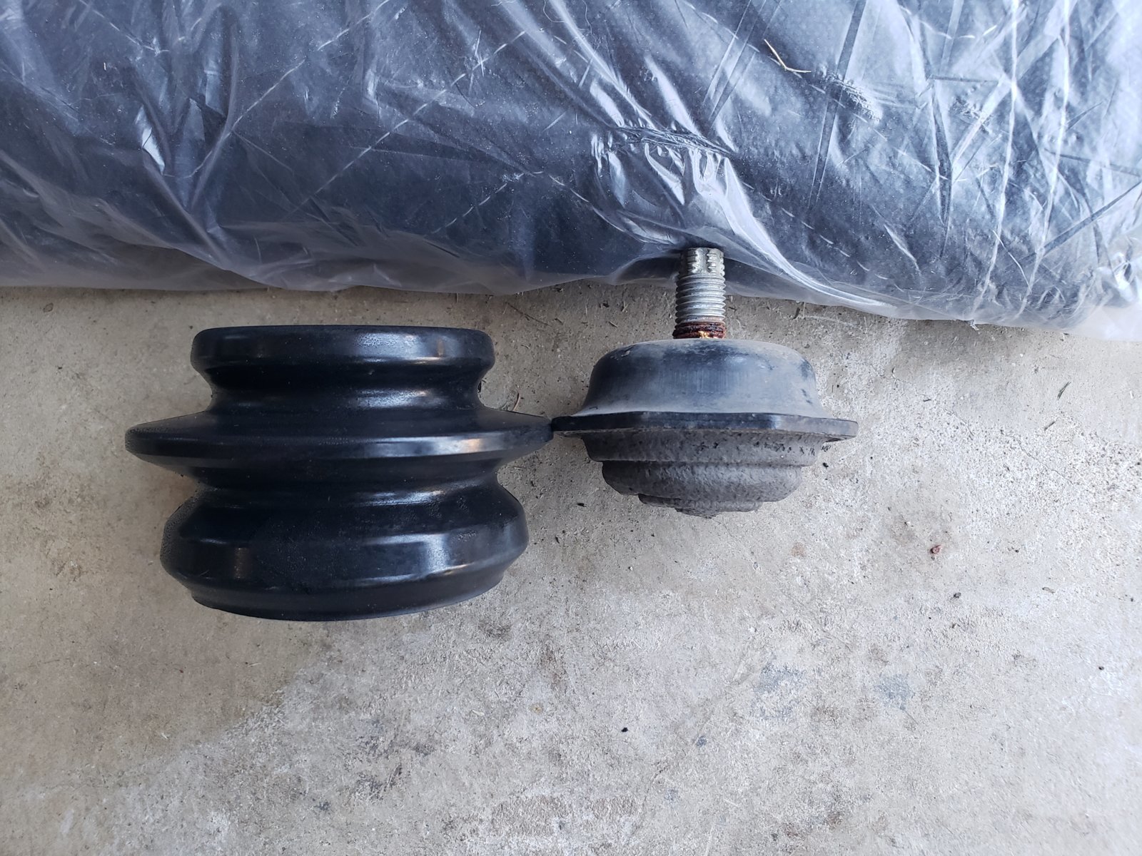

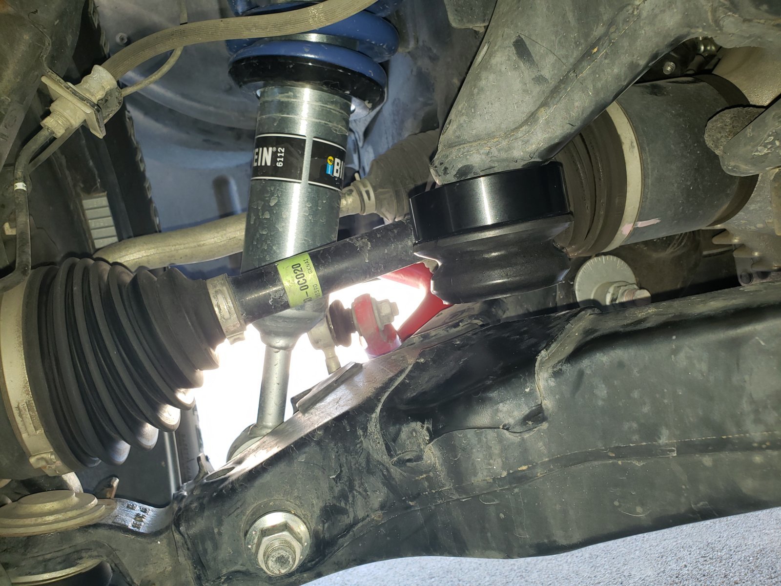

    Before 2023 wrapped up. I got my upgraded suspension put on. Nothing crazy but the stiff ride of the TRD Sport shocks was not as enjoyable for the wife, so this was to appease her :D
    6112 up front at the 3rd setting with a cb shim on driver side to account for lean. 5100 in the rear. Also picked up some Icon bump stops for the front, they were cheaper than Durobumps or Superbumps but honestly I should have just bought one of those 2 since these foam Icon ones will likely wear out. But she is going to be a pavement princess commuter for 2024 so I'm not too worried.
    Again, a shout out to @memario1214 for working with me and powder coating the coils.

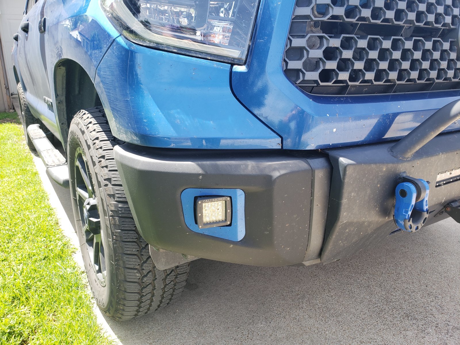

    Just an update. The truck is being driven a lot at the moment and my diy paint job on the bulge and surround has taken some rock chips. The paint isn't peeling, thankfully, but every month its gained some more spots where the chrome is visible *sigh* I have a spare set I plan to paint differently but time is an issue and last time I borrowed my neighbors air compressor and he has since moved. Trying to find a compressor that fits my needs and budget.
    Bumper caps are holding up really well. I don't see any damage to them and they don't seem to have faded any. They are dirty and have bug splatter but I haven't had time to wash and she goes back on the road tomorrow anyways.
    @Cl8NL hope this shows the caps well enough. If you have other questions or want some different pics, I will do what I can to assist.

    Looks great, mine have held up these past few weeks just fine seemingly
