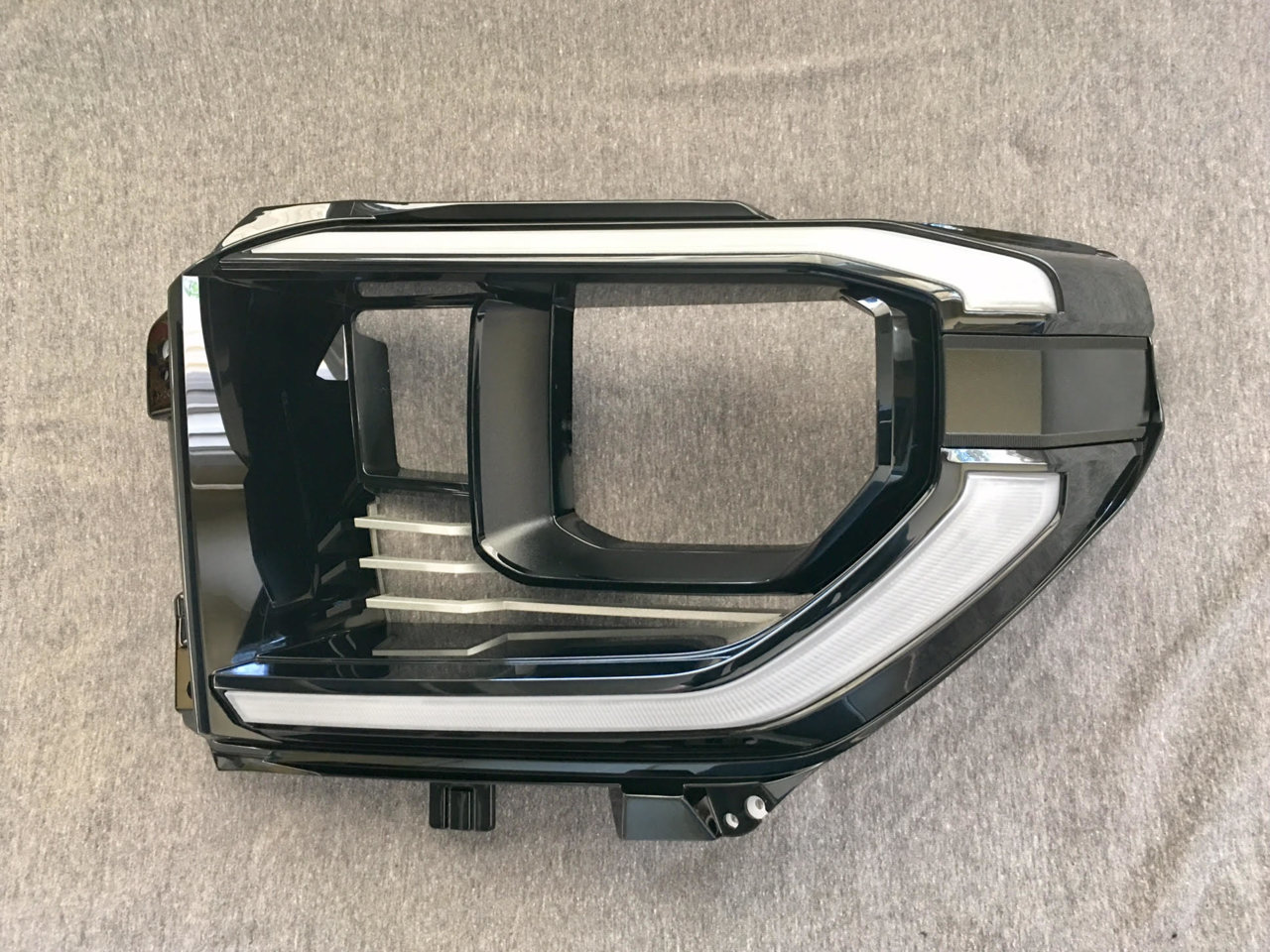

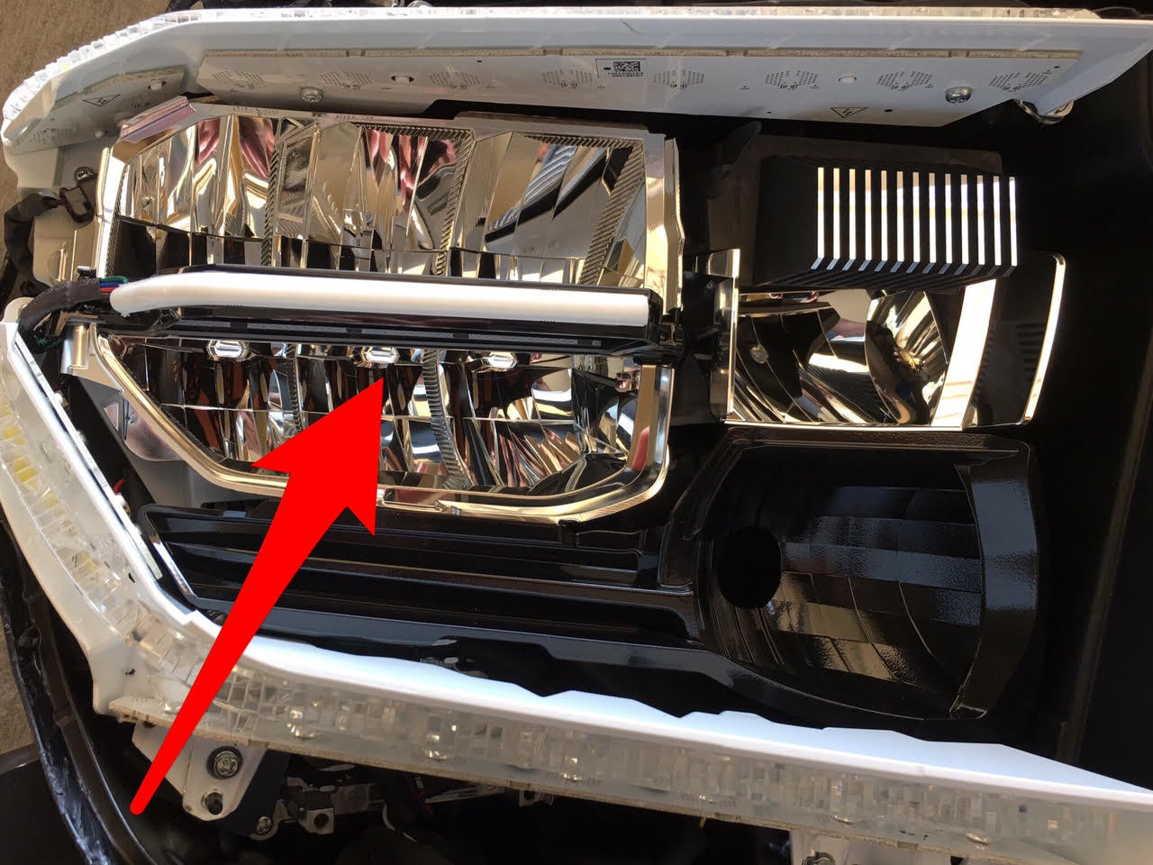

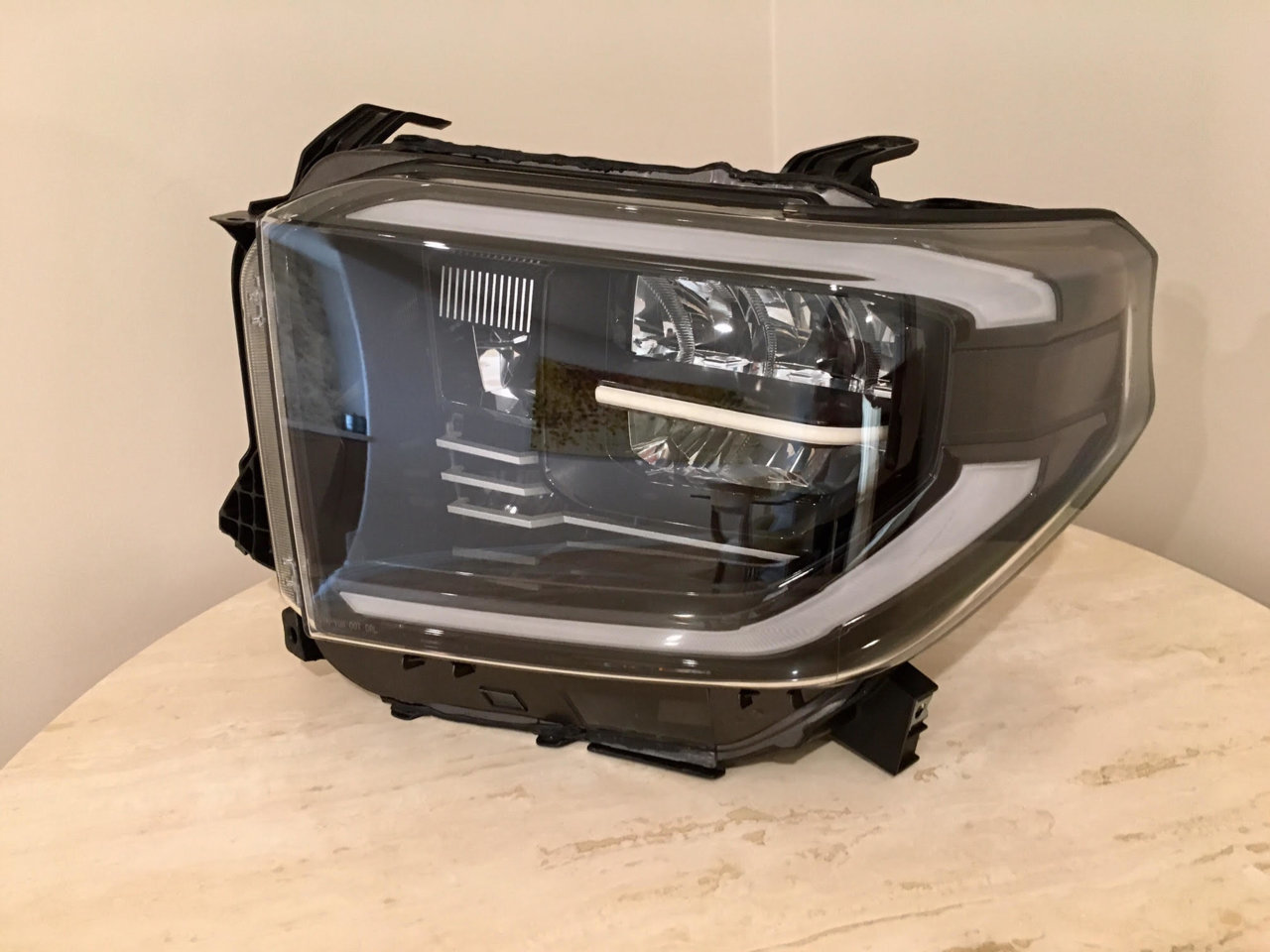

    Recent project, version 2.0 of the Toyota OEM LED headlights retrofit. Started with new set of TRD Pro black housing lights. Painted turn signal bowls gloss black, amber side markers gloss black, frosted LED diffusers, painted turn signal grills silver, added Prism 6" RGB LED strips to the center bar of the inner light housing. Pairing the Prism Strips with the RGB Morimoto Bluetooth Controller. Here's a few pics of the project, haven't fired up the RGB strips yet (will post pics once its all dialed in).

    Scoop is growing on me, it does accentuate the hood bulge completely... Well done!! Nice Rig

    So what’s the best way of getting these lamps apart? I tried a few years ago but seemed like I was going to destroy them in the process.

    There are a bunch of vids on youtube. Bottom line, its a pain in ass. I found that low heat longer time in the oven is what worked for me. The Retrofit Source has specialty tools that help a lot. There are reverse pliers that spread the glue seam, another tool loos like a spoon shaped flat head screw driver. Other than that time and a lot of patience..
    Check YouTube to start, you'll get a base line feel

    I’ve pulled a few other lamps apart, these just seem different.

    That looks super clean...well done.

    Toyota uses a something called Perma-seal rather then the much easier pliable butyl some mfg’s use. As the name states it’s designed to be permanent, hence the reason it’s such a pain to work with Toyota’s not the only mfg that uses it, I’ve opened a few European car headlights and they were much easier. If you don’t feel comfortable there are companies that will retrofit for you and guarantee their work as another option.

    I’m down for trying again, I have the old chrome lamps out of mine that I’ll play with.
