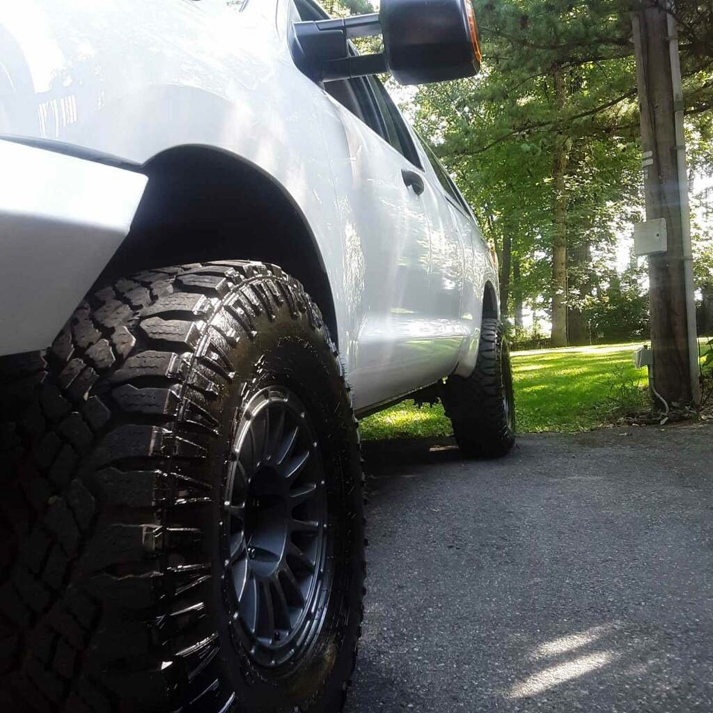

    315/70 or 305/70 are probably the move. I’ve had both of them over the years on 0 offset 17x8.5s.
    Terndrerrr[QUOTED] likes this.

    Probably a bit heavier than the 285/75/18s.
    If I’m going heavier, might as well do 37s
    Edit:
    Duratracs in 315/70/17 are D load. 62 lb. Slightly smaller diameter than 285/75/18…
    Hmmm….
    Silver17[QUOTED] likes this.

    You will be saving weight anyway with the rock warrior wheels only weighing 24ish lbs each IIRC. I had Goodyear territory MTs in 315/70r17 Load C, they only weigh 54 lbs. and can be found quite cheap. Those are small for a 315/70 however. I have also had duratracs on my prior 2010 tundra in 315/70. Phew… gotta stop looking at old pics of those Method 314s. They really do it for me…must resist purchasing more wheels and tires. :rofl:

    Did you trim any on the wheel wells? I have Eibach pro 2s and looking to add the coachbuilder +3 shackles and 315/70/17s. Currently on 295/60/20, but a worried about the almost full 1" increase in width.

    My front fender liners have been messed with and pushed forward before. The 315/70s I had were small, not sure which tires you’re going with but that and wheel offset is a big variable.

    Is that 315/70r17 on that white truck?
    That stance, spec & wheel/tire combo are tits, broth.

    Yeah, those were 315/70r17 duratracs. I did like the look of that setup.
