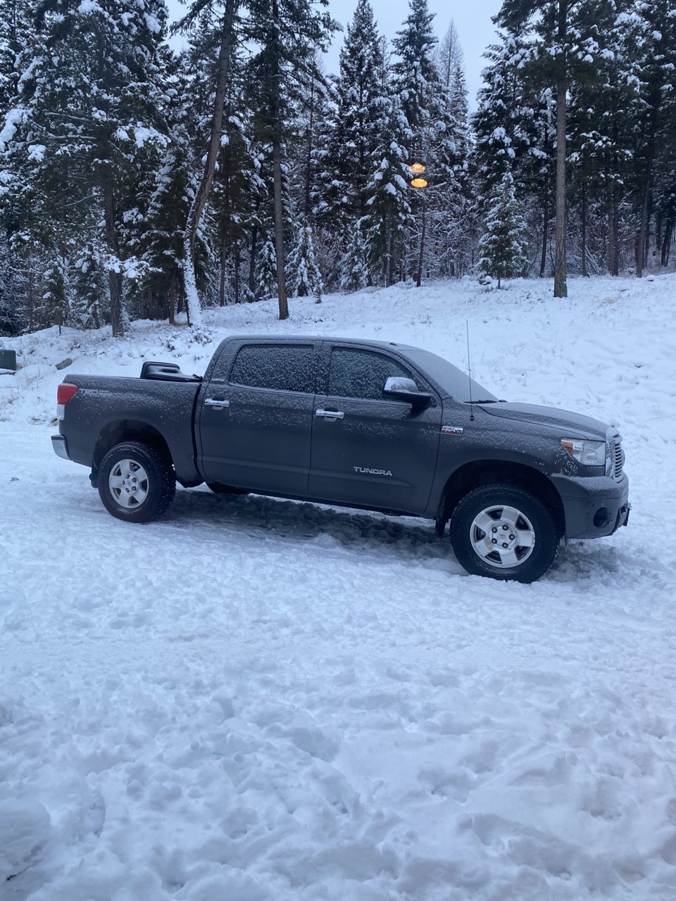

    Thanks for your help everyone. I installed the Eibach 2.0 lift kit, torch add a leaf, spidertrax wheel spacers and Nokian Hakkapeliitta studded tires last week. Got it all done just in time for the big snow to set in!

    hows it feel! How do you like it?

    It’s actually a huge upgrade. The ride is much smoother on paved roads. The truck takes our dirt road likes a champ.
    The improvements already paid for themselves. yesterday I decelerated from 70-0 on the highway due on an accident in front of me ( we had a snowstorm that took out all traction). I stopped without issue, the two trucks behind me drove their cars into ditches from loss of control during braking. The Nokian tires and suspension held up on my truck like a champ! Thanks again for the help

    glad it worked out how you wanted! truck looks great!
