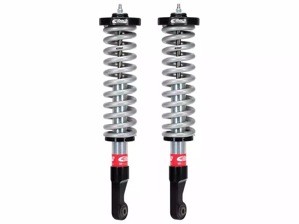

    I installed the Eibach 2.0 front and rear kit about 2 months ago and am very happy overall. The front comes as a completely assembled coilover with new forged aluminum top mounts/strut bearings. The fron are also adjustable between factory height and + 2.75"
    I have mine set at about 2" of lift which I think provides a really nice level.
    Been a fan of Eibach's springs on my cars for decades, but they are apparently skilled at shock tuning and building as well. The lower shock mounts are seriously beefy on these and I dont worry about shearing the little spindle that most other shocks use.
    On road handling is much improved while being only marginally stiffer than the factory billis.
    Offroad performance is great. I find that I can carry quite a bit more speed on dirt/washboard trails while remaining comfortable and in control.
    Only drawback that I can find is more pronounced "bed bounce" on certain sections of concrete slab freeways.
    No way I would go back to stock.

    I used some Eibach springs on Bilstein 5100s and am quite happy. If I had seen the Eibach shocks before I bought the Bilsteins, I probably would've gone down that road.
    Wallygator and jham101[OP] like this.

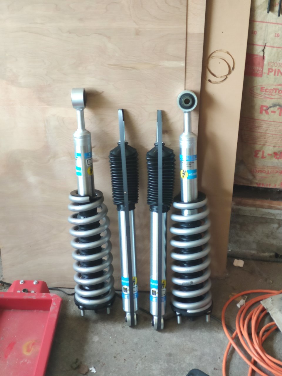

    you're basically shooting for the same budget lift I did... heres my 2 cents on that
    I have the Eibach Pro Truck Stage 1 (in the front), I have them set on the 3rd settings (very top) because I have an after market bumper with winch so added weight, as well as Coach Builder shims (2 driver, 1 passenger)
    FRONT:
    • I would advise that you order the Eibach's (stage 1) pre-assembled on the 2nd clip (this should get you pretty close to a level if not exact paired with the coachbuilder shims)
    • You'll pay (I believe, could be $50) $100 to have Eibach assemble the coilovers for you (THIS IS WORTH IT, I should have done that) which will save you TONS of time and you won't have to worry about using spring compressors.
    • I also have Rough Country UCA that I got used, I only needed them because I was pushing 3+ inches of lift in the front, you shouldn't need that if you just go for a level and not a lift/level.
    REAR:
    • On the rear, I have Bilstein 5100s and a Torch Off Road add a leaf,
    • I have a heavy bedrack and RTT so the add a leafs help with the weight. You won't need the AAL,
    • but I would get something other than the stock shock for the rear, either the Eibach's or Bilstein 5100s for the rear
    TIRES:
    • I'm running the factory 18" Alloy wheels
    • 1.5" spacer (originally for an offset look, but with stock UCA it made sure I didn't rub with the 12.5" wide tires)
    • Running 35/12.5R18 tires
    SWAYBAR:
    • If you're comfortable with it, I would experiment with taking off the swaybar, I took mine off and gotta say the truck rides way better without it. Granted I do way more off roading than towing so I have no real worries there. As well as the truck being lifted I'm not trying to corner super hard or make fast sharp turns. The truck still feels planted and I don't get any bouncing around on the interstate or highways.
    If you got any questions with what or why I did it, feel free to ask, more than happy to explain anything.
    If you're looking for something super smooth, maybe look into the Bilstein 6112s or something of the sort, maybe the Eibach 2.0
