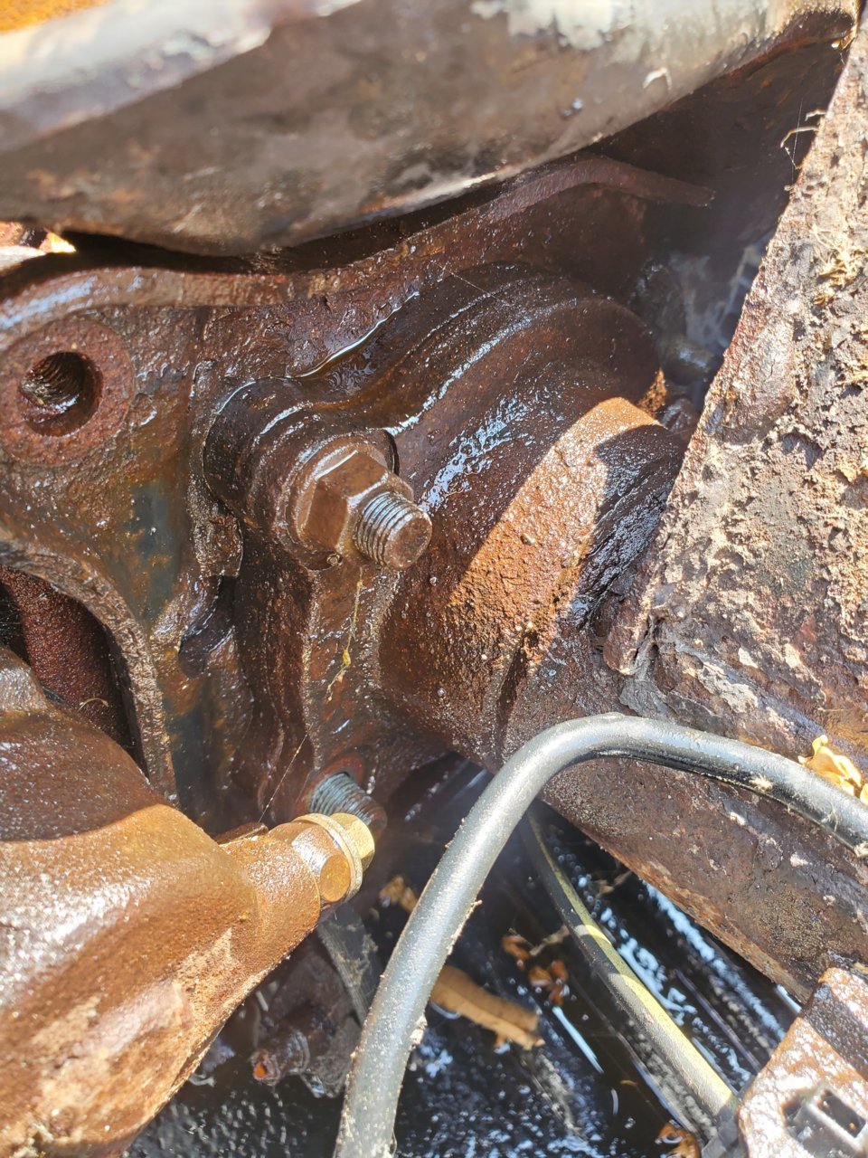

    @evilrb can you post a pic of the back side of the hub/backing plate piece on the sequoia axle? The part where the axle bolts in? Kinda for clarification of what Mr. Lord is talking about.

    I already got rid of the axle but here are the pictures I have
    As empty_lord said, the plates are not the same and the Sequoia ones are off-center while my non- ABS plate bolts are squared.
    The pictures aren't the best but if you look at the b olts you can tell.
