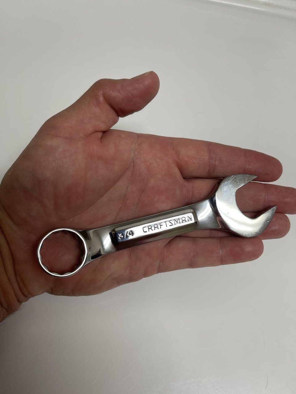

    Same issue with the confined space. Luckily for me, I had this stubby 3/4 wrench in the back of the toolbox. Was just able to get it to fit in there. Had to tighten in little tiny bites, so it took a while, but was able to get some oomph on it at the end to make sure everything was cinched up tight. D9BCFDA0-2985-488A-9197-66B1E9402ABC.jpg

    Damn, well that beats my long needle nose. I may need to pick one up to tighten the rest of it when I have a chance to.

    If you can’t find a stubby, you can always get a cheap Harbor Freight or pawn shop one and cut it down to fit.

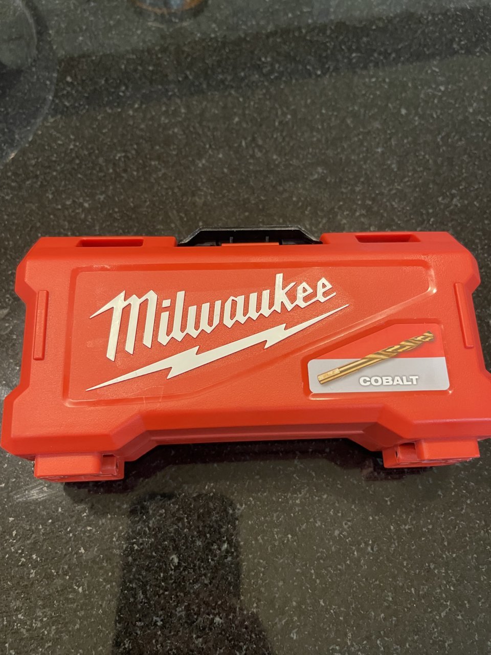

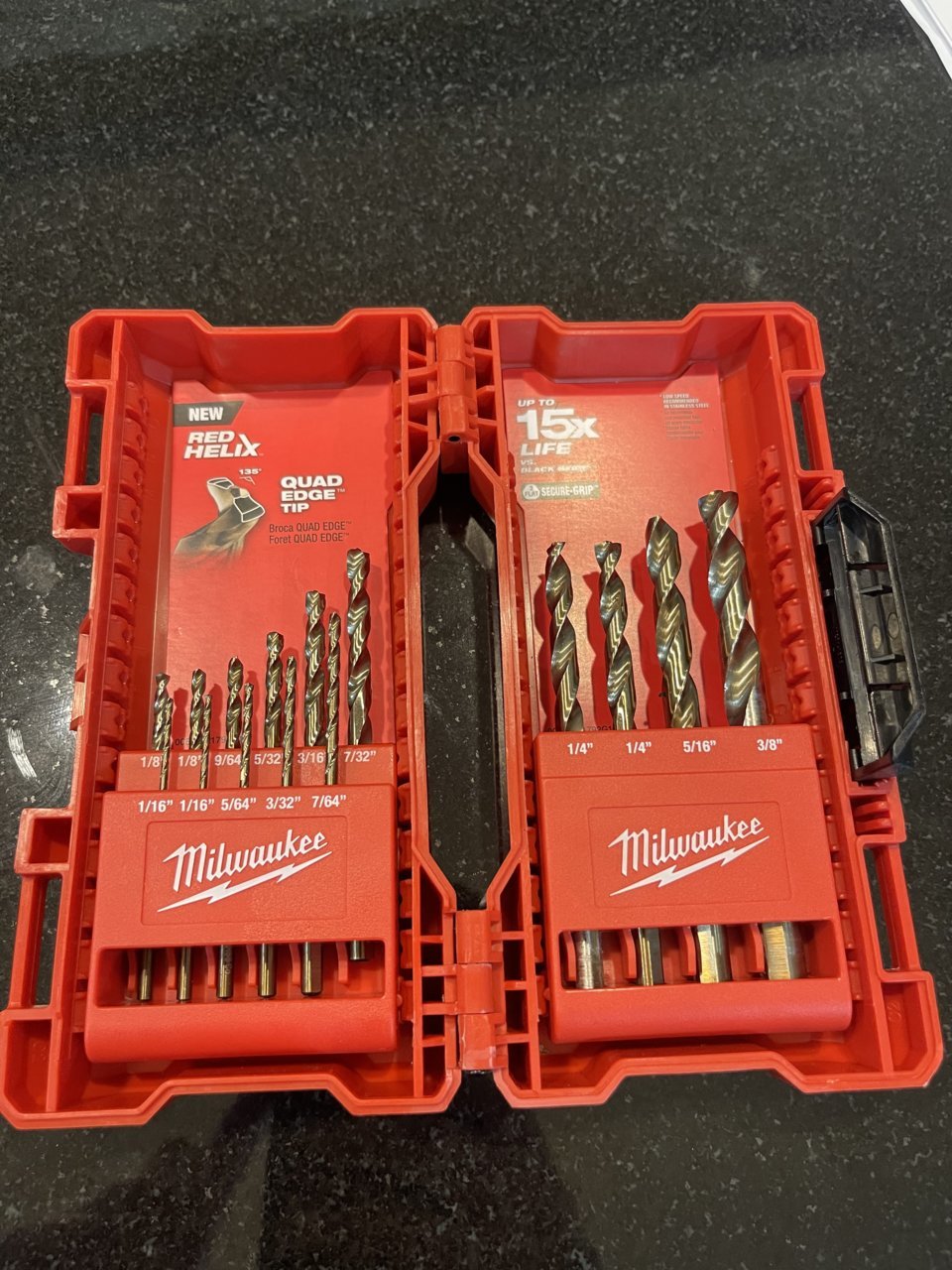

    Those Milwaukee Black Oxide bits are what you want, but you’ll need to get up to 1/2 inch. Those included unibits may get you there, but I’m not sure. With the right bits, I doubt you’ll have a need for the Jack, but it won’t hurt. Bits are key. Grab some appropriate long-sleeve work wear.
    That stubby wrench should save you a lot of heartache. Let me know if you have any other questions.

    I’m prepping to install the same sliders. I’ve read horror stories of trying to drill through the frame so I went on a mission for the best bits and found these at Home Depot rated for “hard metal”. I picked up multiples of various sizes from 1/8” to 1/2” figuring I can return them if I don’t end up needing them all.
    https://www.homedepot.com/p/Milwaukee-3-8-in-Cobalt-Red-Helix-Twist-Drill-Bit-48-89-2321/203115297

    So this one is the one that I want, correct? I can use the step up bit since it goes up to 1/2
    https://www.homedepot.com/p/Milwauk...0-Piece-48-89-9222/204312649#product-overview
    And yeah, I am lifted. Its just 2.5" so I might get the Ryobi since it is cheaper.
