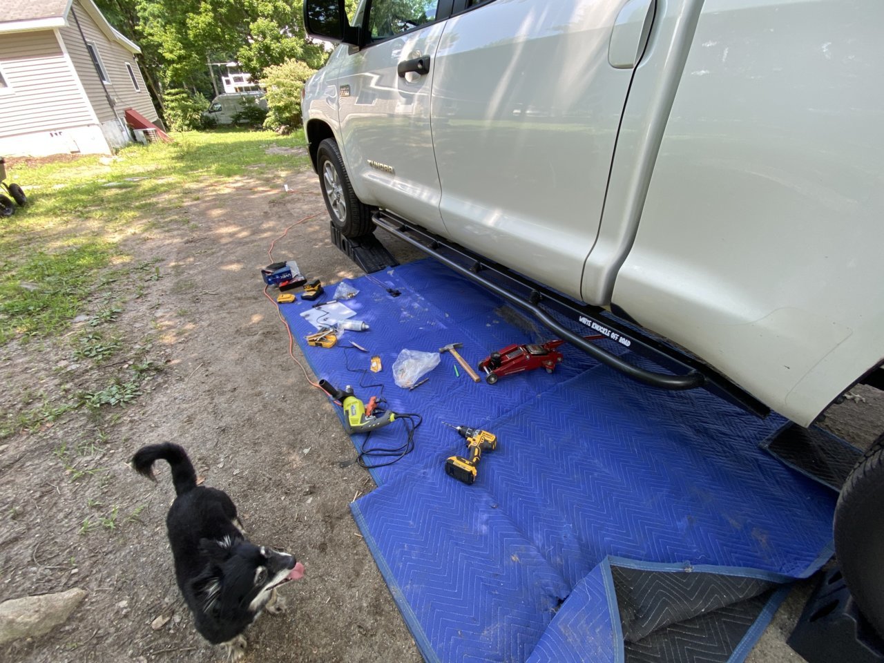

    Holy shit dude… hope you’re ok. I had a few close calls while drilling out those on my truck. I’m assuming you’re wearing eye protection?

    Should have thought about wearing goggles or even moving over to the side while drilling. But I was just wearing my glasses.
    Would have been smarter too if I had some more clearance (i.e. using my rhino ramps or even jacking it up).
    I'm all good though, it was aching a bit this morning, but popped a few ibuprofen and I'm at work. Fiance was frightened with all the blood coming out. May have given myself about an inch gash next to my eye. Luckily, I didn't hit my eye.

    I'll get some pics tomorrow. It's raining pretty heavy here rn. Glad to hear that the damage was minimial. Keep us updated!!

    What bits do yall recommend getting? Also, do you think I can drill all of the holes with a cordless drill or should I get a wired drill? My drill doesn't seem to work the best with long durations of drilling.

    I used a cordless and regret it. The holes just take a lot of time for each one. As for bits, someone recommended Milwaukee Shockwave I think, but hopefully others chime in on that. The Dewalt ones I had sucked for this project.

    Hahaha, well if you really want to be safe and not end up like me, get a hammer drill with a side handle. That’ll give you more stability when you drill.
    If you guys watch on YouTube, the “Kino the Tundra” guy uses his jack and a hammer drill to make a drill press while drilling the holes into the frame.

    @YotaBro Expect to spend a good 2-3hrs each side for drilling. Even with sharp bits, lol :rofl:

    Geez man, I’m barely starting the driver side.

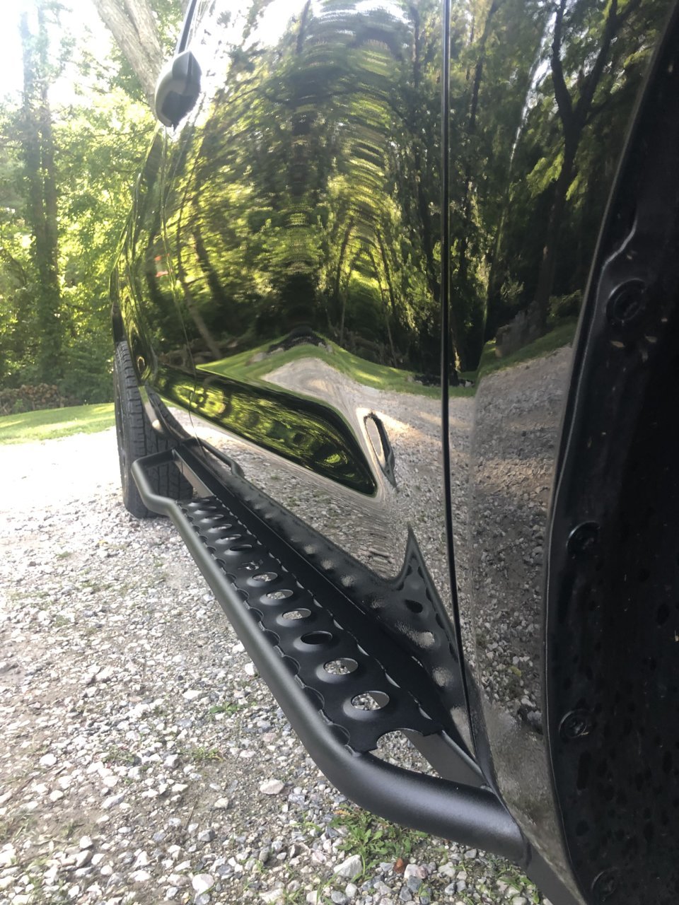

    2” level P&P sliders
    Should have got P&P engineering sliders
    ROCK SOLID and uses all factory frame holes !!

    A beer would have been nice LOL. Well I got it installed. The only issue is the last driver side bolt.
    There’s a rivet nut in the way of the plate, causing the 1-1/2inch G8 bolt not to be able to reach…

    Lol yours look great!! The WKOR uses factory holes too, 5 on the sides, and the 5 bottoms you have to drill out.
