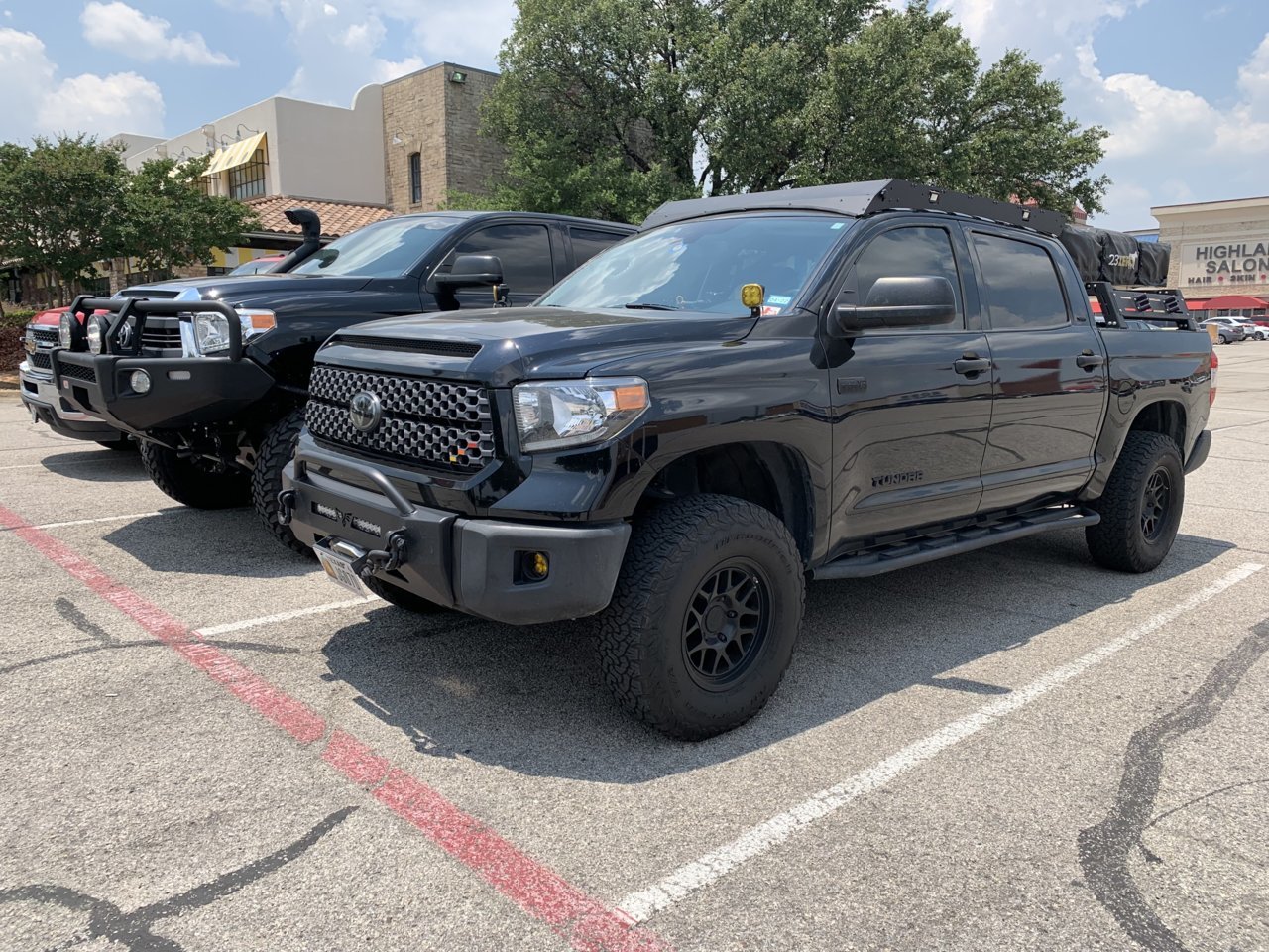

    You won’t be disappointed!

    Looks awesome! You have the trail editions right? Doesnt look wide enough to be the step edition. I went with the rhino lining to help the family with grip. I am also hoping the install goes smoothly with my smaller gas tank. That seems to be the area most people have issues with their larger tanks.

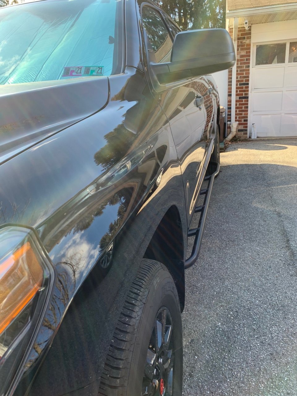

    Yes, these are the trail edition ones, I wanted them to be a little tighter to the body. My six year old son uses them as a step with zero issue :thumbsup:
    I do have the 38 gallon tank and it’s a tight squeeze to get in between there for sure.

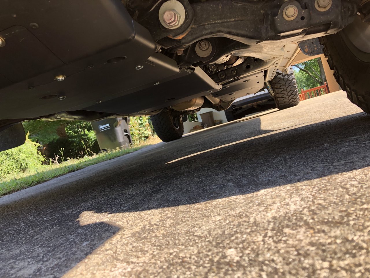

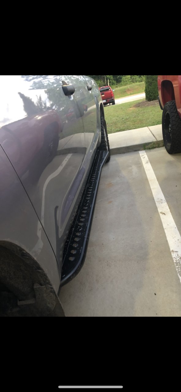

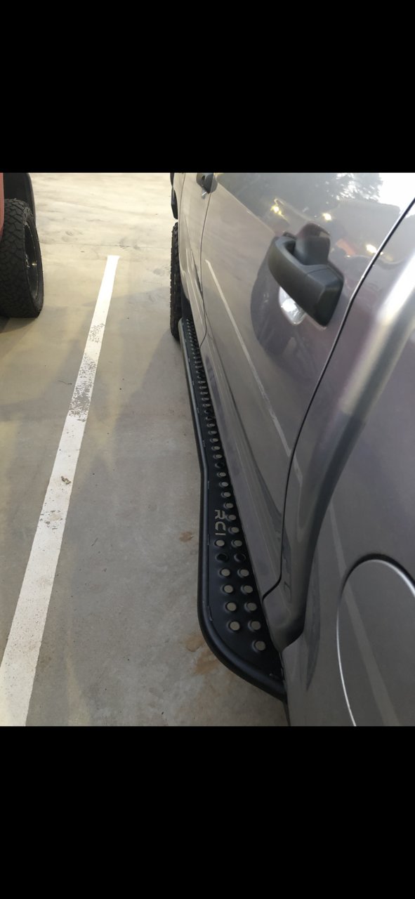

    RCI powder coated sliders with top tread plate. Install took about 4 hours total. Used a floor jack and 2x4 to hold the sliders in place and get them into position. Takes 5 bolts on each side, but currently only have 3 bolts installed on the driver’s side slider. The driver’s side is tough because the frame of the truck is next to the gas tank (38gal). It is going to make those last 2 bolts hard to install. Dropping your tank would make it easiest but I’m trying to avoid that. You will also need to unclip your brake lines on passenger side in order to tighten one of the bolts, but the 5 bolts on the passenger side are all way more accessible than the driver’s side. Overall very happy with the fit and finish. I like the “low profile” kick out but also wouldn’t have minded a wider kick out either. Also got RCI’s full aluminum skid set. Would recommend their stuff to anyone looking for solid armor that is all bolt on!

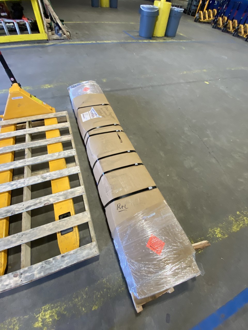

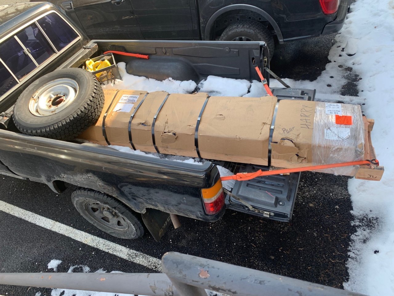

    AND IT’S HERE!!! Ordered on Apr. 7th, arrived today (Jun. 30th).
    Will open after I’m done with work!

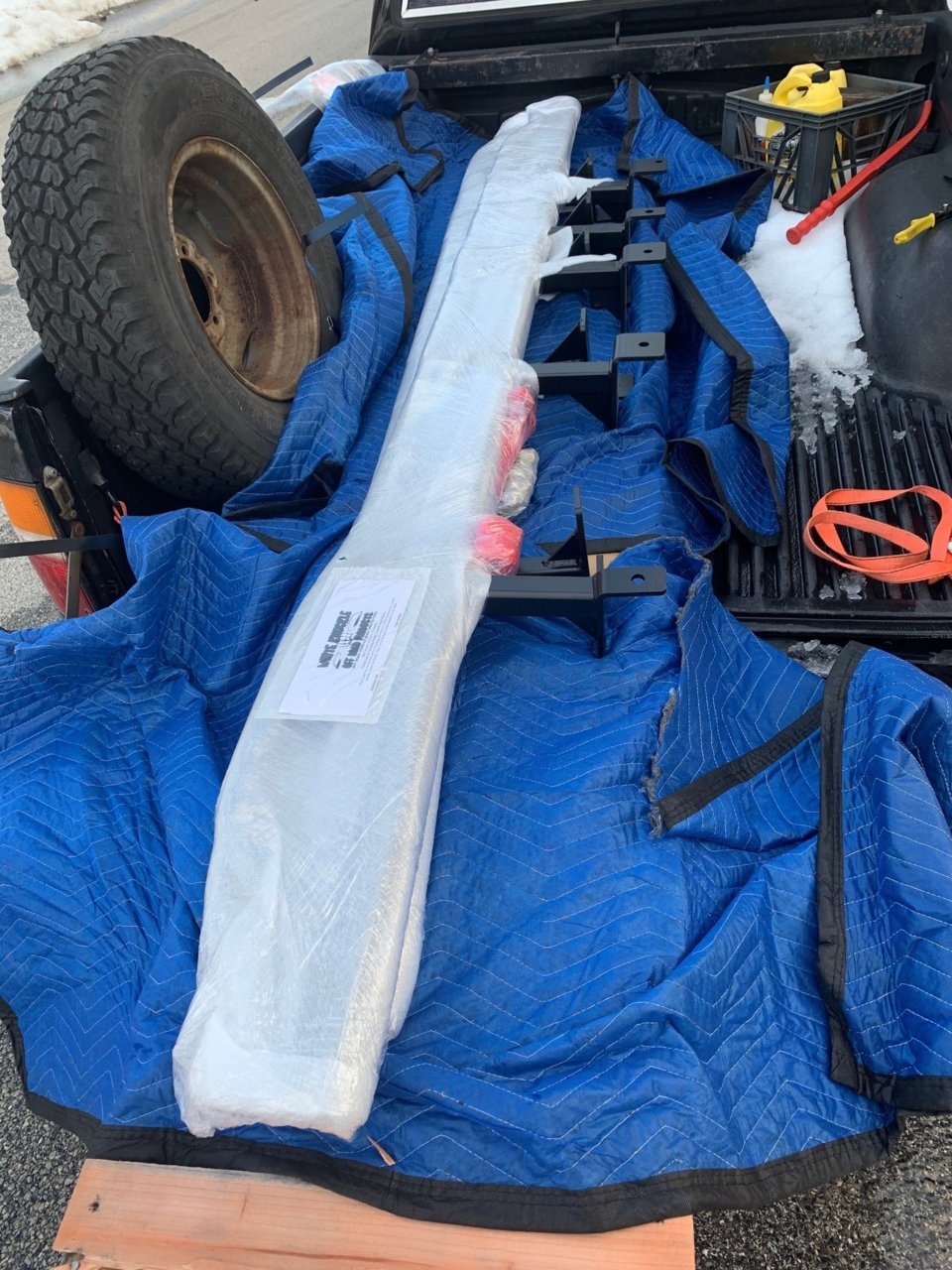

    Yeah I see it! I haven't opened it yet... but working at Amazon gives me the leisure of having free moving blankets :)

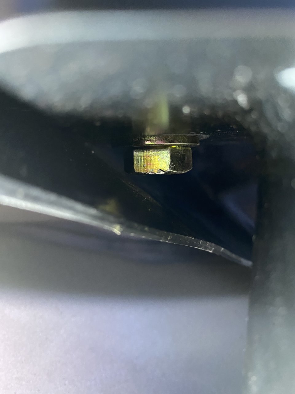

    FFS, this install was straight forward, but difficult. I was only able to knock out the top frame bolts, so still have to drill out the holes for the remaining bottom frame bolts.
    Tried to drill out the frame holes this morning, but I ended up smashing my left eye with the drill battery. Took a chunk of skin and was bleeding every where...
    @YotaBro take a photo of your rear driver side cab mount. I'm not sure if it's similar to my 2021, but it was a PITA to get to (had to borrow my fiance's small hands in order to get the mounting plate w/ the rod). It's just a really awkward position behind the gas tank. Also, a socket will not fit in that tight space next to the driver's side rear cab mount. My 19mm wrench can only fit at certain angles. I was using a long pair of needle nose pliers to turn the bolt until it tightened the sliders against the frame.
