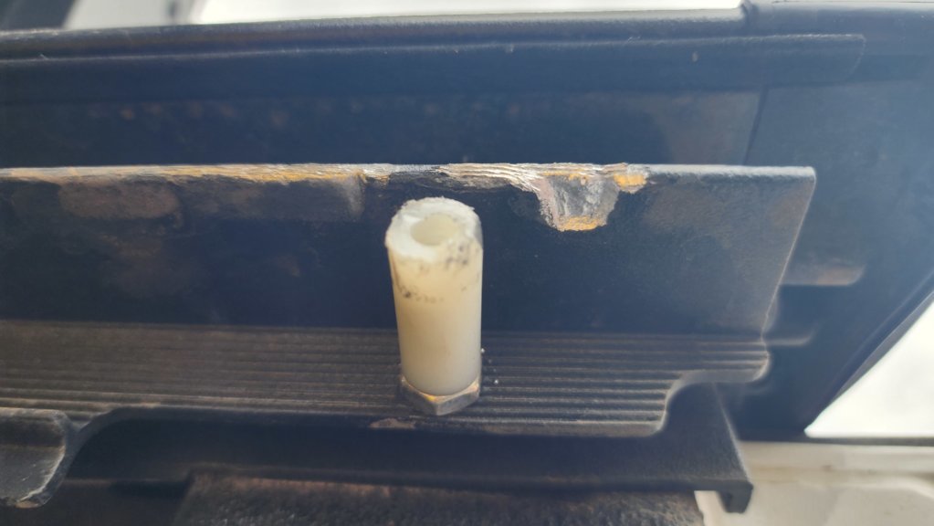

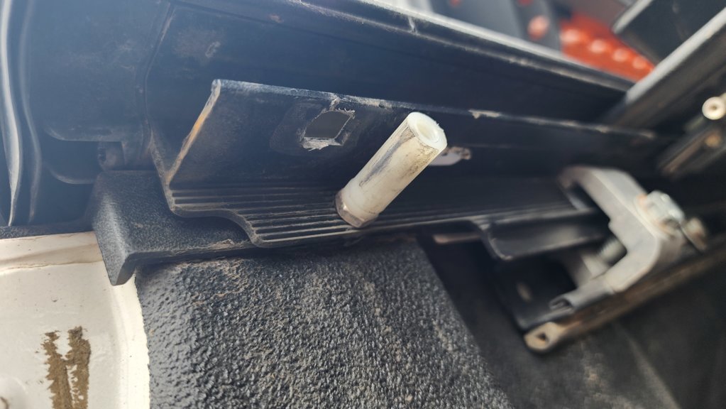

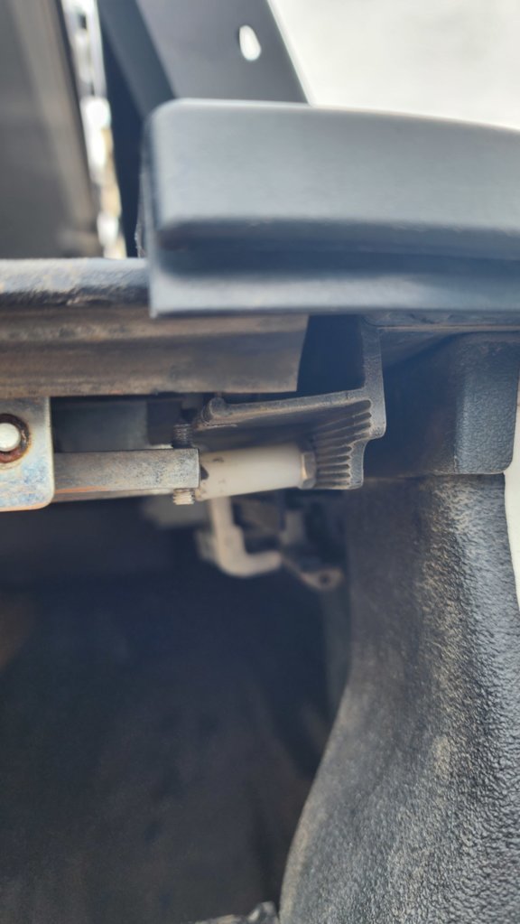

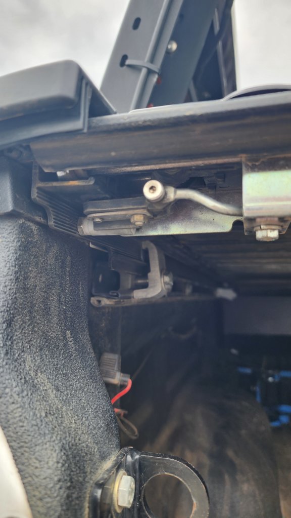

    ok the pictures. Also my left side does have the square cutout hole. my original rails did not.
    20250531_144937.jpg 20250531_144930.jpg 20250531_145039.jpg 20250531_145049.jpg

    That first pic the set screw isn’t even touching the rail! Check the alignment.
    why can’t we just drill a 3/16 hole in the right side rail? That would make double locks on both side? I think even having the square cut out on the driver side is enough imo

    Yeah it keeps slipping off. looks like I need longer alignment shims on the driver side and readjust the passenger side shims
