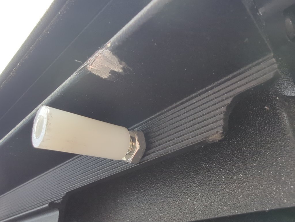

    Has anyone else had issues with Retrax? I've had the XR Pro cover for under a year, under 5,000 miles of driving, and the rails where the lock clamps attach on the bottom have worn down on each side and will eventually crack which will prevent the lock from engaging. I tried their customer service and they been far from helpful and downright rude to me. They denied warranty coverage and want me to pay for them because the rails have naturally shifted fractions of an inch from the center line, and that I should've been checking the clamp tightness like I would be doing on intervals like oil changes (I change oil every 5k).

    I've had no issues. Can you post pics? Sorry they were so rude to you.

    Here's a pic. The lock pins have basically eroded the rail that they latch to.

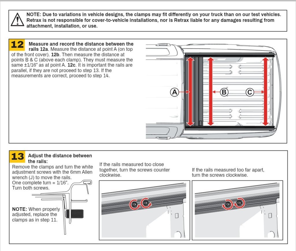

    They're claiming the rails have shifted too far apart since initial installation, and that it is my fault for not checking the spacing regularly. Yet the first rep suggested every oil change, when I haven't even had it for enough miles for that yet...It really seems like they're just using every excuse not to cover it.

    Yes their warranty sucks, but they outline it clearly at the top. Its so general they may as well apply it to anything.

    I do check my rails every so often - I have to, the rail clamp design is horrible. They need something that bites into the rails more. My clamps work themselves into an angle after a few months and I have to reset everything.

    My rails are solid and have never moved. I think the key is to make sure the clamps are all the way up engaging the top-most grooves on the rails.

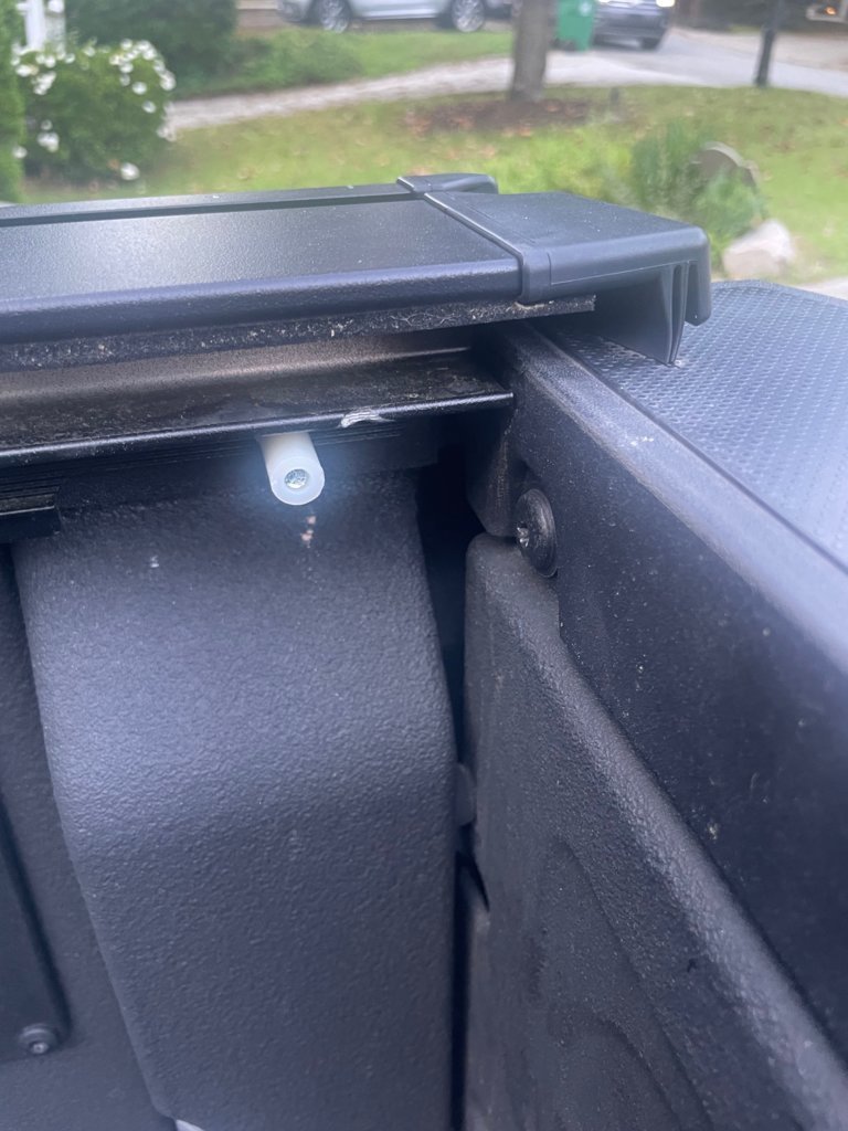

    Following up here to warn users of the retrax pro XR design. It would probably help to install a piece of protective metal to prevent damage to the rails. Here are my rails for reference. All spacing is perfect between both sides, and yet..... This is only after 500mi

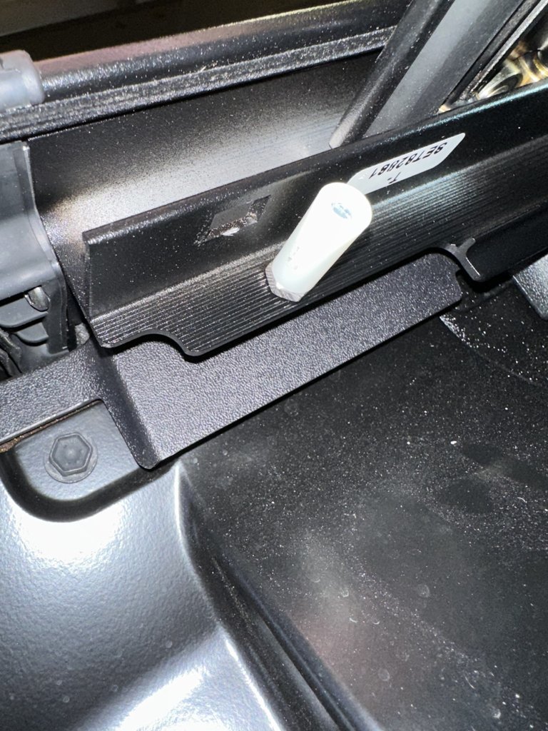

    mine is cut out. The locking screw / pin goes up through the hole. Works amazing

    did you do that yourself?

    That's the left side if I'm not mistaken, not the right / pin locking side. I'd love to see what the other side looks like

    Both sides have locking pins on my Retrax Pro XR
