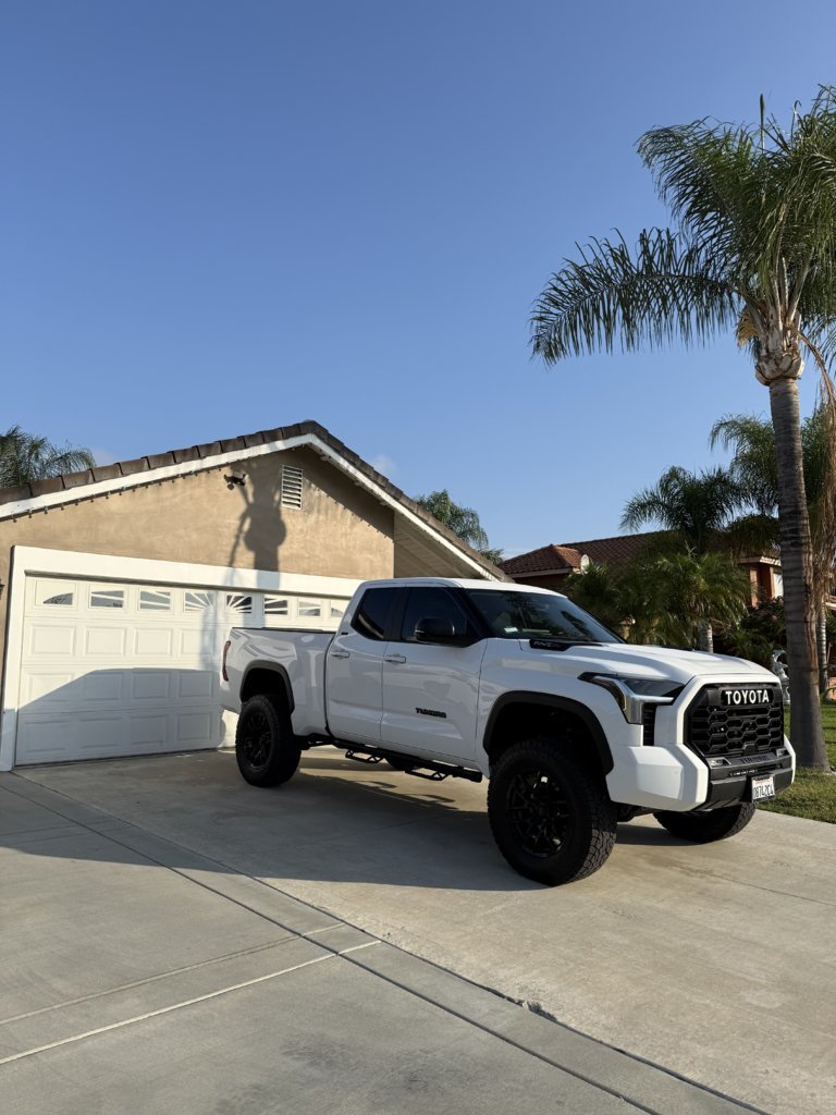

    Aaron
    Southern California
    2024 White Tundra SR5
    37’s :(
    Hello all! Just following up to ask if any updates have been made regarding new gears for the 3rd gen tundra? I recently bought a 2024 Tundra SR5. The previous owner put 37s on the truck. It looks nice but I’m worried about longevity given that it’s on stock gears. I’d love for this to be my forever truck. I am willing to make any important modifications to ensure that my truck is happy and healthy for years to come!
