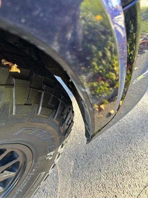

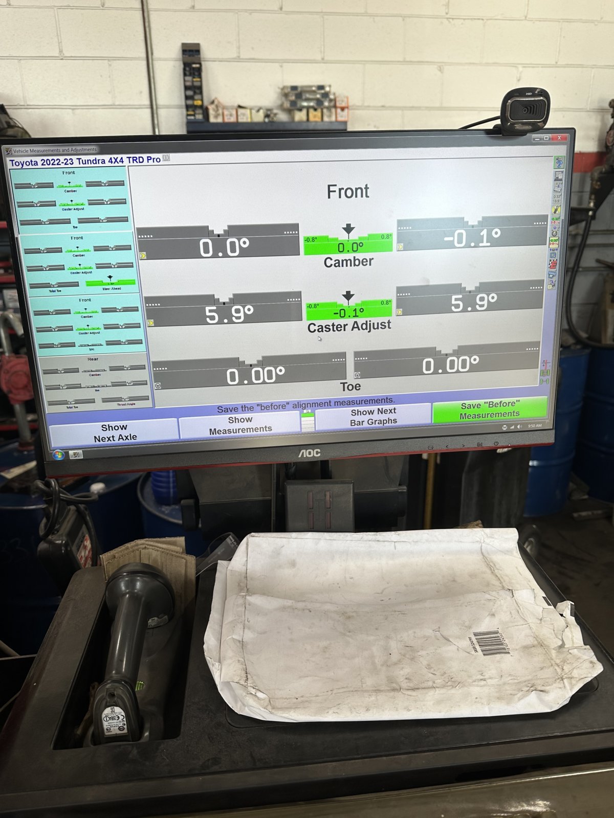

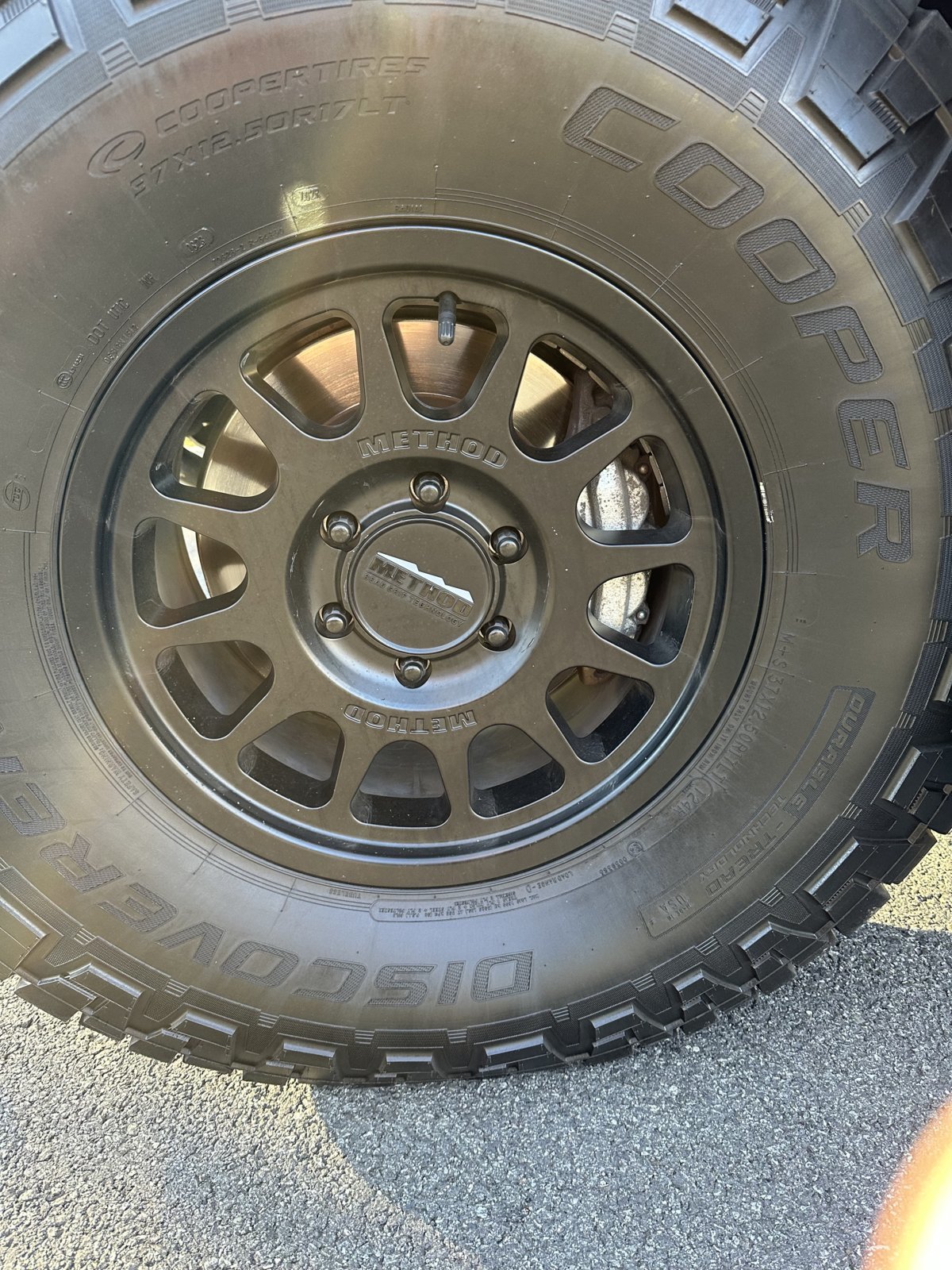

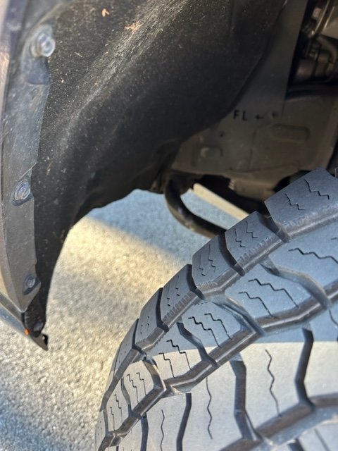

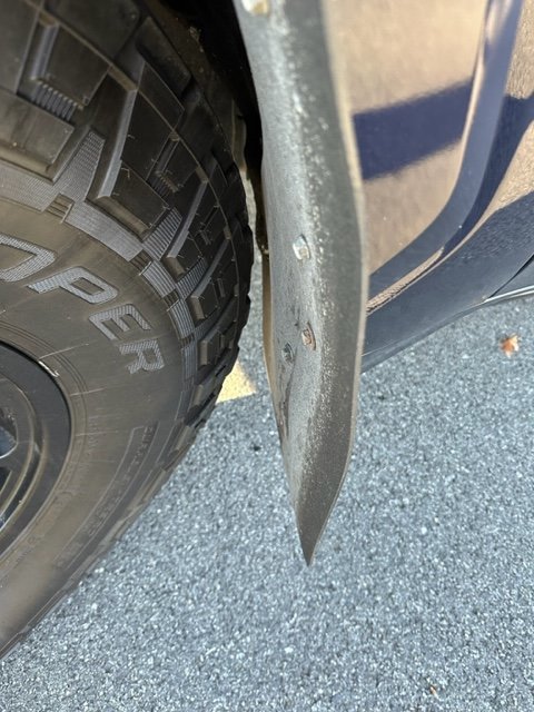

    Yes
    Eurodriver likes this.
  29. Nov 23, 2023 at 8:50 PM
    #29
    virgilus11
    virgilus11 New Member
    Apr 14, 2019
    #29082
    217
    2022 Tundra Capstone
    1/2" front spacer 37" Cooper ATX
    Thank you but I did not have to cut any body panels .
    I have 1/2" spacer in the front that gives me 1" of lift and TRD lift uper arm that gives me a pretty aggresive caster
    I had to cut that crash bump that was welded and remove the little bracket behind the felt
    Even with aftermarked mud flaps and I am about 3/4 " of space left I did installed a small 1/4" spacer on the bump stop so , I lost about 1/2 up travel.
    Before I installed the TRD upper arm, I was touching the sway bar at full turn. Not anymore. IMG_9812.jpg IMG_9513.jpg

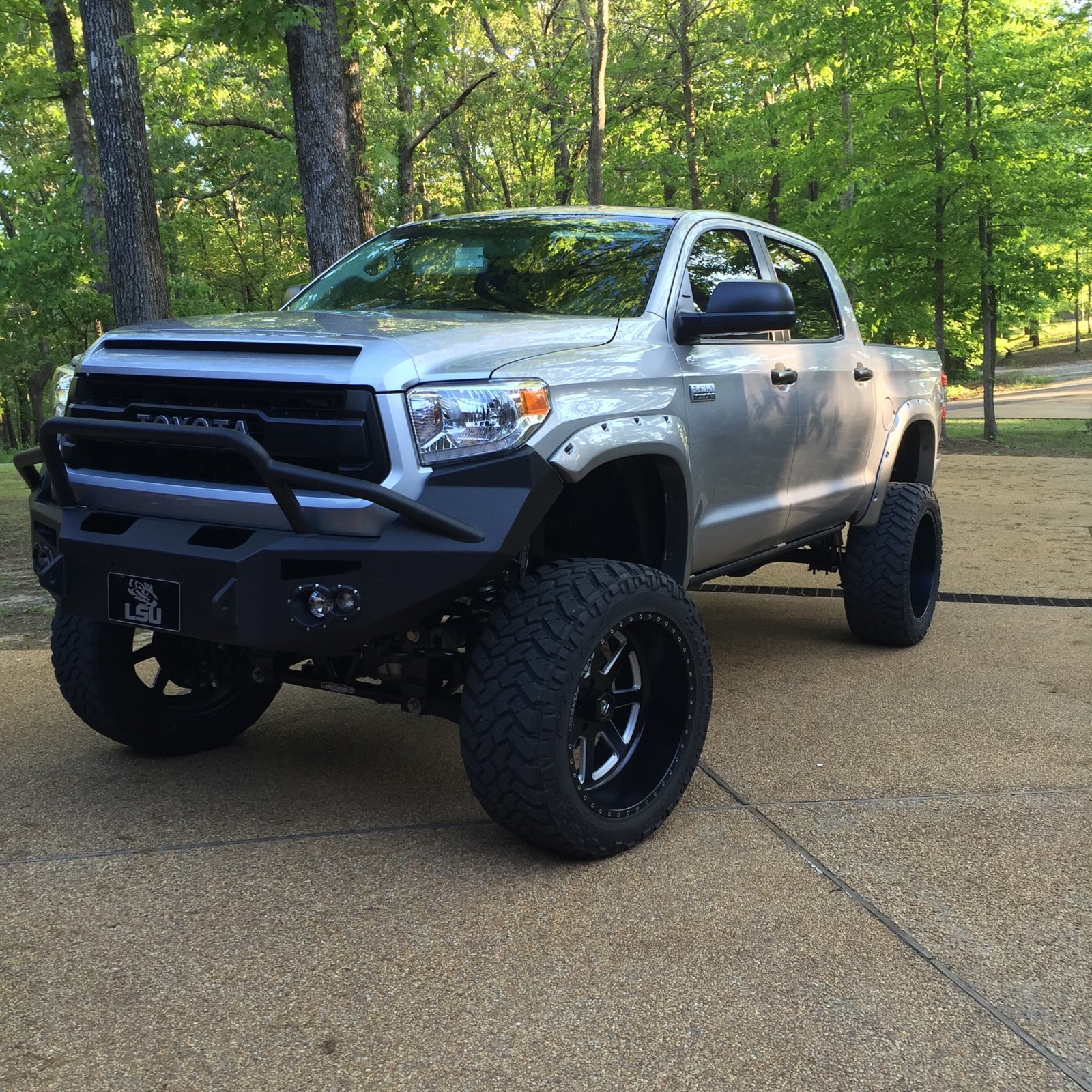

    DeepH2O
    DeepH2O New Member
    Nov 5, 2023
    #106461
    58
    Ryan
    Mississippi
    2023 Tundra Platinum
    6” RC lift 37x12.50x20 Tires 20x10 Fuel Wheels BakFlip MX4 bed cover Westin Outlaw Steps JB4 Tuner TRD Shift Knob
    I’d def be interested in new gears! I had a 2015 Tundra w/ 12” Bulletproof lift, 38’s, and Fab Four front bumper. Installed lift with around 5,000 miles on truck. At around 12,000 miles, the trans bit the dust! Toyota warrantied it on a “good faith” warranty. Basically, they said we will replace trans this time, but with the huge lift and tires, if it happened again they would not cover. After the repair, I installed Nitro 4:88 gears. It was a completely different truck after that!! I’d rather not go through the same with this truck, haha!
