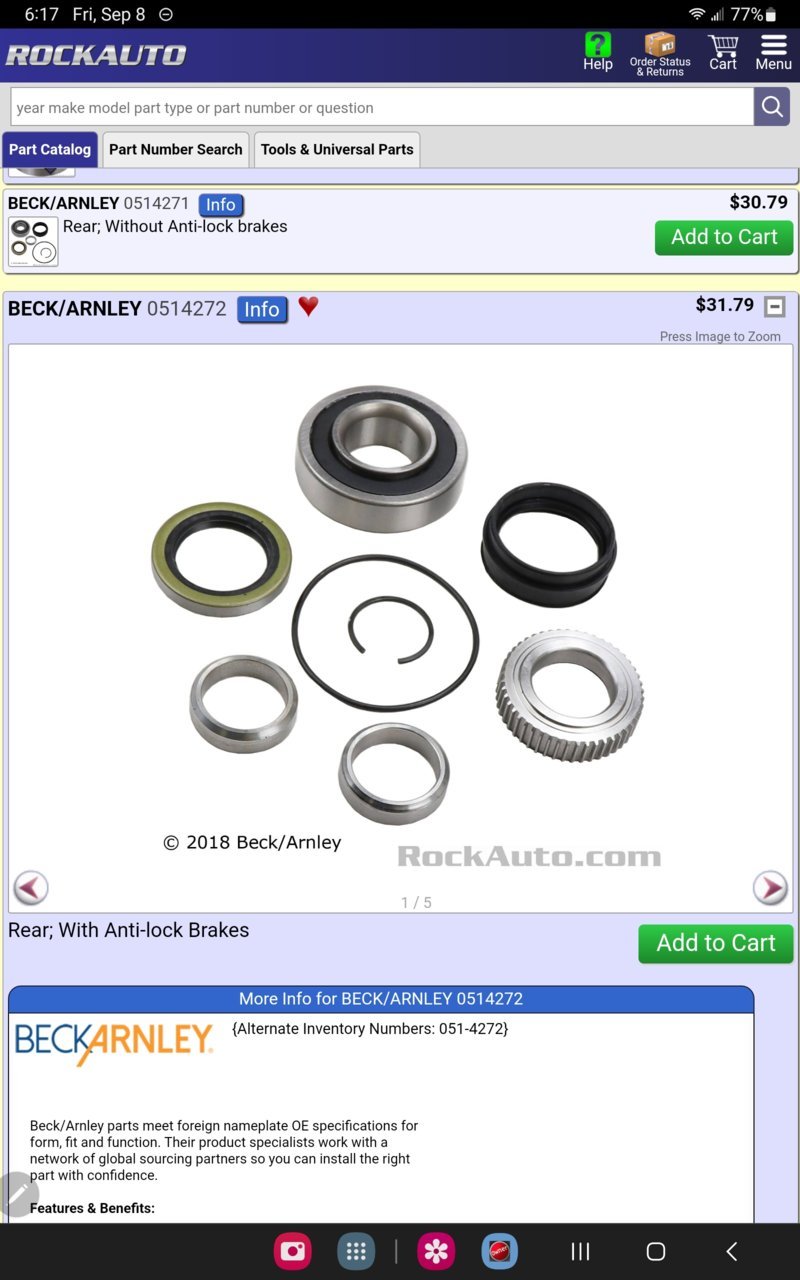

    You won't find a hub for the rear. RA has a complete kit for the bearings, but @shifty` won't approve of the bearings. He can probably find an oem kit for you.
    Be warned: you need the Toyota rear axle tool and a 20 ton press to diy this. And this video:

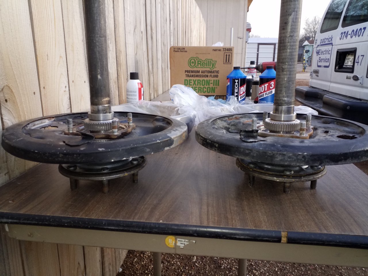

    Gimme about an hour and I'll get some pics to show you what I'm talking about.

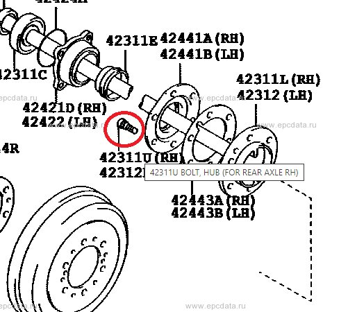

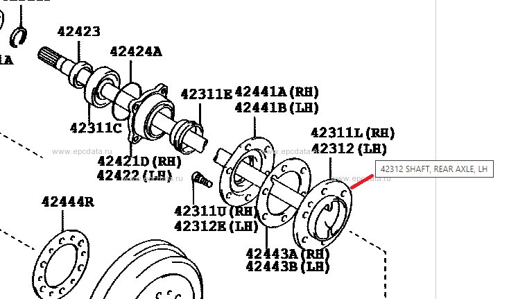

    Maybe you're not looking in the right place to get the part number? Hit the bullets at the top of this thread: https://www.tundras.com/threads/howto-use-the-toyota-parts-system-to-find-order-parts.113808/
    Specifically, after you plug in your VIN and tap search at that EPC-DATA site, you're gonna want to go into the "transmission / chassis" link. From there, I think it's probably next to the 2nd exploded diagram, there should be a link listed as "Rear axle shaft/hub" or similar.
    From there you can literally blow up the last exploded diagram, click on any number next to a part and it'll barf out the part number. I don't recommend shopping at that site. But if you have the part numbers and see how it comes together, it makes it easier to shop for parts.

    Your Tundra doesn’t have a rear wheel hub. Just an axle, bearing, seal, circling, spacer rings and depending if you have ABS a tone ring.
    DJenerated likes this.

    The axle is technically referred to as a "hub" in some parts of Toyota's docs.

    Only highlighting one example of that so nobody accuses me of talking out my ass.
    Flipping thru the exploded diagrams you'll see stuff like this, the wheel stud being referred to as a "hub bolt":
    While it's true they do list the "hub" it goes into as an axle shaft, I don't think the language OP used is necessarily incorrect.

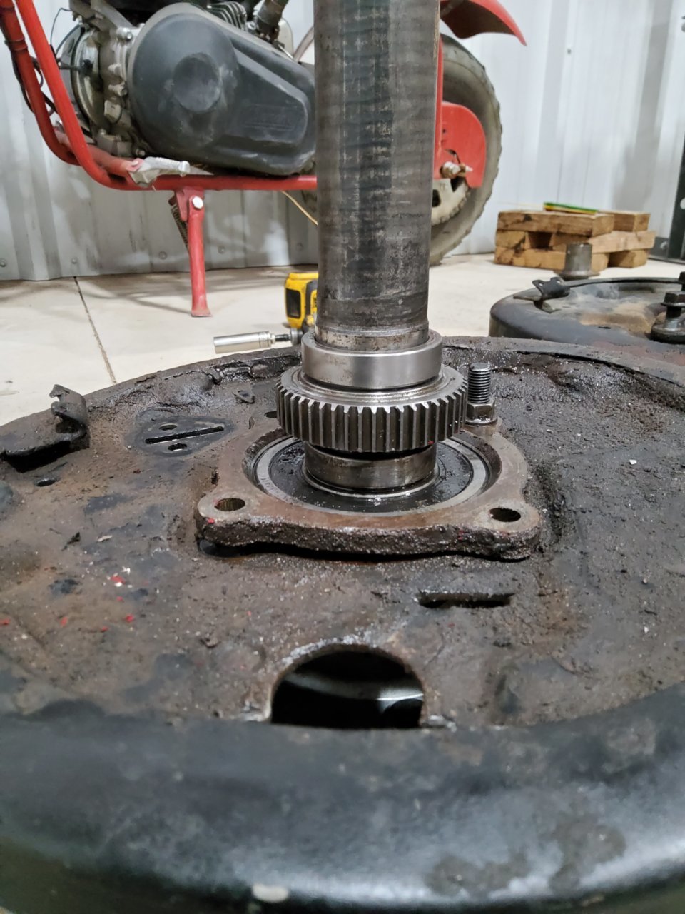

    Yeah, there's no hub per se. All the shit presses on your axle from the differential side. The old ones have to either be cut off or pressed off.
    See that little shiny section above the tone ring retainer? That needs to be 5mm plus/minus a mm or so.

    How hard would it be to measure where the seals should go and then mark it with a sharpie? To avoid a shop message up.

    Not hard. Me and @Mr.bee used a 5mm allen to know how far to press it. The axle tool has a little notch in it to measure.
