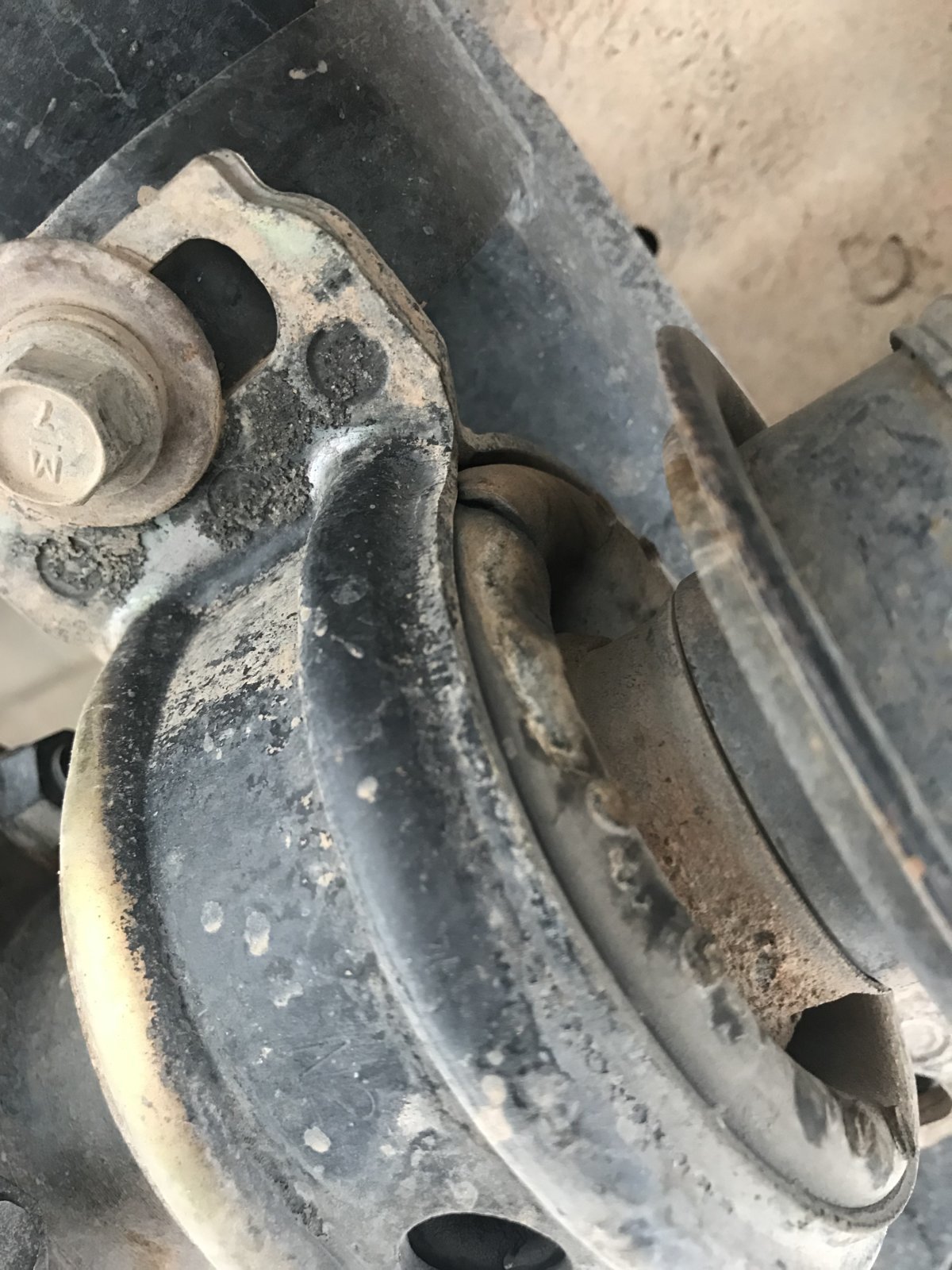

    Dollars to doughnuts this was the reason. I’ve torn off a couple shock mounts in the past. If you don’t allow the correct length of shock for whatever application you have, the shock is what become the limiting strap and or the bump stop. Sometimes a REAL stiff shock valving can do the same damage as well. I don’t think i’ve ever seen it happen on a street driven truck/jeep though. I’ve only see on rigs that get beat pretty hard offroad, so i’d be inclined to think that this potential truck has been someone’s mountain pounder at some point.

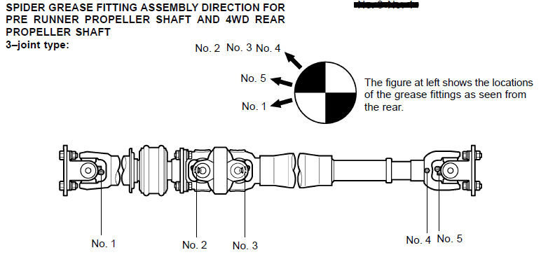

    As you'll see in the 'so you want a 1st gen' megathread, and search for the word ZERK, one of the big things people fail to do is grease the driveline. I assume it's 4WD, there are a number of zerks to grease, and a special process for the slip yoke.
    My guess? The PO failed to do this maintenance piece that should be done every 5k-10k miles, though it could be the carrier bearing, it's probably dry and/or worn and/or failed u-joint(s).
    Best case? the u-joints are dry and are long overdue for grease, the vibration is them shimmying around in the joint.
    Worst case? They got so dry one or more u-joints has failed, and the vibration has claimed the carrier bearing, possibly the pinion bearing, output shaft or other shit to fail. But you'd be feeling more than just a light vibration if it was that fargone.
    My advice?
    • Grease all zerks on the driveline with appropriate NLGI 2 grease ASAP, the proper way where you clean the zerk off, pump until old dirty grease squishes out which can be a bitch due to weird angles sometimes, and heed the recommended fill process for the slip yoke specifically (instructions linked in that megathread), wipe off whatever comes out
    • While in there, grab the shaft on either side of every u-joint for the rear driveshafts, and lift up/down/left/right/B/A/Start in opposing directions to check for play - there should be virtually no play in any joint
    • Get on the highway and test again, is it gone?
    • Either way, also inspect the carrier bearing ("center support bearing" that connects the two rear shafts) to ensure the rubbers aren't torn to fuck, since it's the first thing that'll fail when a u-joint is causing vibration. If rubbers are torn it should be replaced. PLAY IS NORMAL in this joint, to the tune of 1/4" - 1/2" in any direction, torn rubbers, loose bearing housing, exposed joint is not normal, ensure all four bolts are present and tight.
    • IF YOU REPLACE THE CARRIER BEARING, note the two rear driveshafts are clocked a specific way; always mark. And actually, the FSM you can download in the megathread explains how to verify the clocking, although I know @Mr.bee and/or @455h0le_dachshund have posted a screencap on this one. I think it was bee. One of our Texas friends.

    This is what i used, and it worked. Verify, then mark your shafts.

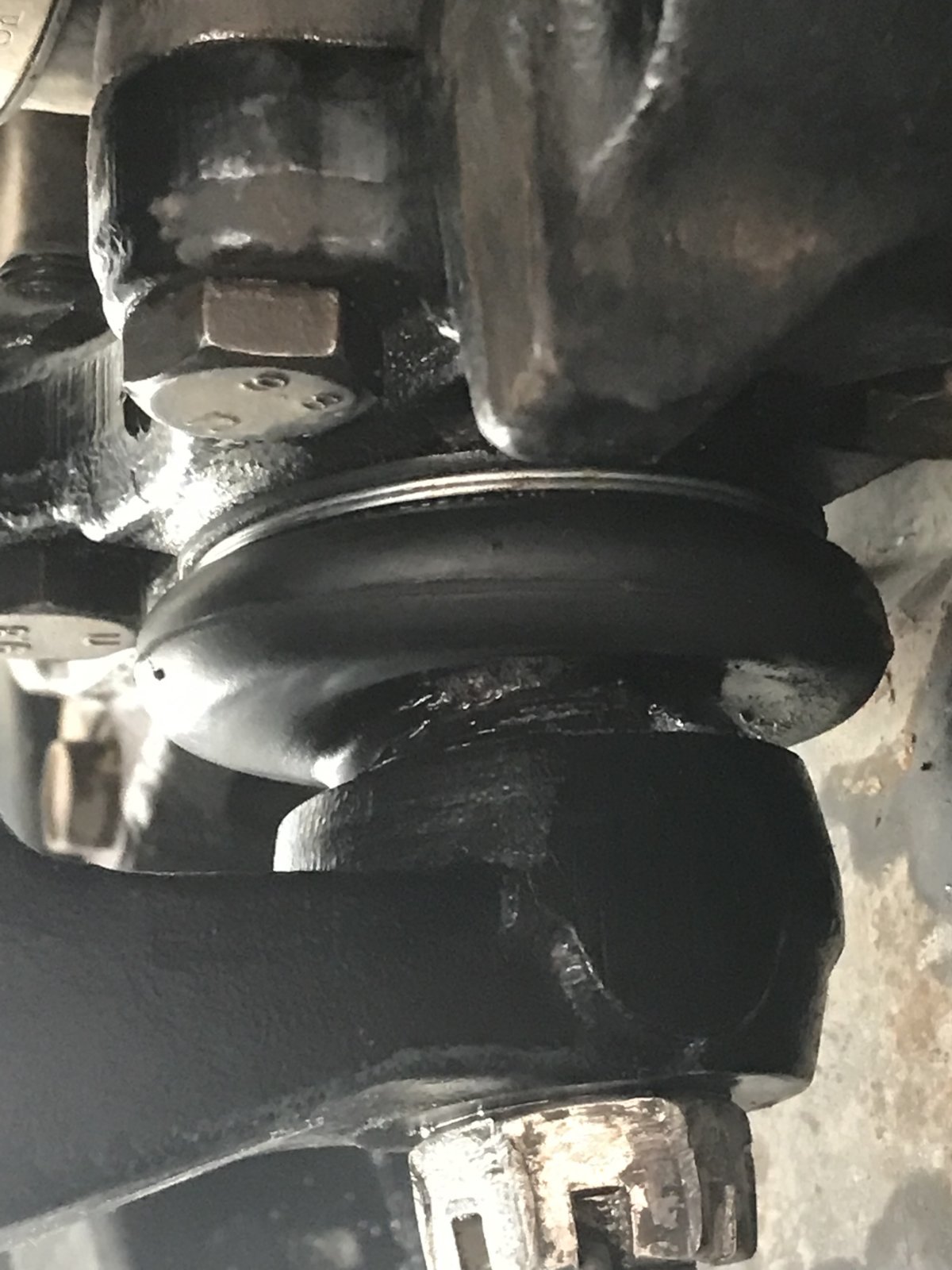

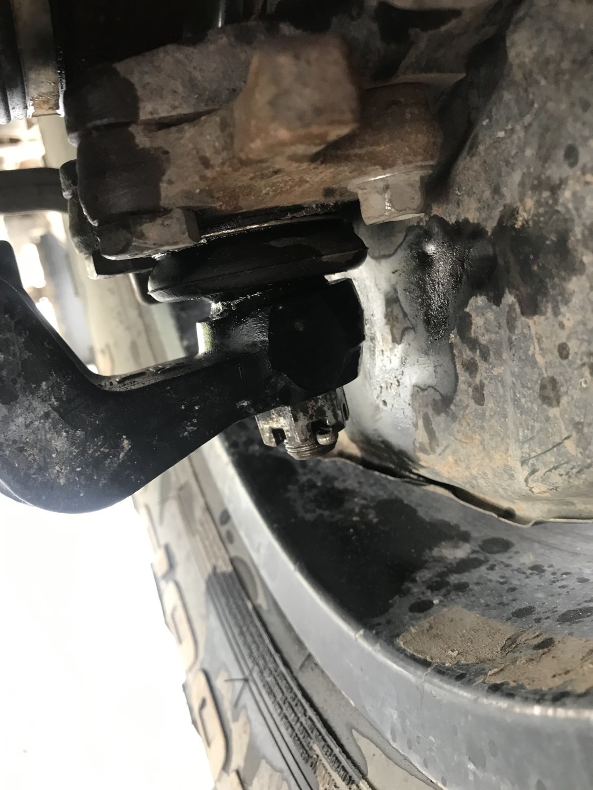

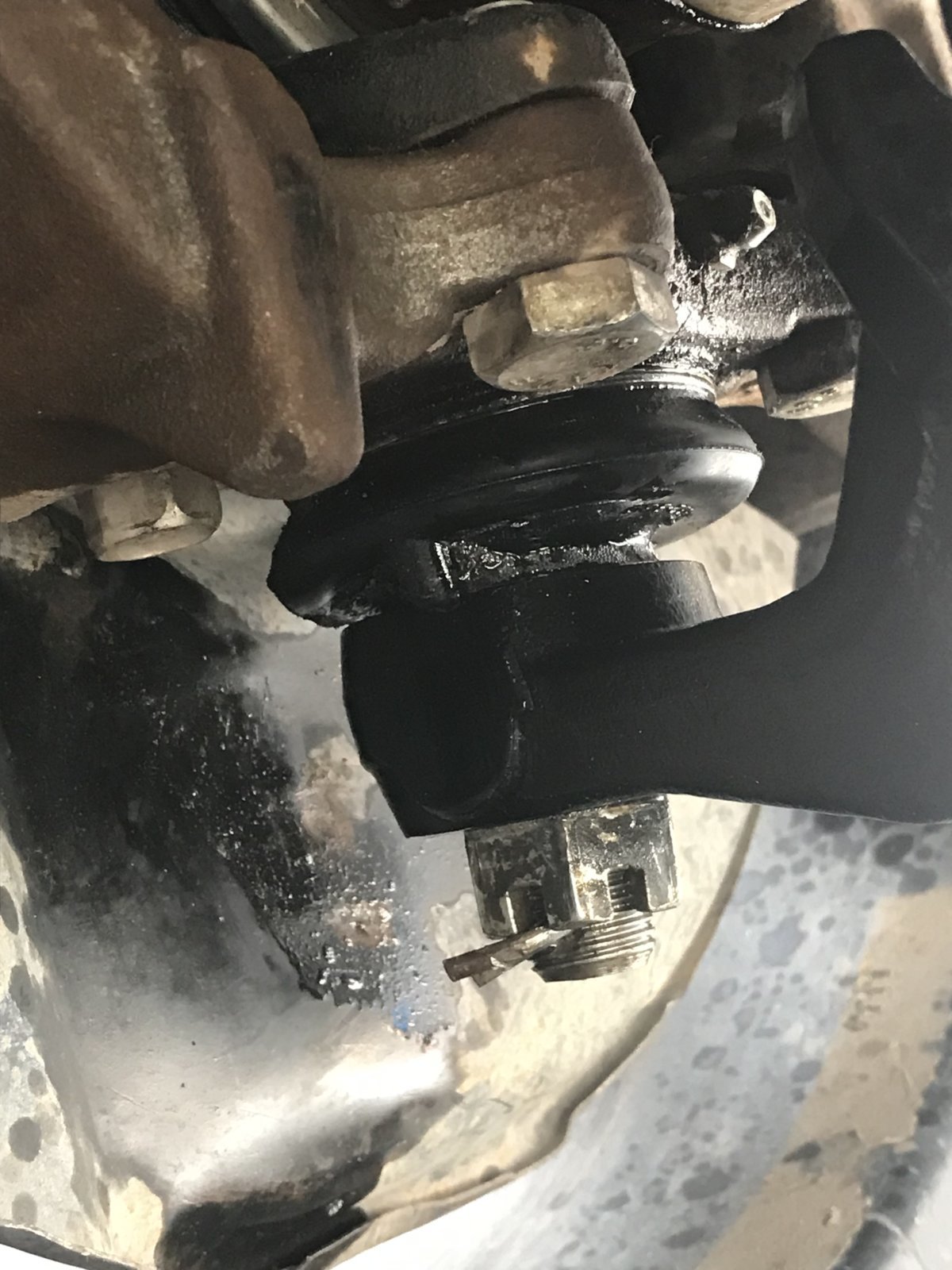

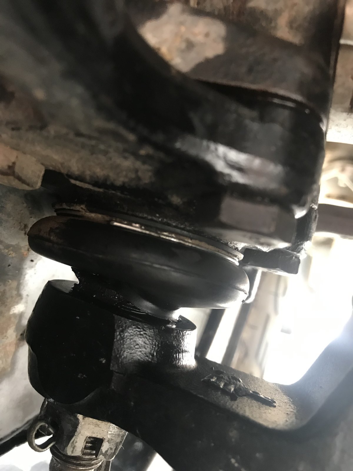

    So we've pinpointed the sound, its coming from the right side only, and only when I turn the wheel to the right. It sounds like its coming from the ball joint and/or maybe the joint where the tie rod comes in (sorry Idk exactly what everything is called). The boot on the ball joint doesn't seem to be sealed well at all, the other side one is better but not perfect. Is that a sign I should replace it? Ill add pictures of both.
    My right CV is loose and the boot is ripped, the left side is much tighter, but the boot doesn't seemed sealed on correctly. There is also a tear on the left side steering rack boot i think it is.

    Those pictures are all of the ball joints yes
    my main concern is the ball joint so I only attached those pictures.

    Well, I see one of the LBJ has a zerk on it, so deffo not OEM.
    bolts look like standard grade 8 hardware, so dunno if that's how it was on the 1st year models.

    That is definitely not how the first year models were. There’s a mix of Grade 8 hardware store bolts and factory black flange bolts. And as @shifty` pointed out, the zero is a giveaway for non-oem ball joint. As a recently reformed non-oem ball joint survivor, I can assure you that you’ll want to address those LBJs sooner than later.

    Okay yeah I just threw some grease in there. The squeaky ball joint's zerk is missing could be part of the problem. I'm gonna take it to a shop tomorrow morning we'll see what they say.

    You've got aftermarket joints and unknown use bolts, a non toyota mechanic may tell you they're fine and just grease them but they'd be wrong. You need to get new OEM ball joints and bolts ASAP.
    Left joint 4334039356
    Right joint 4333039466
    Bolts (need 8 of these) 9008010066 (single use bolts only)
    Or if you want the really good bolts that can be reused get these bolts from ARP 663-1004
    Not sure if you'll do any of this yourself or if you'll be sending to your mechanic to do but lower ball joints aren't a super hard job, no press work or anything like that.

    If there's a zerk missing, I'm assuming that joint is dry, has had a shitload of contaminants introduced, and should be replaced ASAP. And clearly it's not OEM, so it should be replaced. It's almost 100% your issue. DO NOT drive around on it, you're asking for pain/collateral damage.

    back to the original topic I talked to a welder who does a lot of auto stuff and he said $80-100 In labor but he can’t do it til early September so Ill try for some other places.
