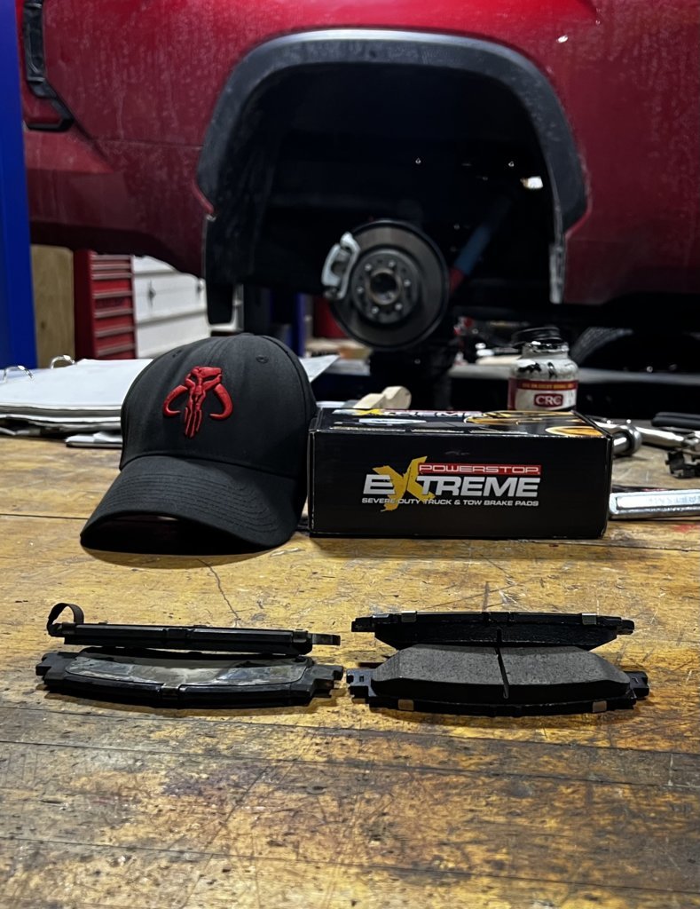

    New oem rear brakes & shocks for $270 with shipping....thanks Fred Anderson toyota
