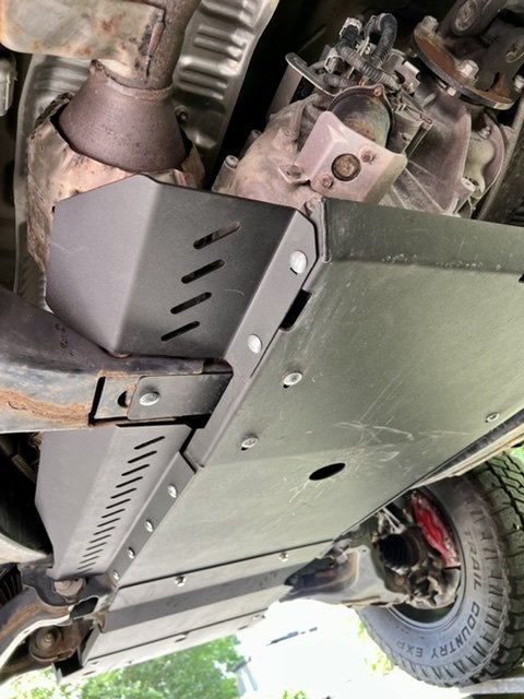

    Installed my RCI Off Road engine skid plate and transmission/transfer case skid plate with cat protection today. Couldn’t recommend a better product. 19179B27-86FE-4A27-8E2E-793DCB2E2FBF.jpg 311142FB-BF38-4E5C-9D4B-978F178ED62E.jpg

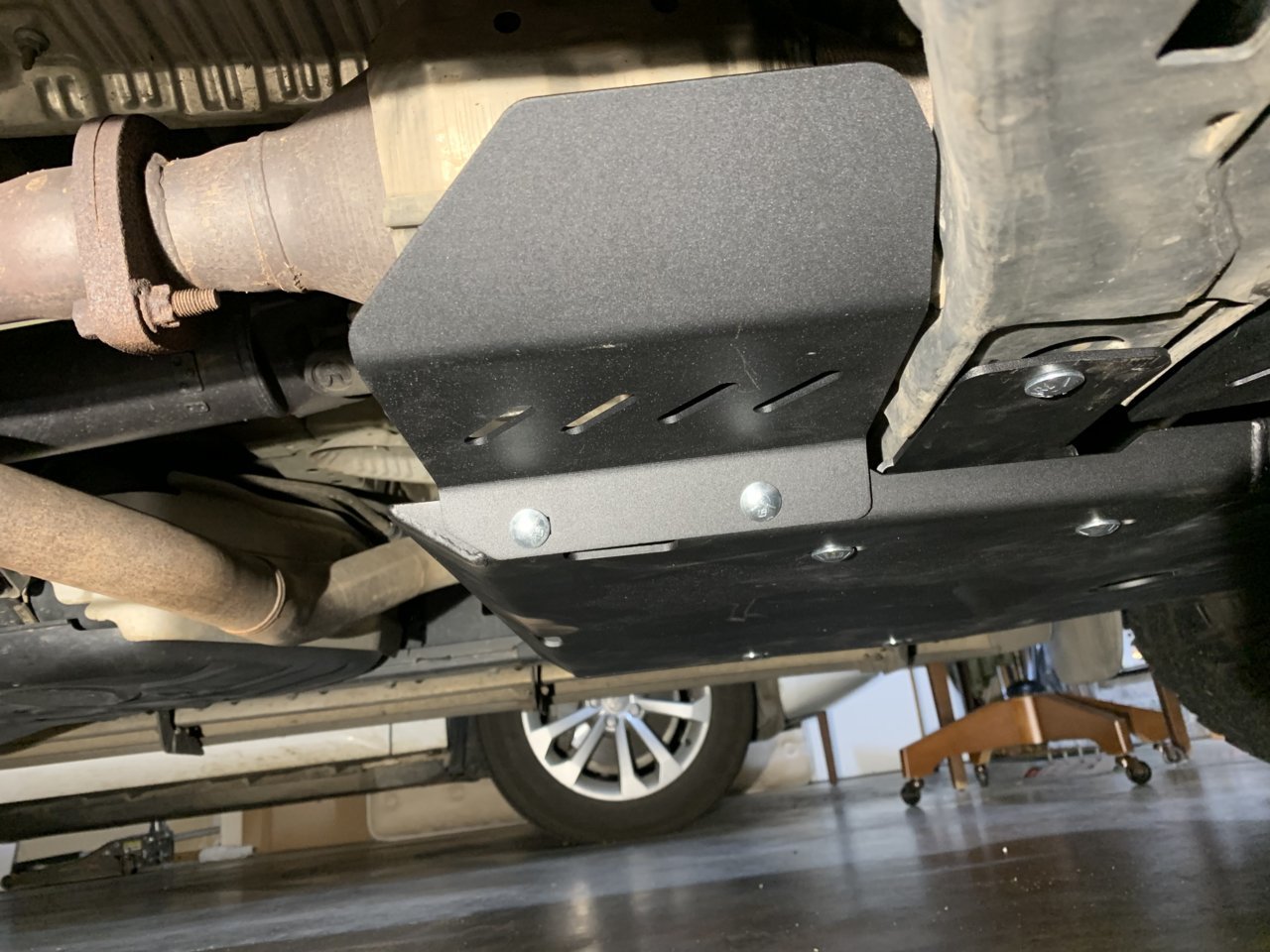

    I have them, ordered because I got free shipping with my sliders (and currently owned full skid) already coming, and the rears could definitely have better coverage.
    The most frustrating thing is, they knew about the access issue (posted in this thread I think) and said they did it to save people $50 per order. They should have gone with the better coverage at a slightly higher cost. They have the customer base and could have easily sold them for more with better coverage.
    Oh well. I see them as a deterrent and may look go fan something to add on myself in the future.
    Quality made product. Terrible terrible instructions and hardware. Their hardware never matches the vehicle and you end up with extra of some and have to purchase more of others.

    Yea...that's a crap response from RCI that doesn't make much sense at all. I think they missed the mark on this one. Oh well I'm sure other options will present themselves.

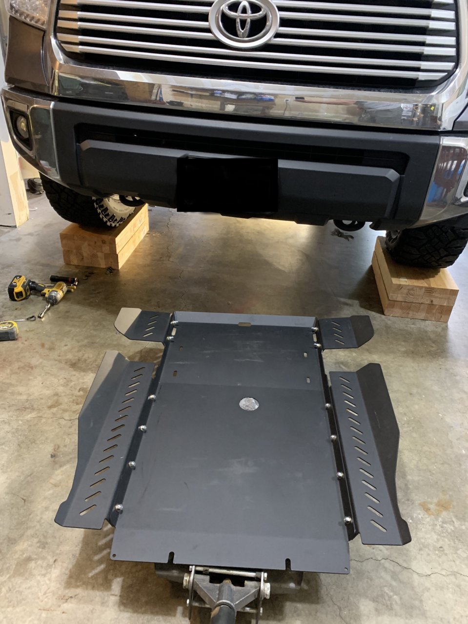

    If you do choose to go with RCI cat gaurds, hold them up in place and mark them before you drill your holes on your transmission plate. You can see in my picture here that there is only about 1/8” to 1/4” gap between the crossmember and the plate with room on the carriage bolt slots to move it forward even more to where it would actually make contact with the crossmember preventing sawzall access from that point. Valhalla plates have at least a 1” gap there. I think there could easily be a custom vertical back plate attached to the back of the transmission skid plate to block access from that point also. As long as they can’t get to the exhaust pipe in front of the rear cat you are good to go. I have to park in some “not so good” parts of town in and outside of Seattle, WA while I am working and I feel much better with this setup on my truck that is for damn sure. 5B9B3FC6-4D8F-4BB2-AF9A-7AD950845344.jpg

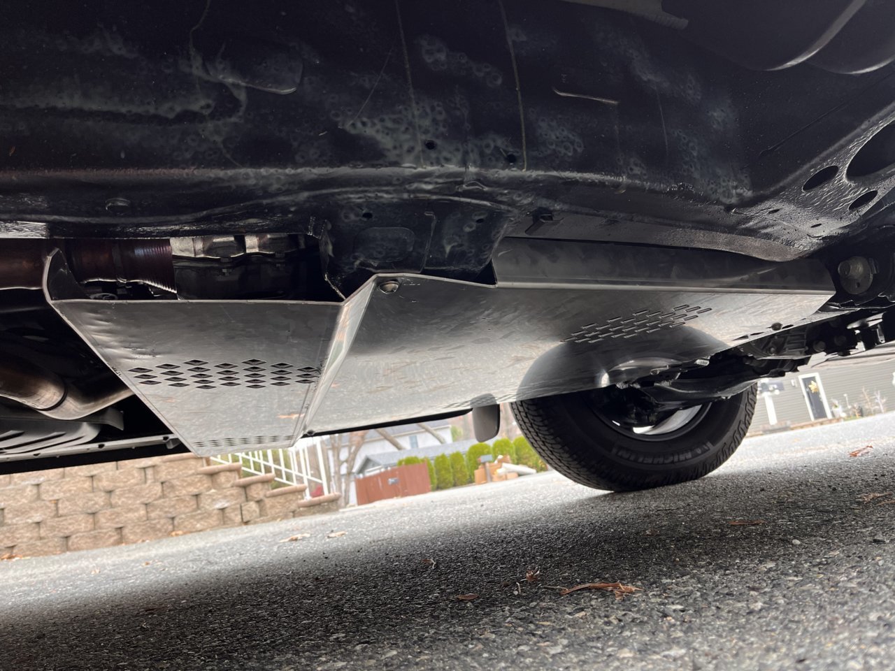

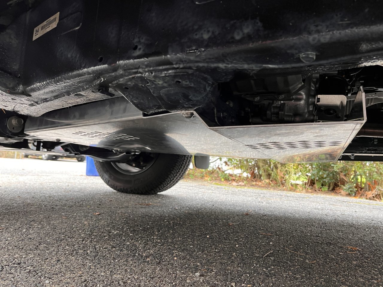

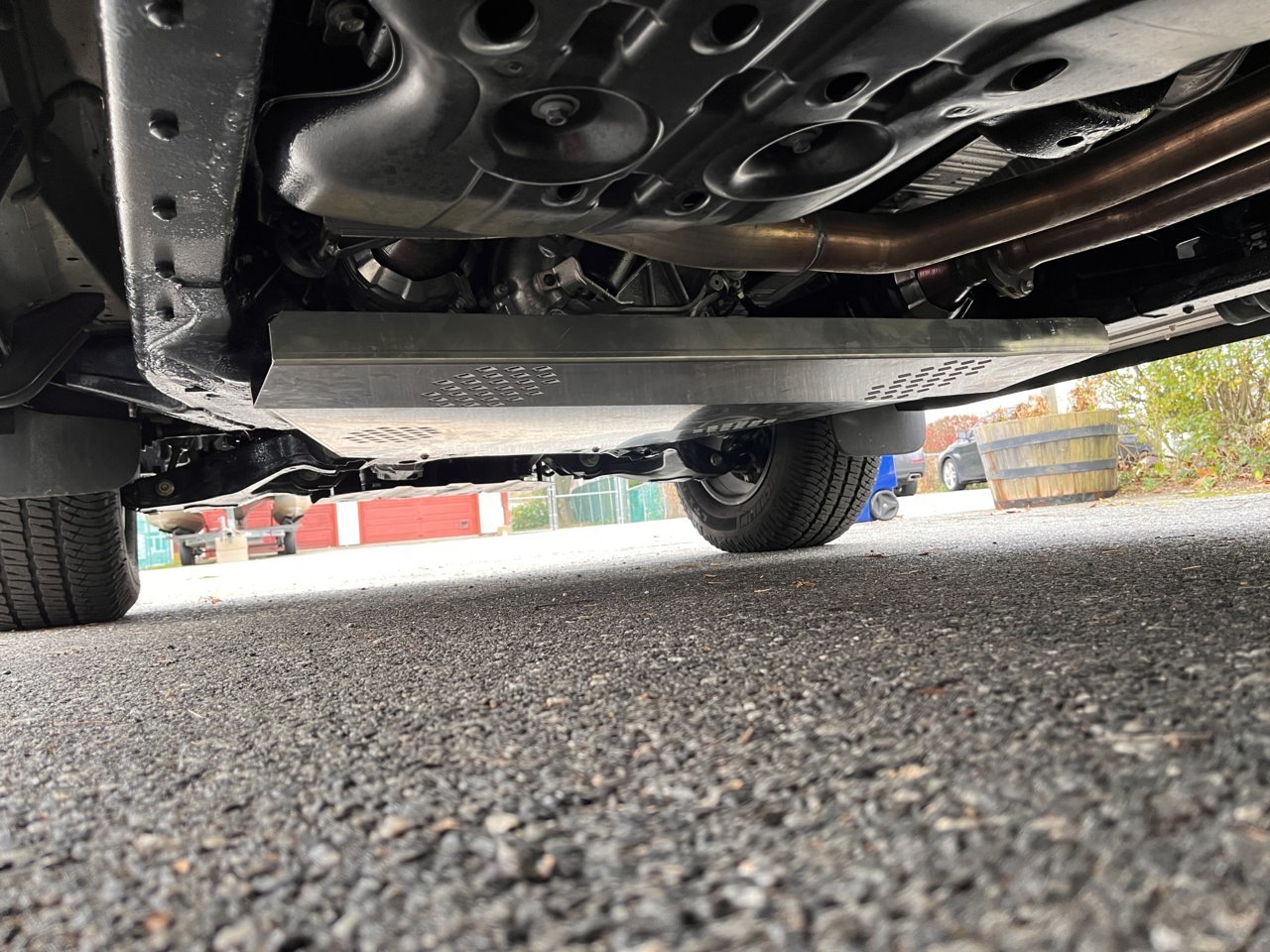

    I purchased this cat shield recently and feel comfortable with the protection it provides. The brand is TPFI and can be found on Amazon. It aluminum and is a breeze to install.

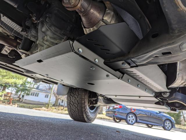

    Installed today. Pretty easy bolt on
