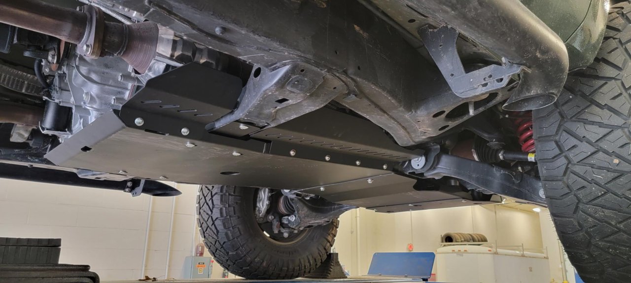

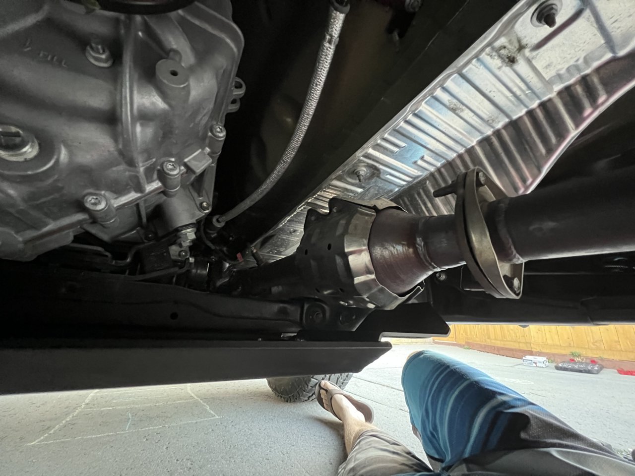

    @Lodge14 you're my hero. I didn't have the instructions and was thrown off by a few pieces.
    Overall, I think it's a nice plate. A little tricky to install. As others said, I would attach the mounting plate before installing if I did another. I ended up loosening one side of the mounting plate and detaching the opposite side so I could get a hand in to tighten the bolts. Mine was also one of the last that didn't have the holes drilled in the trans plate so I had to do that. When I went to attach the cat guards, the holes in the guard themselves were barely big enough for the provided bolts. I ended up using an allen key to 'thread' the bolts into the holes.
    There is quite a bit of room at the rear cats but the plate will still do its job of deterring someone.

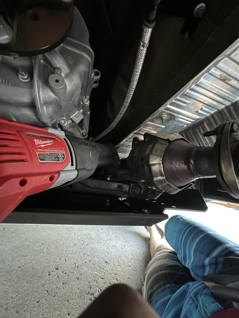

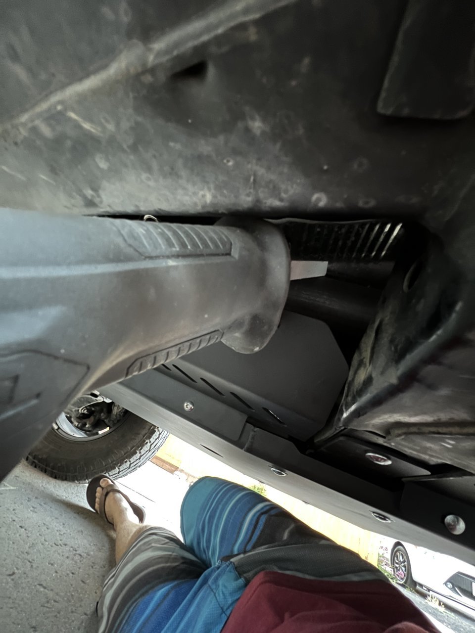

    Will it? I’m not trying to knock RCI, but from the looks of it you can fit a sawzall with a long enough blade in between the plate and crossmember circled in the pic. They’d at least take your rear cats, which is pretty much just as bad as taking all 4.
    I just wanted to see others opinions before I install these.

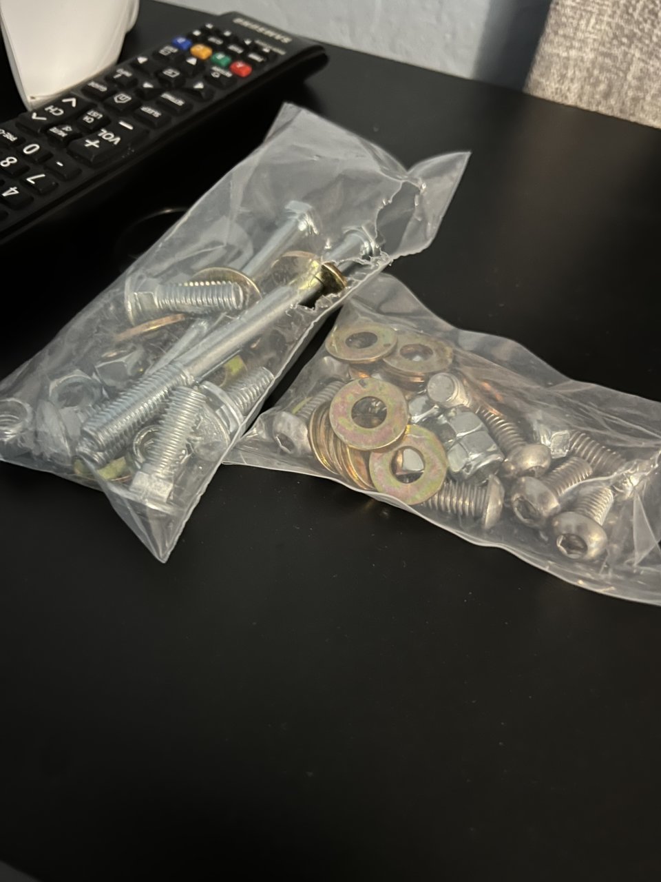

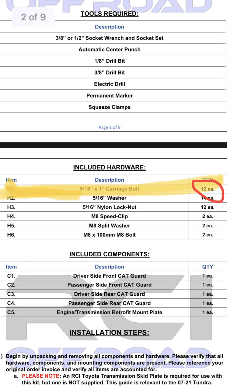

    Pretty sure RCI sent me the incorrect mounting hardware. Can someone confirm. Looks like I have 4 1” carriage bolts and 8 1” allen bolts. Instructions say should have 12 carriage bolts. The allen bolts fit, but seems wrong. Unless I am supposed to use one carriage bolt per guard then the standard bolts for the remainder. Bag on the left seems correct, had the clips in it. Bag on the right seems wrong?

    disregard i suppose. Finished opening up the guards themselves and looks like carriage bolts wouldn't even fit in the larger guards, only the allen bolts.

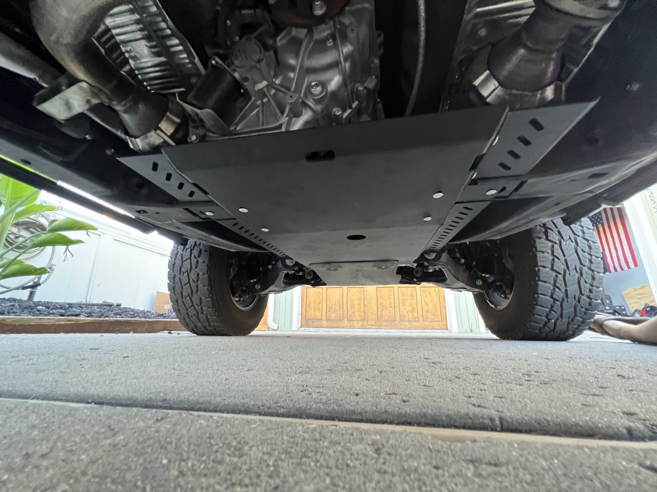

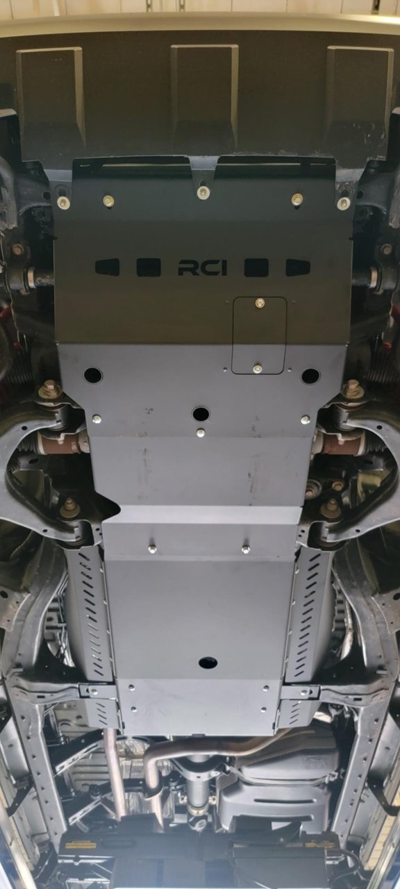

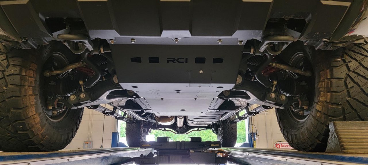

    Got mine on today. Install was pretty easy with ratcheting wrenches. Have my TRD PRO skid plate up front and the hardest part was removing the spacer sleeves the PRO skid has since they fell inside the crossmember and I had to fish them. Aside from that only took like 30 minutes, and the front hardware/bracket provided by RCI worked fine with the TRD PRO skid, with no mods necessary, for anyone wondering.
    I assembled the trans skid with the crossmember off the truck as suggested. However, left the carriage bolts loose enough so that I could adjust the skid forward and back if needed. Once I got it into place, I lowered the rear of the skid by angling it down, leaving the front supported under the engine skid. Was plenty of room to snug up the 4 carriage bolts, before lifting it into place and installing the crossmember to frame bolts…which have plenty of room to work with.
    Overall happy with the protection of the front cats, dont see anyone getting to those without removing the skids. As some have mentioned the rear doesnt seem to offer as much protection as I had hoped for. Obviously the pipes can always be further back, regardless of how far back the skids go, but I was just hoping it would be more difficult to cut in front of the rear cat. The passenger side is stupid easy, the driver side is a little tighter. I was able to get my sawzall up in there no problem. Is it a good deterrent, absolutely. If I was told to remove my rear cats without taking the skid plate of could I do it, totally.
