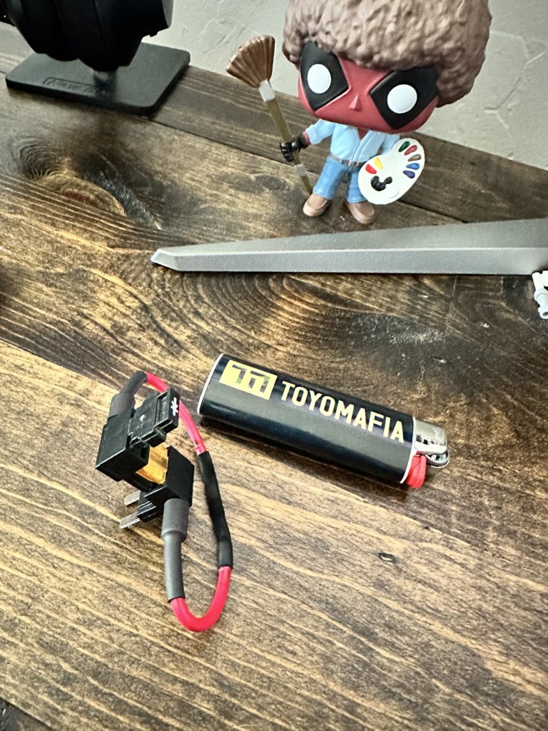

    I present… a diode with fuse!

    That's the diode I put back to test. I had that contraption when it was installed, can't find the fuse holders (to be honest didn't look too hard) lol it's just a fuse right now, I'm trickling the battery to hopefully keep it from failing after sitting for a month.
