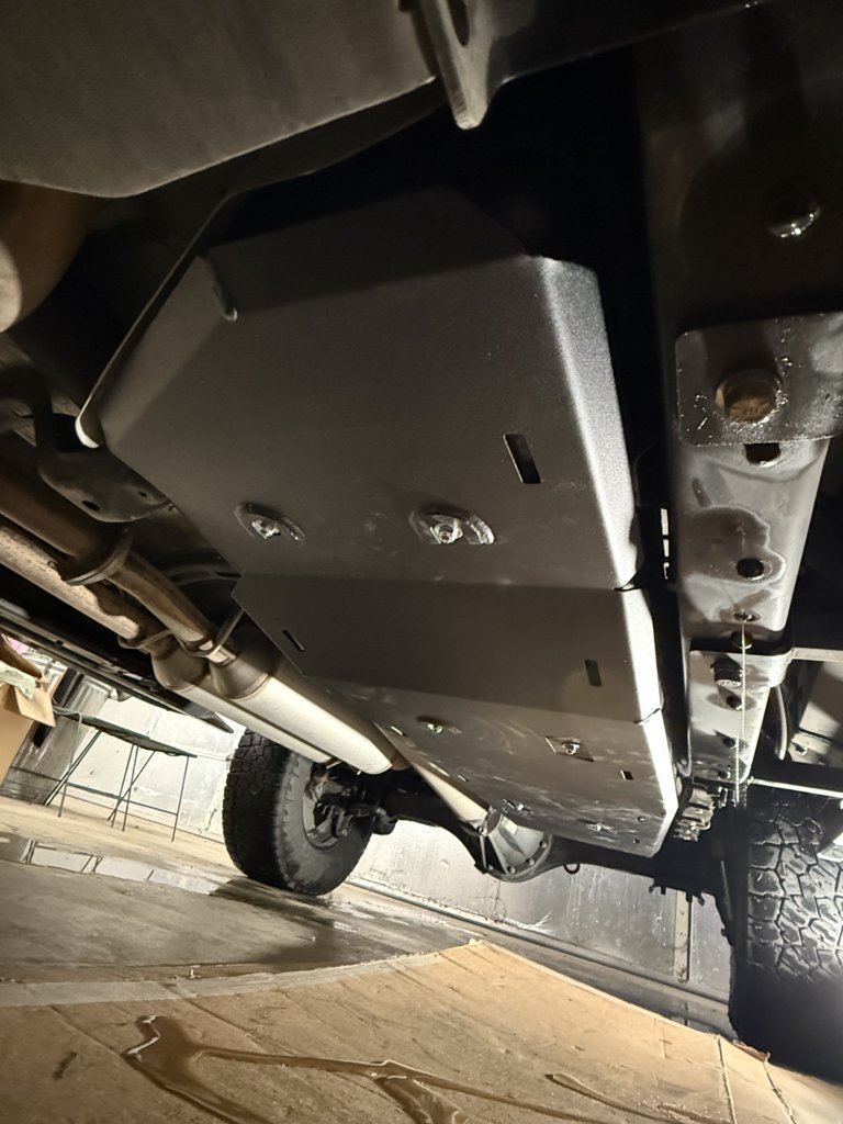

    Also installed the RCI Fuel Tank Skid Plate today (reach out to Colton at Hotshot Offroad). Pretty easy install since my truck has the straps with the studs on them for the plastic TRD “skid”

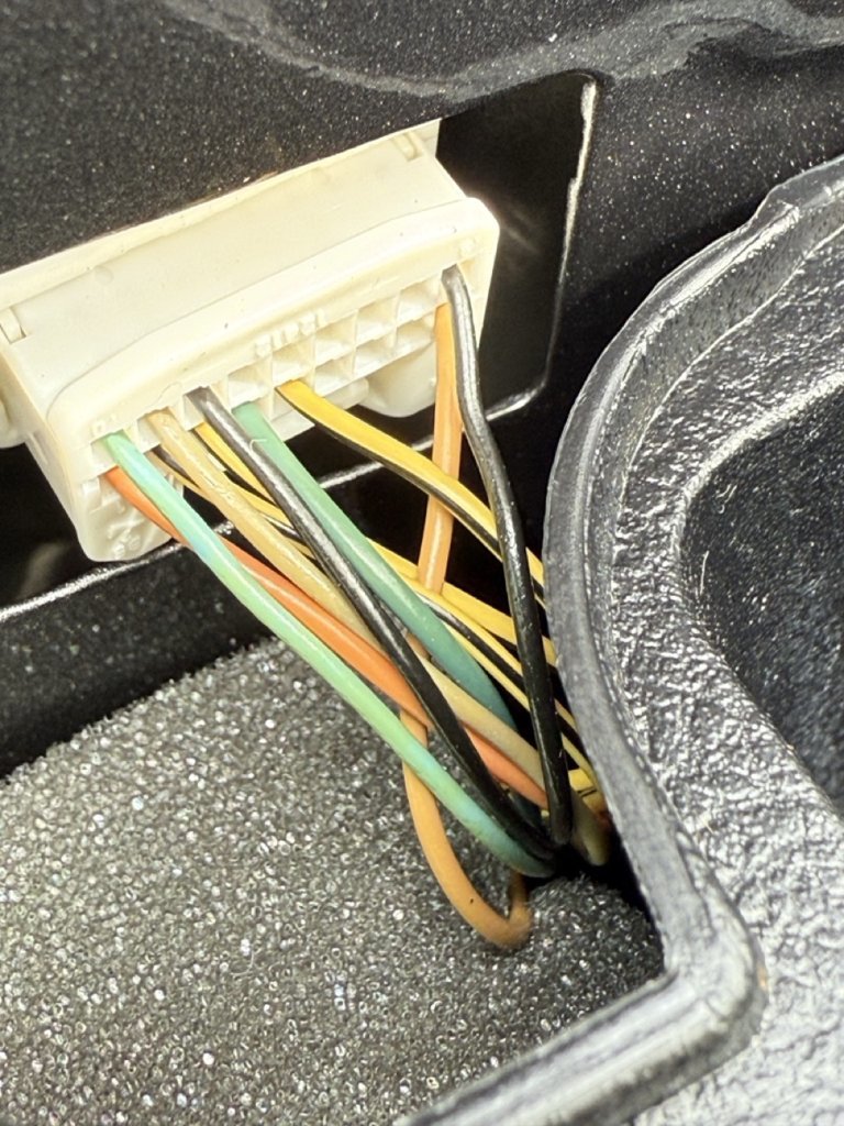

    I'm prepping to swap Platinum mirrors (adding power folding and puddle lights) onto my 21 TRD Pro along with swapping in the non-memory mirror switch. Following your post above since it's a similar situation and truck, but trying to compare my N5 connector to what you show above.
    See pic below for N5 at my driver side mirror. Unless I'm reading the diagram wrong (which is highly likely) I don't seem to have wires 13 and 14 for Auto Dim -/+. Any idea why my connector would be missing these - your diagram would indicate they should be there from the factory. The colors also are different than the diagram states, e.g. Pin 2 is Y-B vs W-B. How do I make sense of this? Or should I just add the wires as needed?

    See the column in the screenshot you quoted that says “present”? The Y are present in the connector, the X are added by me, and the grey/black are not there and not added by me during that install. Pins 13 & 14 are the ones that aren’t there and that I didn’t add.
    As for wire color - that is precisely why I always say to use the pin-out before using wire color. Over time/different suppliers the wire colors can change but the pin-outs should (99% of the time) be correct.
    I’ll also warn you that the platinum mirrors do not have their BSM circuit in the same place as that pinout shows.

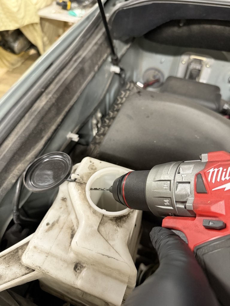

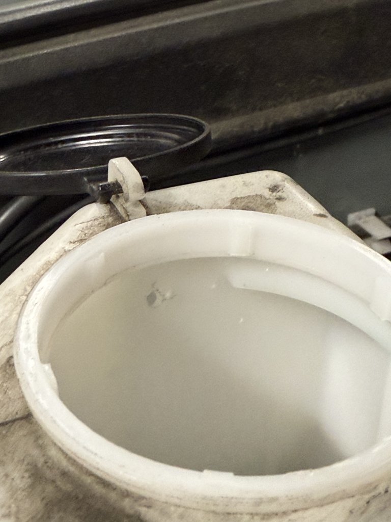

    Drilled a small (1/8”) vent hole in the inner “baffle” in the washer fluid reservoir - gained almost a quart of additional capacity.
