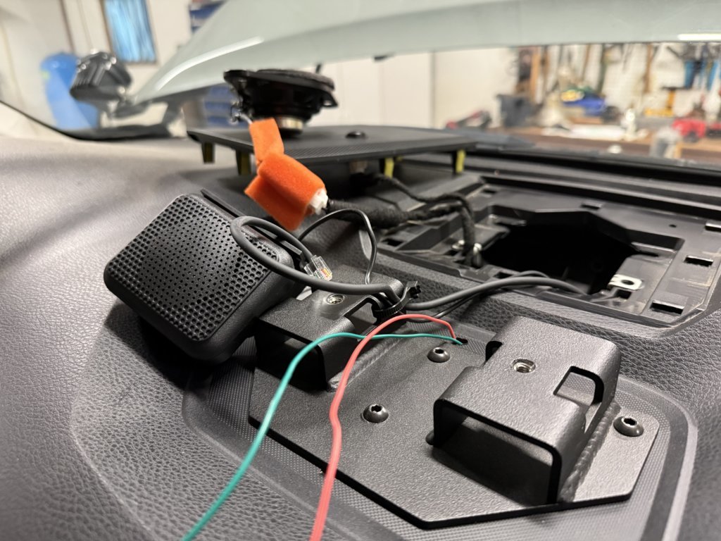

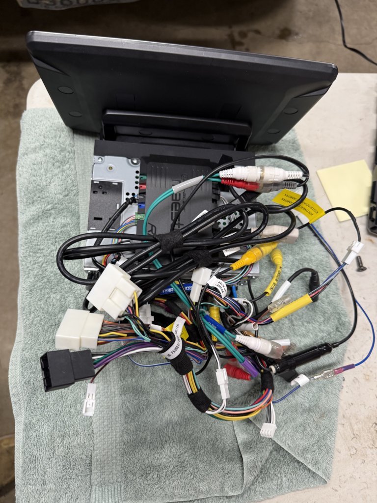

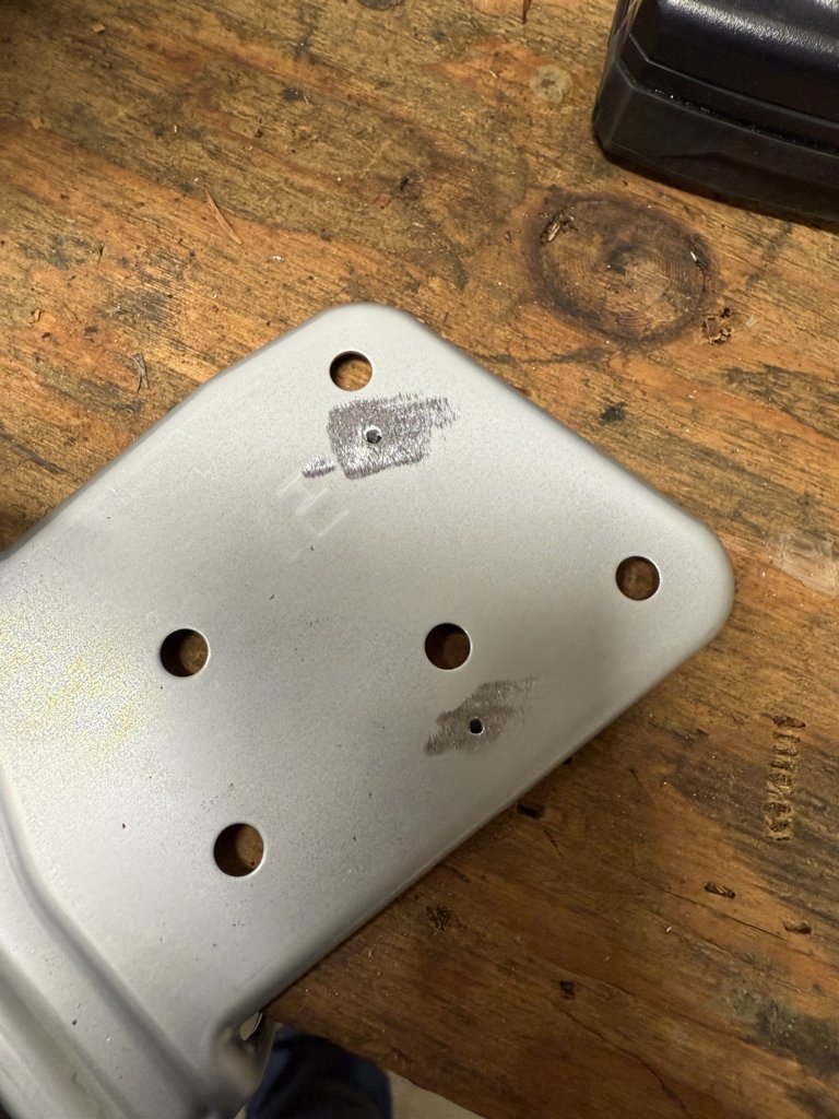

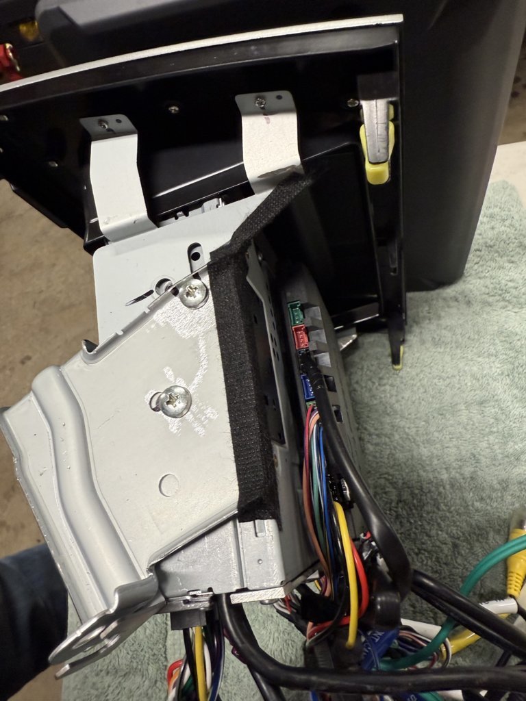

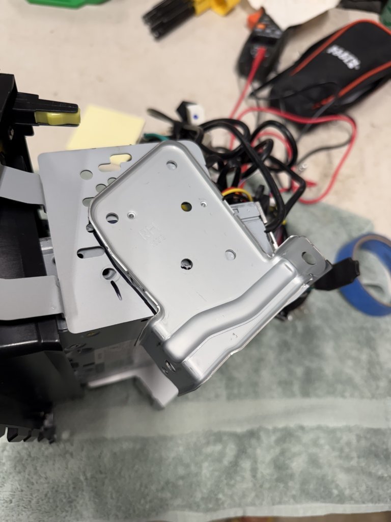

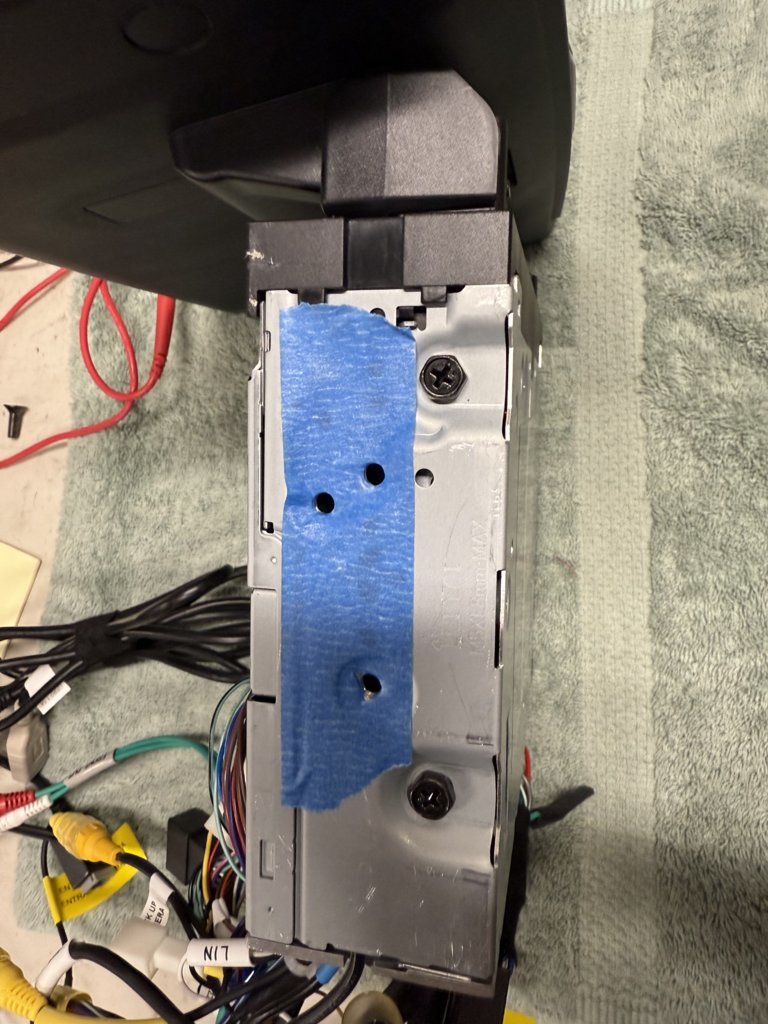

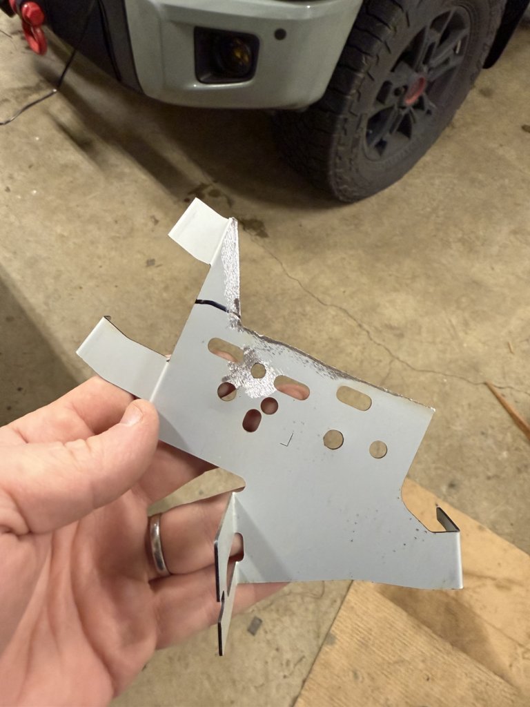

    I've been needing to tear back into the backside of my Alpine head unit to troubleshoot why my backup camera has been intermittently working, as well as routing the cables needed for my Icom radio install so that the control panel and speaker can be mounted up on the Rago dash plate. I was also having a minor "creaking" sound from the radio mount on bumpy roads that I wanted to solve. So today I decided it was time to tear into things.
    Original radio install post here.
    First, let me say: Alpine, this cluster-fuck is absolute bullshit. There is absolutely no reason you need to have all those little connector harnesses that then require additional connector harnesses to connect to the actual thing they will connect to.

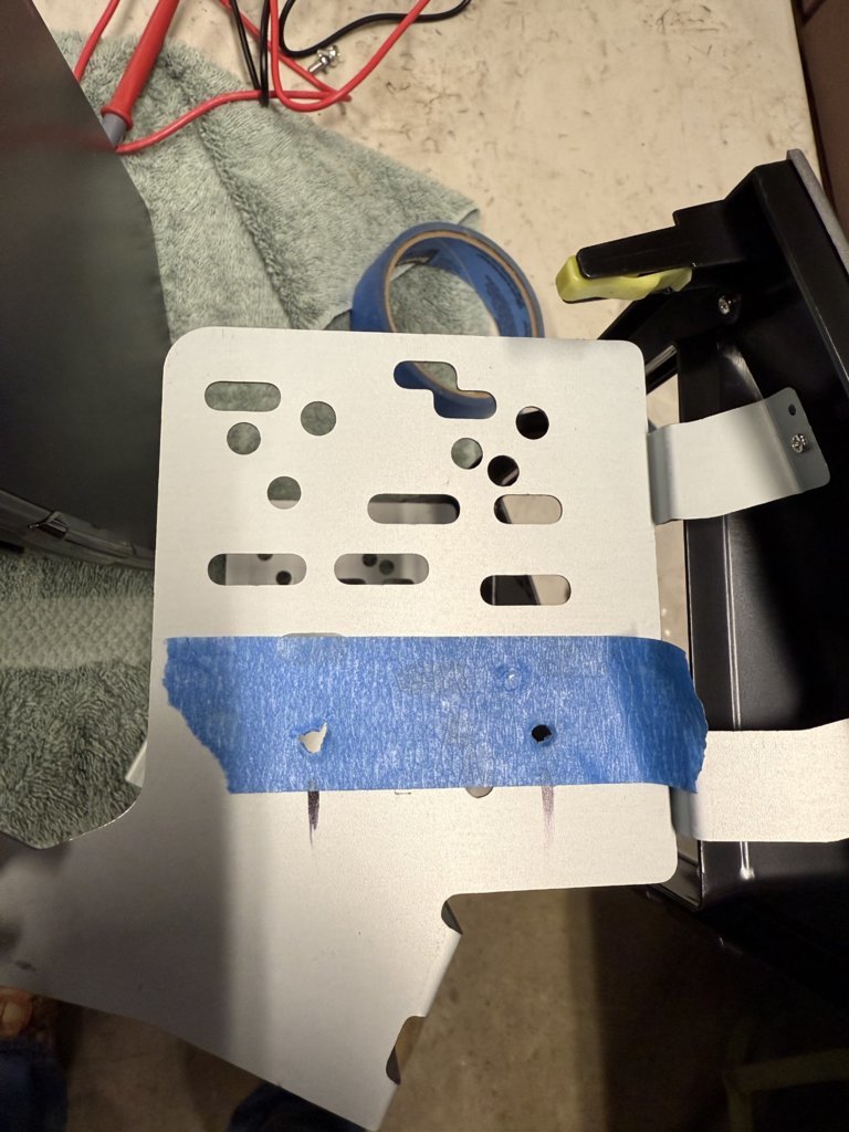

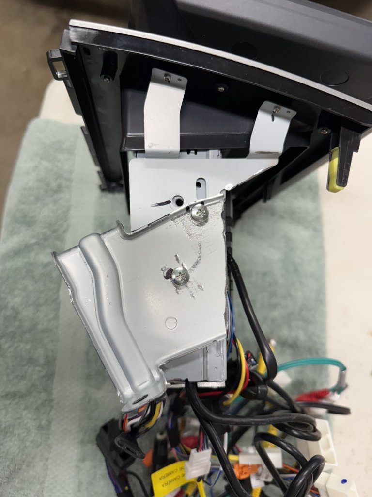

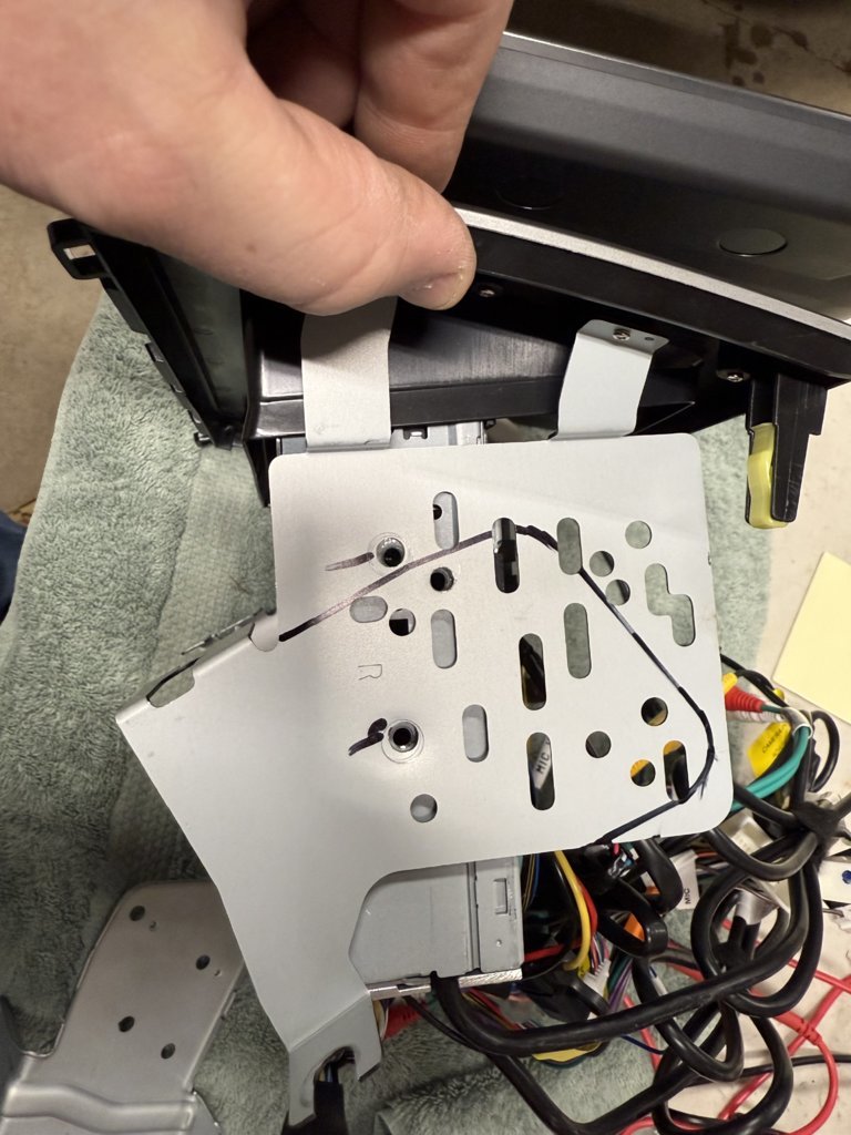

    ANYWAY, back to the matter at hand. First order of business was to strengthen the mounting interface so that the creak would go away. My plan was to use the factory head unit brackets and "sandwich" the Dasaita radio trim brackets. Of course, the holes don't entirely line up. I also noticed that the Dasaita trim stood a lot taller than the actual head unit body, and there was some risk of the wiring that was stuffed in the opening rubbing against those side walls.
    I started with the factory brackets - part numbers 86211-0C080 and 86212-0C080. I don't remember which is Right and which is Left, but you need one of each.
    I first marked a where the Dasaita side brackets extended above the head unit, then I overlaid the factory brackets onto the Dasaita ones and traced that outline as well.
    Because the factory bracket would only cover one of the existing radio holes I was using, I decided to layout a new hole in the Dasaita brackets that would sit within the outline of the factory one. I used some blue tape to do this by popping holes through the two existing holes and the new hole that matched threaded holes in the head unit. Then line that tape up on the holes in the bracket to mark the bracket.
    Then, once the holes were drilled in the Dasaita brackets, I ground the little locator nubs off the factory brackets, lined them up over the Dasaita ones so that the dash mount holes were aligned, and marked the new hole locations in the factory brackets.
    Then we moved on to a cut-off wheel to chop off excess bracket that wasn't needed from both the Dasaita brackets and the factory ones before finally mounting it all back onto the sides of the head unit.
    Then I wrapped the edges with some Tessa tape for a little protection.

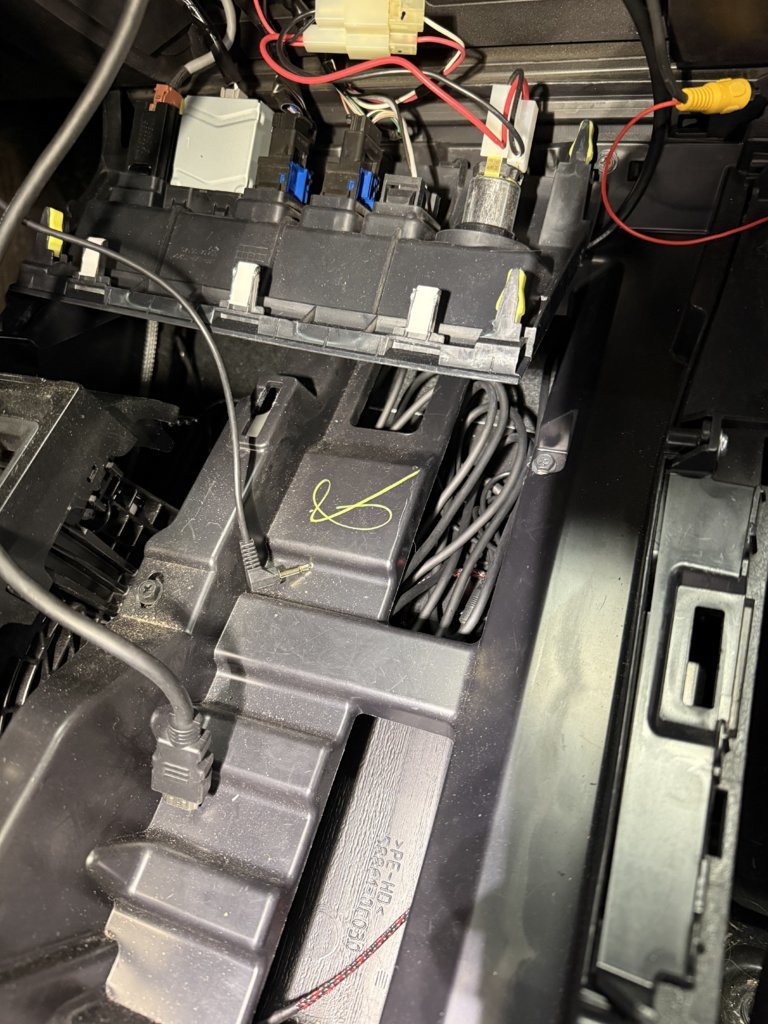

    Then, I moved on to the Icom radio controller cable and the external speaker. I popped the center speaker grill (this is also a great way to reach in and help maneuver the cables behind the head unit while stuffing it into place) and removed the center speaker temporarily. Then I fished the speaker cable and controller cable down behind the glove box and into the center console hump and left them in there for now until I am ready to finish the actual radio install. At least at this point I don't have to pull the head unit out again to route that.
    Finally, I buttoned everything back up, checking very carefully to ensure everything was properly connected, that connectors were double & triple checked for good connection, and that any "slip fit" connections were wrapped well with tape. The extra clearance from having the side brackets removed helped in fitting everything inside without pinching or cramming.
    The drive home there was no discernable creaking from the head unit, and the backup camera seems to be working like it is supposed to.
    Now I need to lay low on the mods for a little while and get some honey-do's done or I'm gonna be sleeping in my truck.
