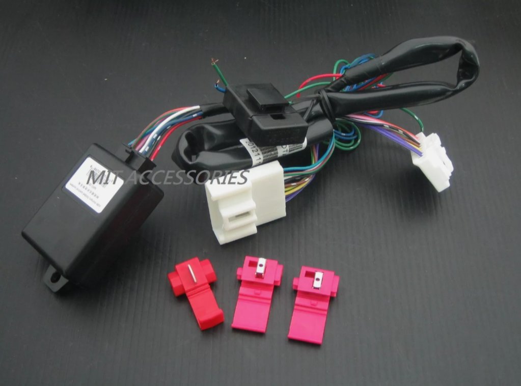

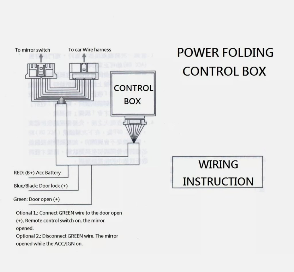

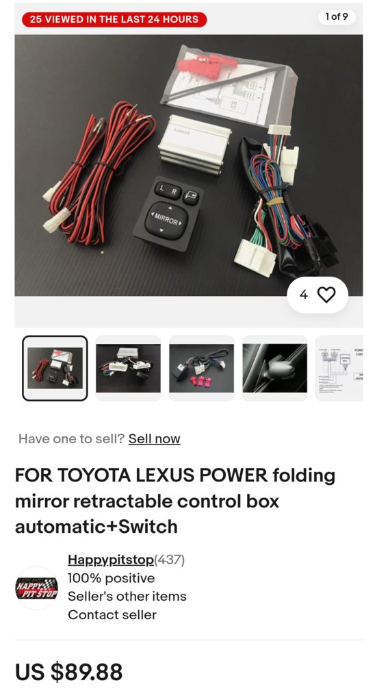

    So I found a little gizmo on eBay that claims to do the "auto fold" option. Check it out.

    I would love to know if this works. Is it clear that it applies to all years? The switch looks the same. Does it always auto-fold?

    Best thing to do is reach out to the seller because I don't know - Casey had to go a step further to manually kill his auto fold, but this little contraption may have that feature built in. You can be the Guinea pig :p

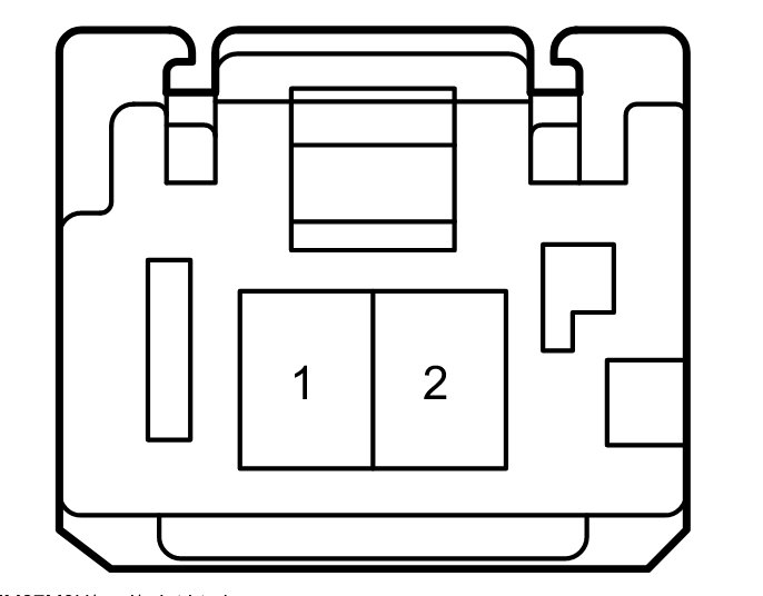

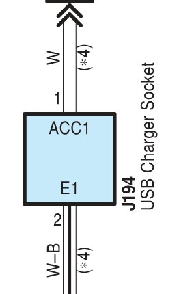

    Love the build! Question for ya:
    I'm attempting to retrofit the same USB-C connector into my 2000. I've got the plug and the connector ordered- but where'd you get the internal metal piece that crimps onto the wire?
    I'm hoping to remove my original connector and crimp the new female pins onto the original wires. There's just a positive and negative, correct?

    I assume you are asking about the actual terminals that go into the plastic housing?
    You'll need Toyota part number 82998-24290 for those. If you buy from Toyota, they will come with a ~6" pigtail of wire already crimped.
    and yes, it is simply a positive and a negative.
    Pin 1 (looking at the front of the connector, not the end the wires enter) is +12V. Pin 2 is ground.
