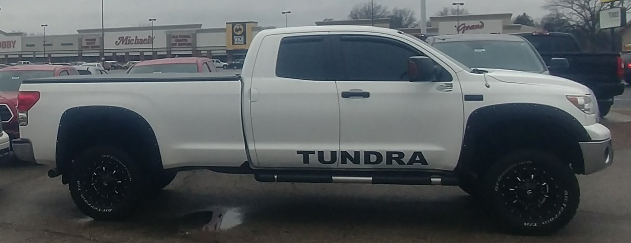

    Mnorris1206
    Mnorris1206 Super white is fast as f***
    Dec 24, 2018
    #23448
    2,509
    08 tundra
    6" lift kit 35" tires with cold air intake and exhaust
    Nice truck man .Here is mine
    I did the same thing he os looking to do before I lifted mine 6" also .It makes a truck look good being level for sure .
