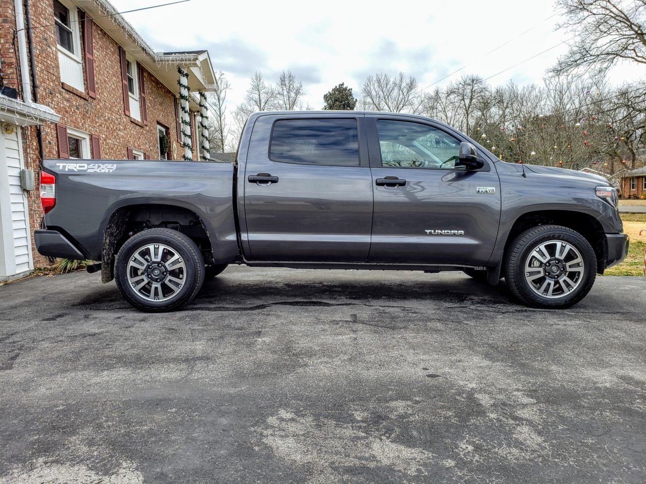

    Santa, aka the wife, was very good to me this year. Finally got me into a Tundra! 2019 Toyota Tundra SRD!
    I have a question on the best routes to leveling this beast. Eventually (as in 3+years) I will be putting a good size lift on it. But for the meantime I would like to level it out. Would I need to do a 2" front block to level it out? Budget is a concern at the moment. The truck rides great now but I cant stand how it is unlevel. Any insight you have would be great! Blocks or no blocks? Price comparison? Best bang for your buck?

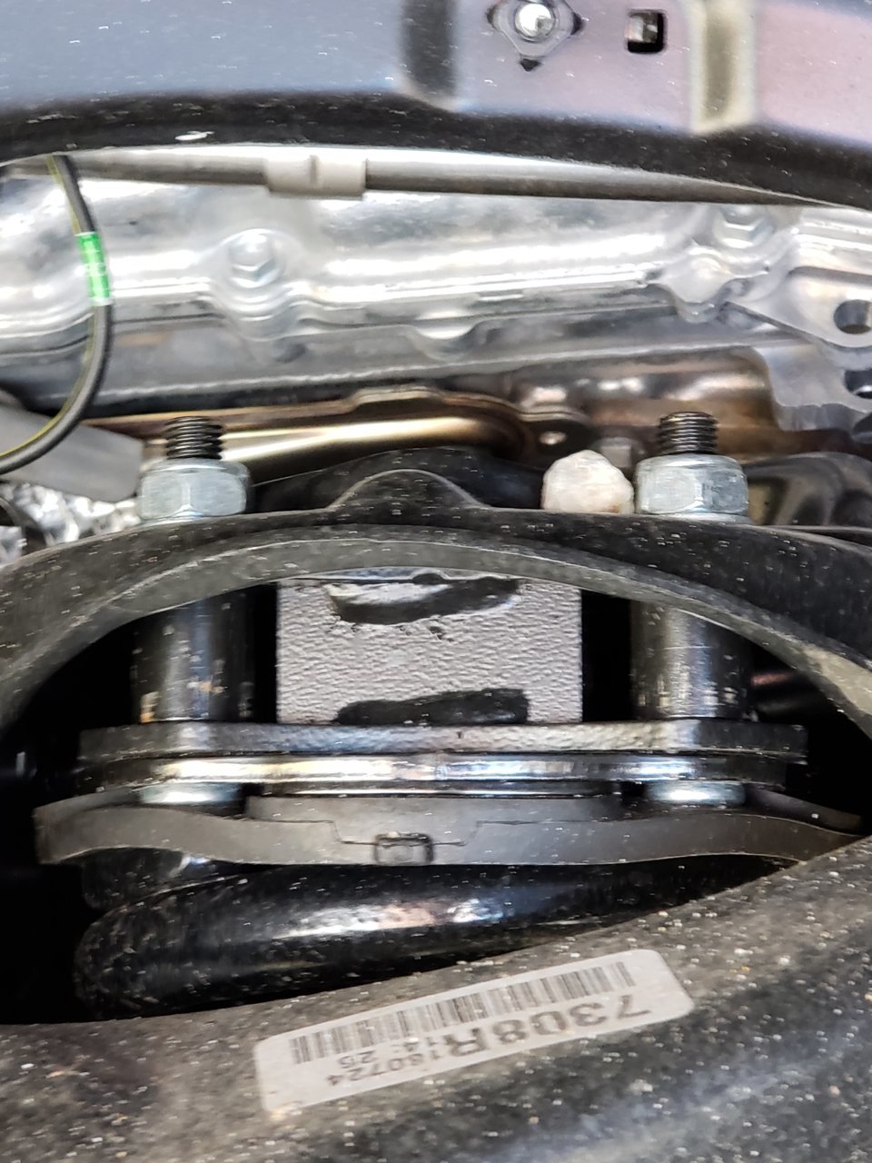

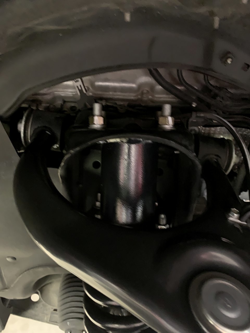

    Here's my spacer on a 6 inch lift. My truck rides super smooth.
    MJ_19Tundra[OP] likes this.

    Simple is great! I've got a 6 and 7 year old so for a few years I ain't gonna dump a bunch of money into it. Just some minor things here and there. Plus I'm keeping the stock wheels since the tires are brand new. The way I see it, I want to put a 6 inch suspension lift later on, so why not put 2" on the front to get by until I can dish out the money for suspension and wheels n tires.
    What blocks do you have on yours? You gotta pic of the whole truck?

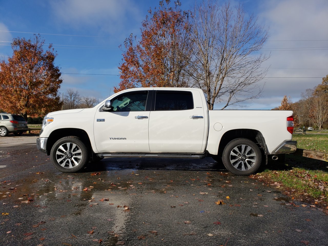

    20181116_092507.jpg 20181116_092541.jpg I went with a rough country leveling kit. Brought the front up 1.75". Can't tell much difference in the ride.

    Sure, look in my media gallery.

    You got a 6" in the front and 4 in the back?

    Exactly what I'm looking for! Did you need an alignment after that??

    Yes. It was $470 for everything at a local shop here in NC.

    yes, but I have had to add a 1 inch rear shackle to my lift due to the Toyota springs being soft and I tow often.
    Clarification-My Procomp 6 inch lift uses a 3 inch block and an AAL for the rear.

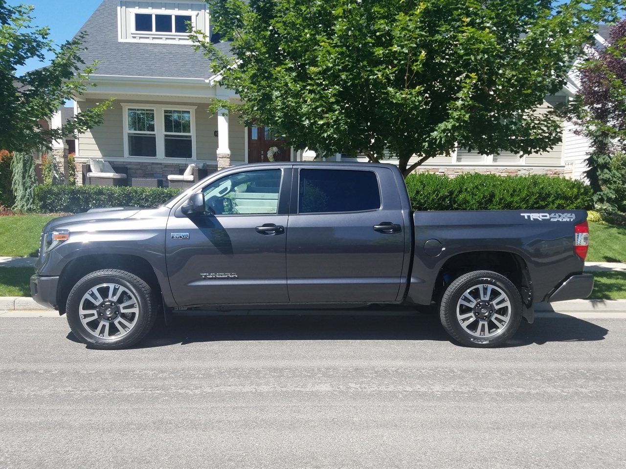

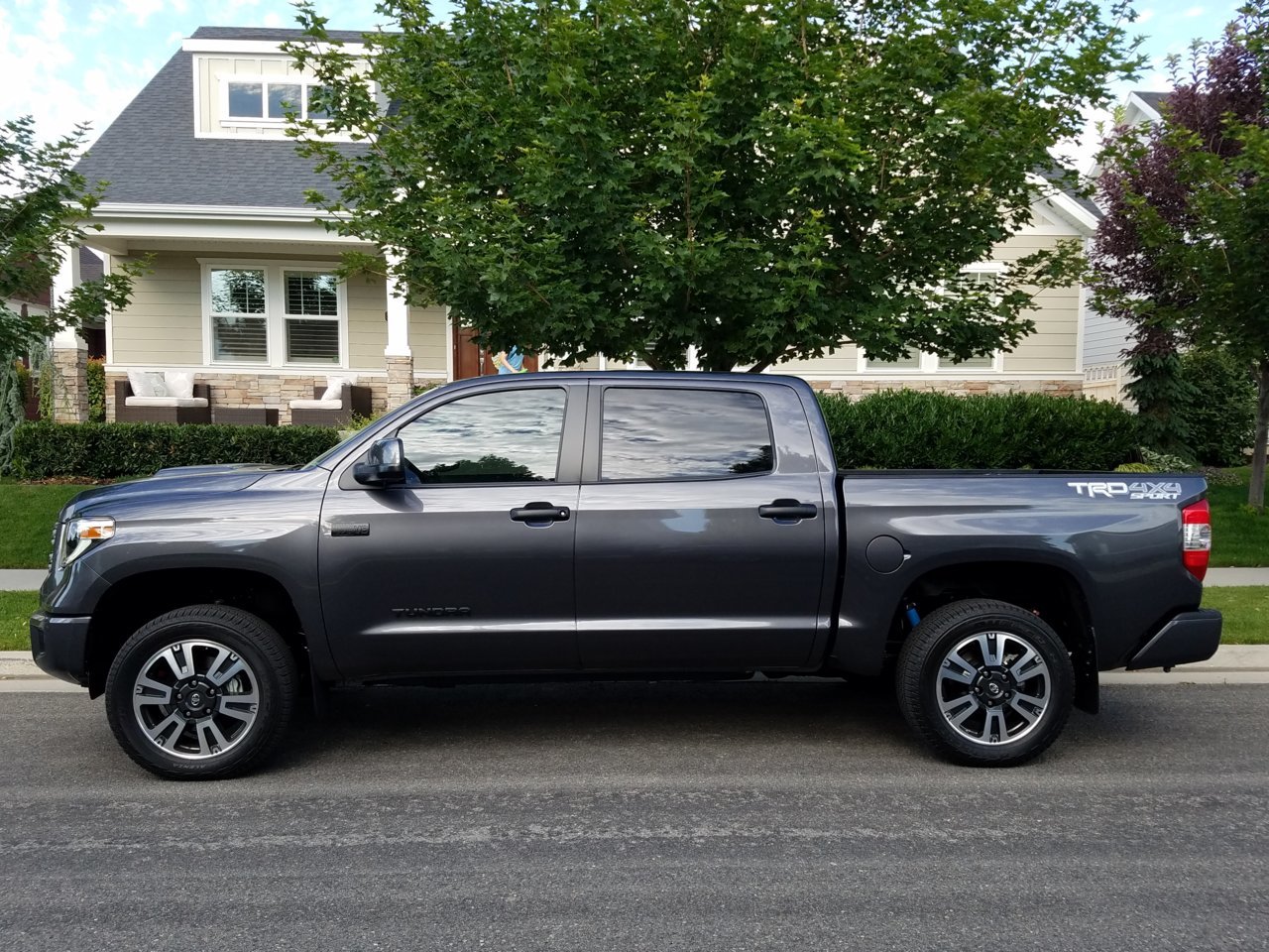

    Congrats! Nice Truck there sir!!! I've gone with the Bilstein 5100s up front to level it out, m iddle setting for now. I will increase to the top setting and install Toytec shackles in the rear once I install new rims and tires.20180624_110922.jpg 20180703_083343.jpg
