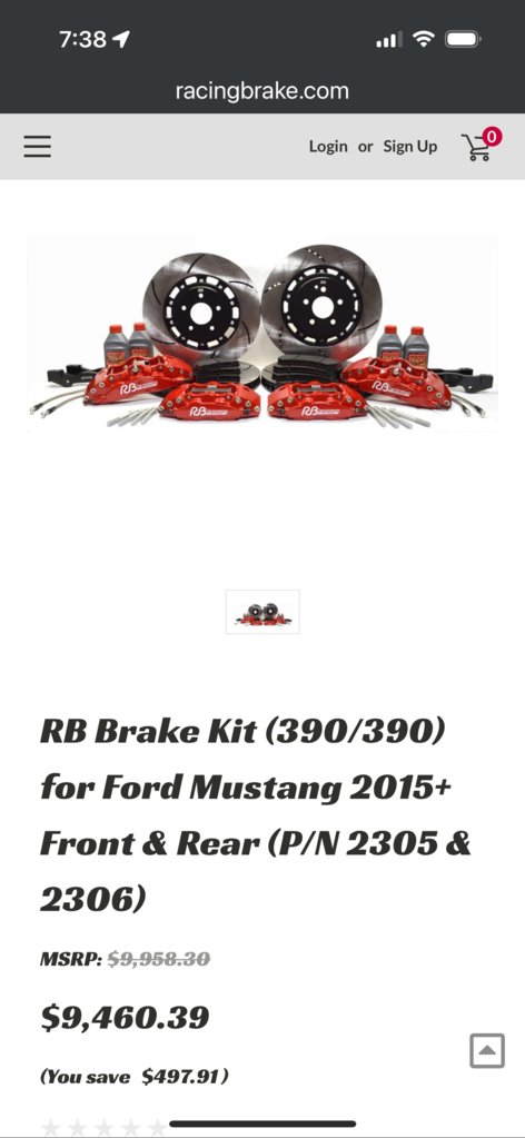

    Just for shitsngiggles I checked pricing for the Mustang...
    Glad they are on sale. :rofl:
    The Shelby GT500/350 complete brakes are 4400.00.
    I just need the rears dammit:D
    2mchfun likes this.
