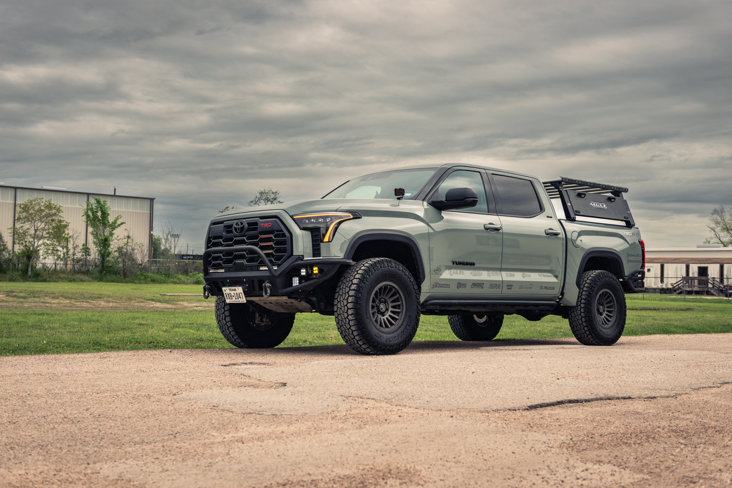

    Katy, TX
    2022 Tundra SR5 TRD Off-Road Lunar Rock
    Incorrect. I have Rotoras on mine. Running a set of ICON Recon 17X8.5 +0 offset wrapped in 37X12.50R17 Venom Power Swampthing A/T tires.

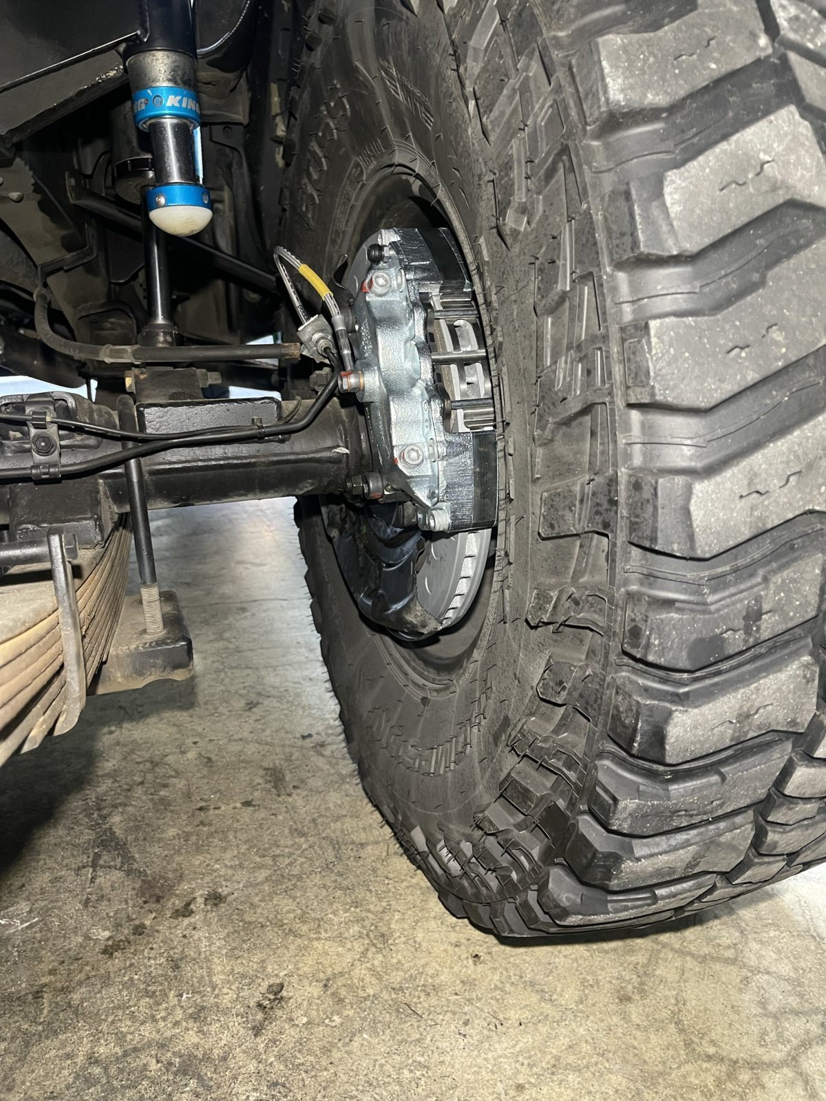

    I have a set of Rotora front (6 piston) and rear (4 piston). Call them and ask for Loren. He'll take good care of you.

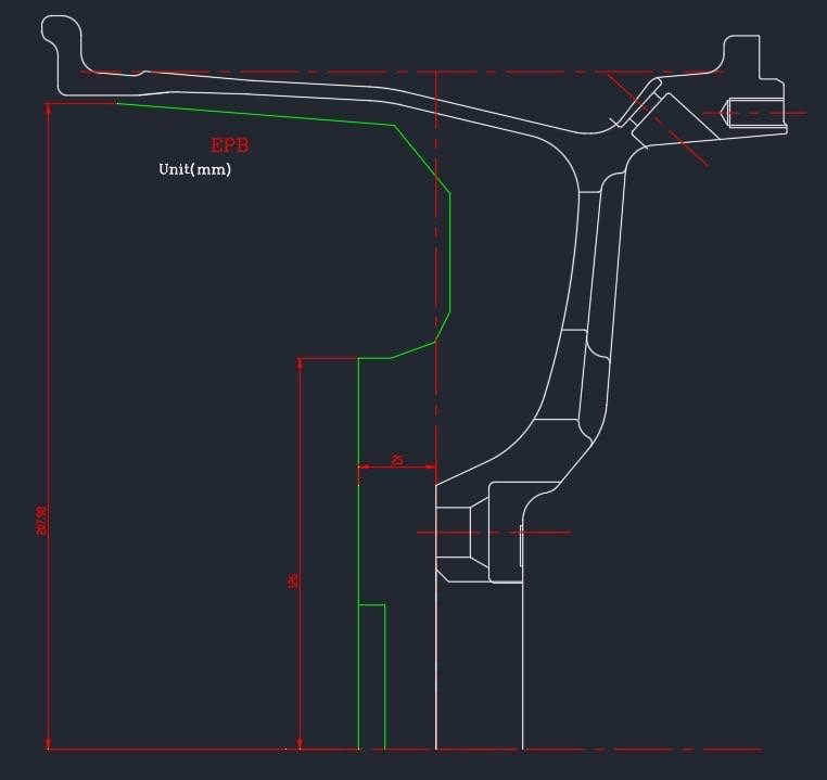

    With 17" wheels, it really depends on the offset and concavity of the wheel design. You'll be able to stick weights behind the spokes if you're running a 0 offset concave wheel. There is less space or clearance behind spokes as you move towards positive offset territory. There is definitely no space between the wheel barrel and the caliper. I've taken my truck offroading several times and I've had zero issues with pebbles getting stuck in between the calipers and wheels...if that's a concern.

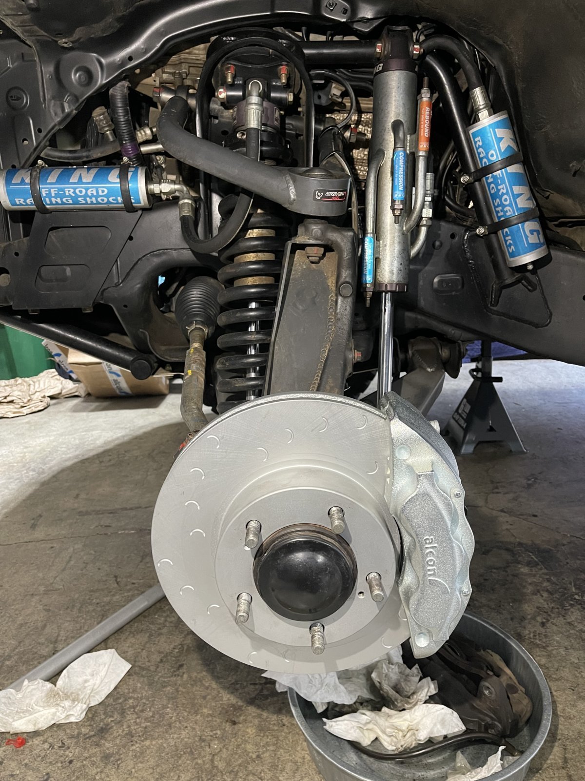

    Alcon will make the rear for this gen as well im sure. I have the full front and rear Alcon kit. I had the fronts first to test it out before the rears and I can say adding the rears is a significant difference. Im also on a 17" wheel.
