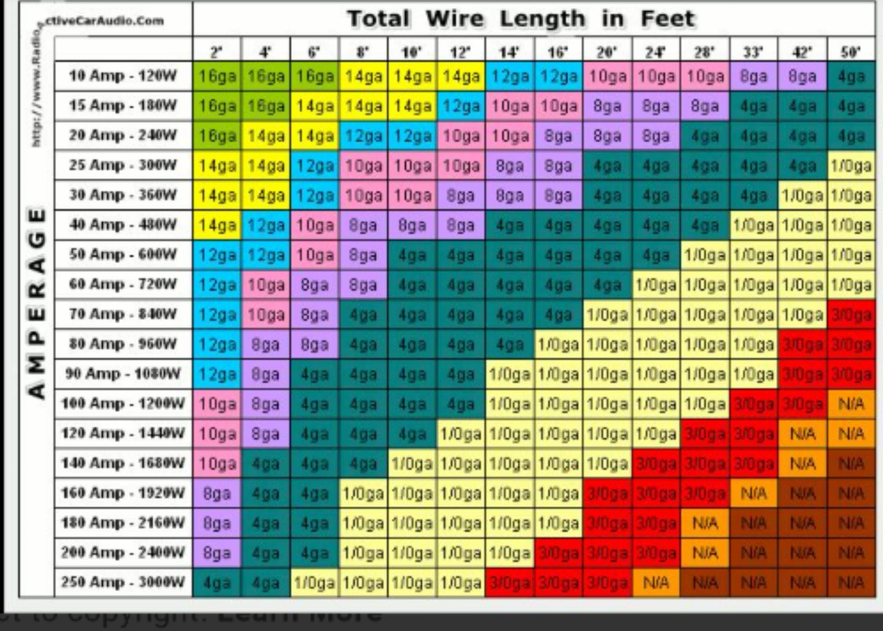

    Don't base it off of "watts" that they claim, base it on the fuse ratings, which is the amount of maximum current the amp can draw. It's more accurate information, meaning it's physically a representation of the amp's ratings, not a "claimed 1000 watts!!!!" Lol!. You can never oversize your wire and have an electrical malfunction, whereas undersized wire can cripple performance. All charts for wiring are based on length and current, with watts being a product of the voltage and amperage (current). It should simplify it for you. Screenshot_20210322-134917.jpg
