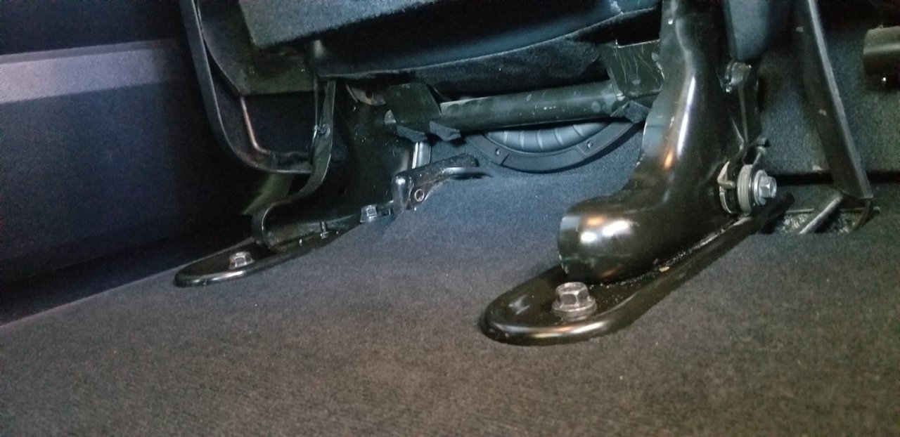

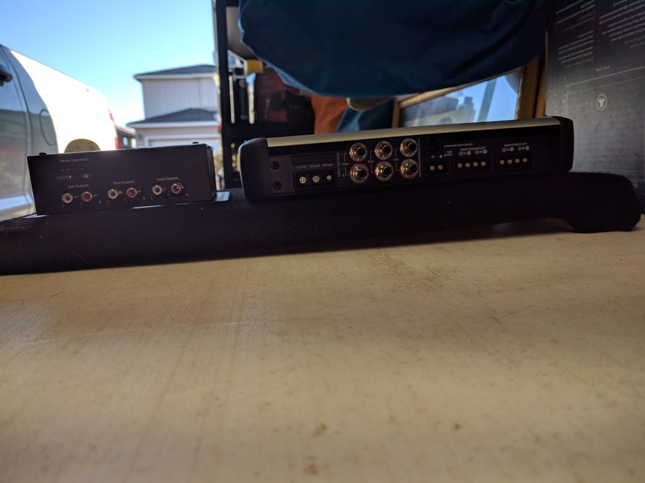

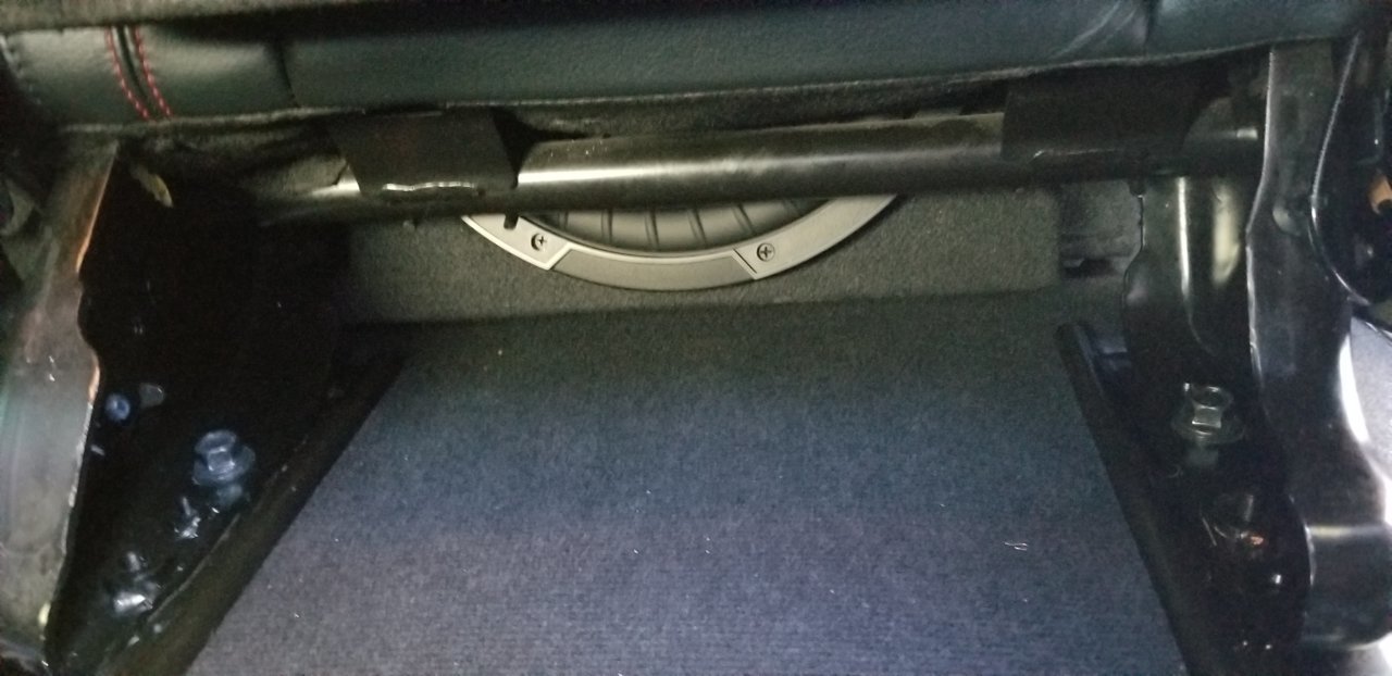

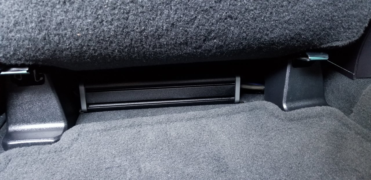

    Update
    • Subs, Sub Enclosure & Mono Amp installed.
    • Front/rear door speakers to be installed 4/2.
    Question...I noticed the installer placed the amp under the driver's seat on top of the ac/heater floor vents. Do I need to install a riser / amp shield to allow air flow under the amp to the back seat area? If yes to riser, any recommendations to an aftermarket product as I'm not seeing any currently?
    TIA!
    Rica25 likes this.

    Daniel
    Sacramento, CA
    2017 White Tundra SR5
    yes, have the shop make an amp rack. Super simple, a piece of mdf, with 2 feet on one side and wrap it in carpet.
    sj3KBbS5NhtCHE1vLoW3Qp2nVku3PU2BSLsH8GTR_5c545cd3d27961648cb149a9c3dc353195f4c032.jpg

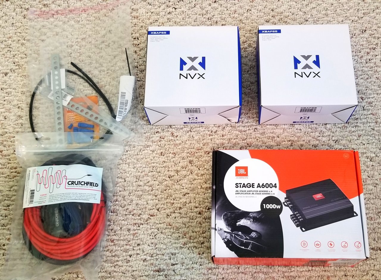

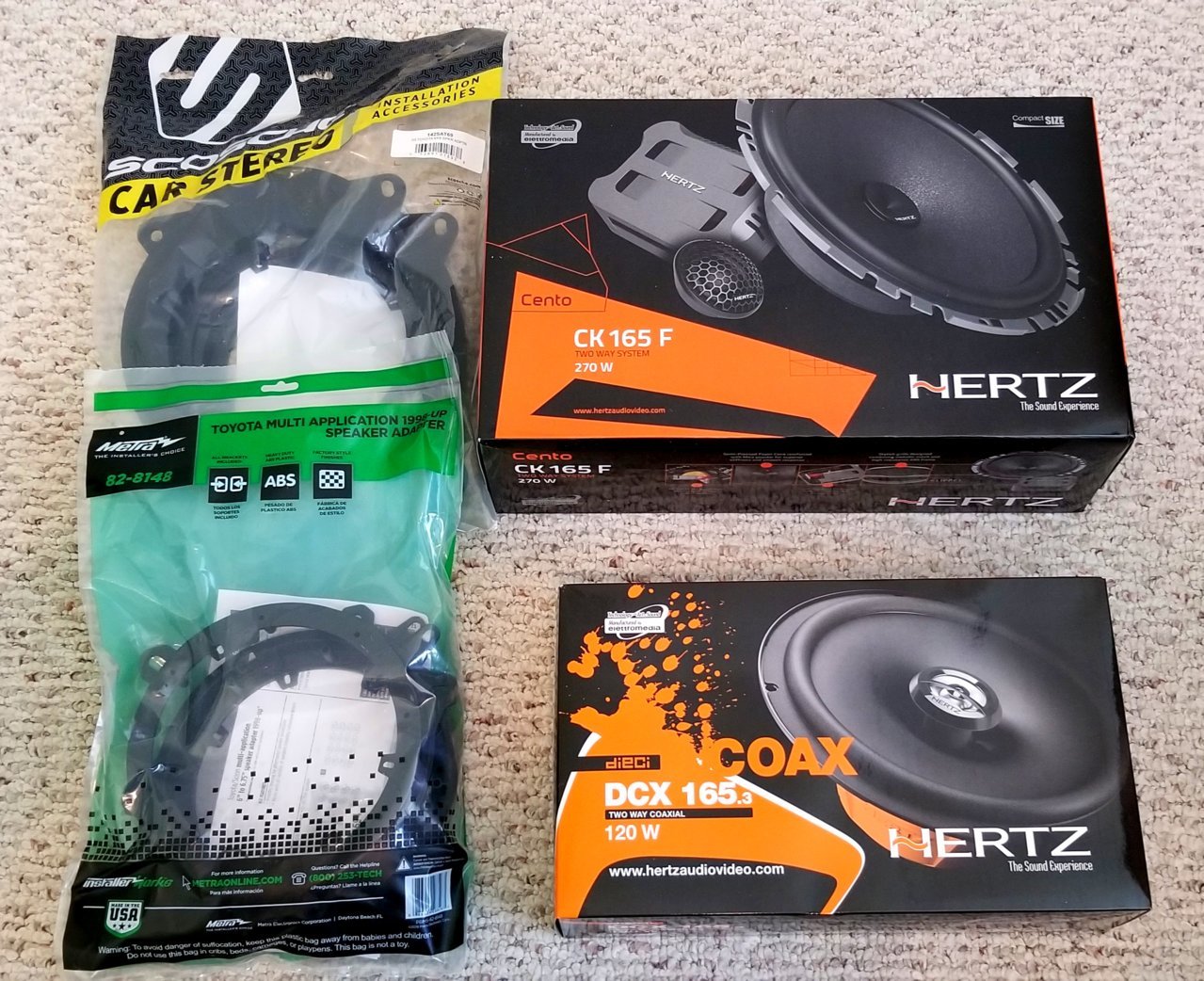

    Update
    • Front/Rear Speakers received
    • Amp & Baffles received
    • Added Audio Control's LC7i to improve audio quality of stock head unit (until I'm ready to install a 10.1 head unit)
    Rica25 and PNWTundra2021 like this.

    What sized power wire is that? If its 8ga, you might want to consider upping it to 4ga.
    Also, why are you using that multi-conductor speaker wire (i cant think of where you will need to bring 8 wires from one spot to another spot)? 18ga is pretty small, but if you aren't going to go over 50w it should be fine, but doesn't leave you with anything if you want to upgrade down the road.
  24. Mar 16, 2021 at 10:04 AM
    #114
    Tactical_TRD_Pro
    Tactical_TRD_Pro [OP] New Member
    Jan 27, 2021
    #58243
    103
    Scott
    2016 Toyota Tundra TRD Pro
    Red wire is 8ga and was recommended buy Crutchfield on original order. I'll check on 4ga.
    Multiconductor wire was recommended by installer to make the LCi7 addition work. Let me know what considerations are needed so I can address before the 4/2 install.
    Haha, eagle eyes there on the speaker wire. It was for my original plan to connect focal tweeters to focal speakers with built in crossover as recommended by Crutchfield. Switching to Hertz component speakers means I no longer need the speaker wire.
    Hope that helps!
