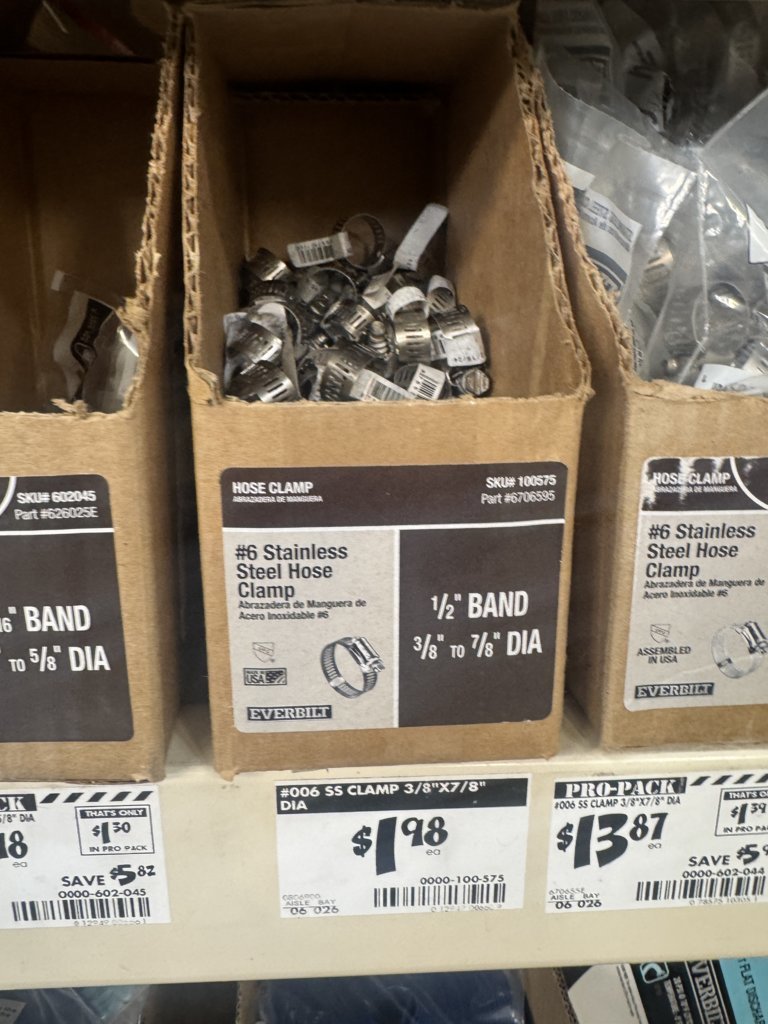

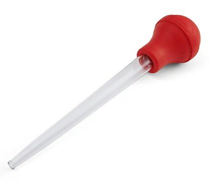

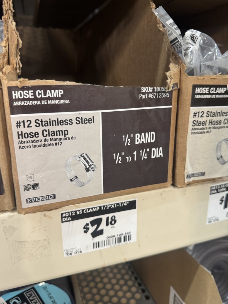

    How do I go about replacing the snake clamp? Do I have to pull the hose to be able to slip it on? My high pressure hose is leaking at the reservoir.

    Get a turkey baster or similar, remove as much fluid as you can and replace hose.

    This is how I’m going to do mine. I have the same leak. Just need to figure out what size clamp to buy.
    update: these are the clamps I bought. 1 of each worked for me
    https://youtu.be/2DkTIPUPTqg?si=McLX73n1y73cA0jD
