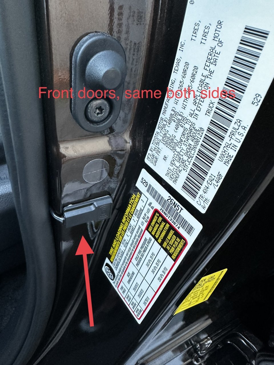

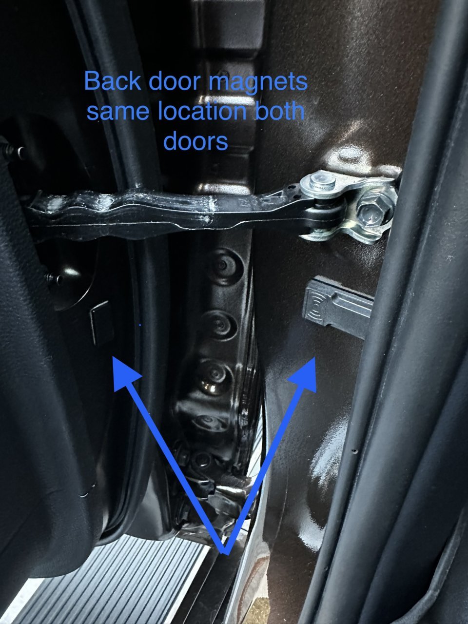

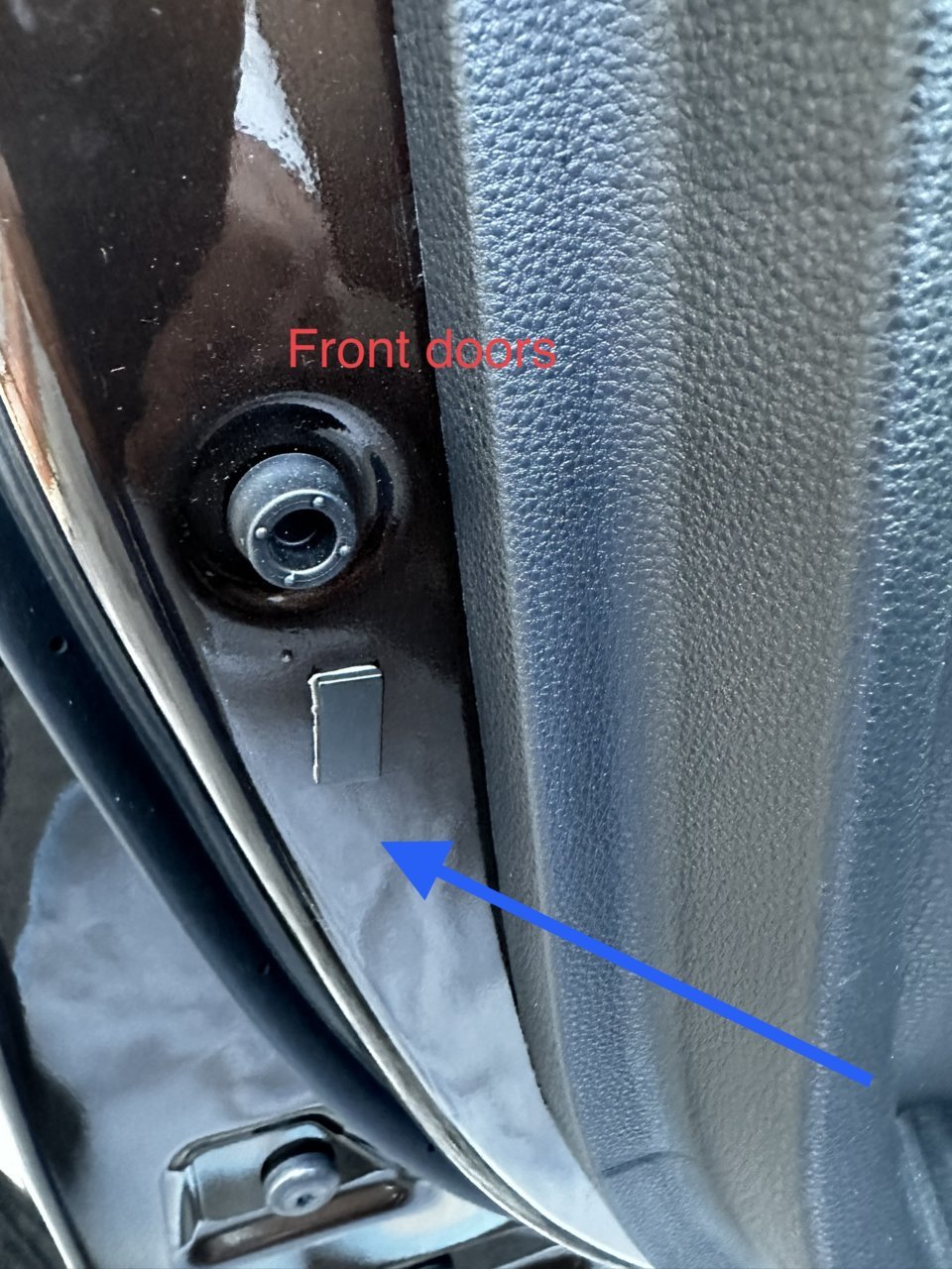

    The GoRhinos employ magnetic sensors on every door, so yes, opening the rears will also deploy the boards.

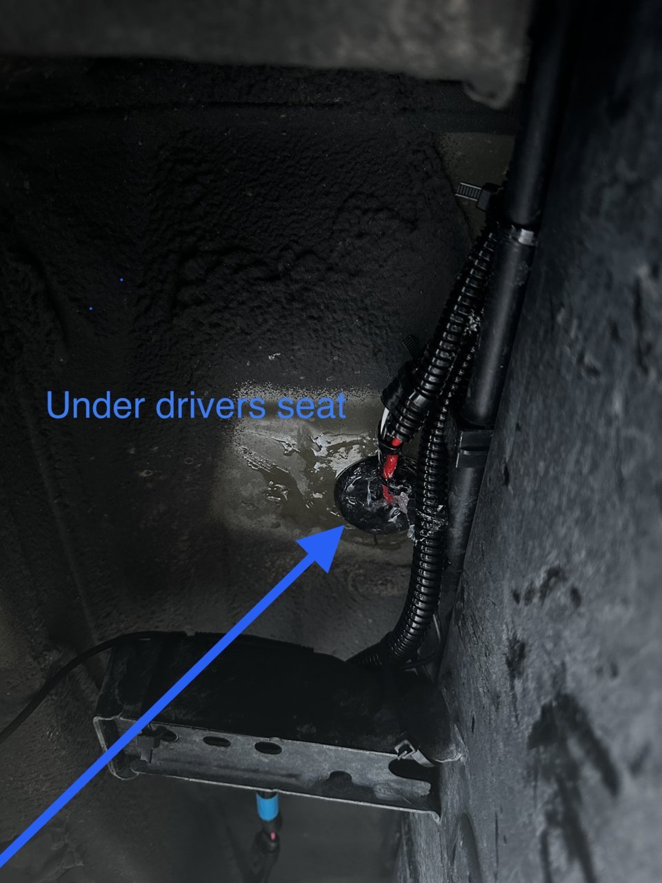

    I installed the Smittybilt yesterday they are dual motor and solid enough at least for me. I did the install differently since I have the Hybrid. Installed the control on the driver side and reverse the harness(front to back) since the battery in on this side, went under the drivers seat easily plug there. On/off bottom place it where the oem one is supposed to be and just drill the blank and glue it on top way cleaner look than the way they suggested. Passenger wire routed it together with the battery cables and then send it across under the rear seat. Located the magnets a bit different than suggested since they literally wanted the magnet on top the stickers on the driver door column. Play with the magnets with tape before committing to the location.
    I printed the gorhino instructions since they have more detailed instructions. But honestly is the same manual just with some extra pages with photos. I can add photos if anyone is interested tomorrow.
    ODShaun likes this.

    Yes please- photos would help a ton. I also have a hybrid and planning on these steps or the wait for the amp steps since that all I've have on my previous trucks

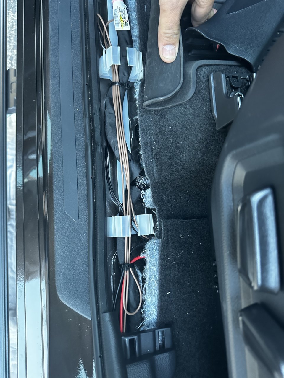

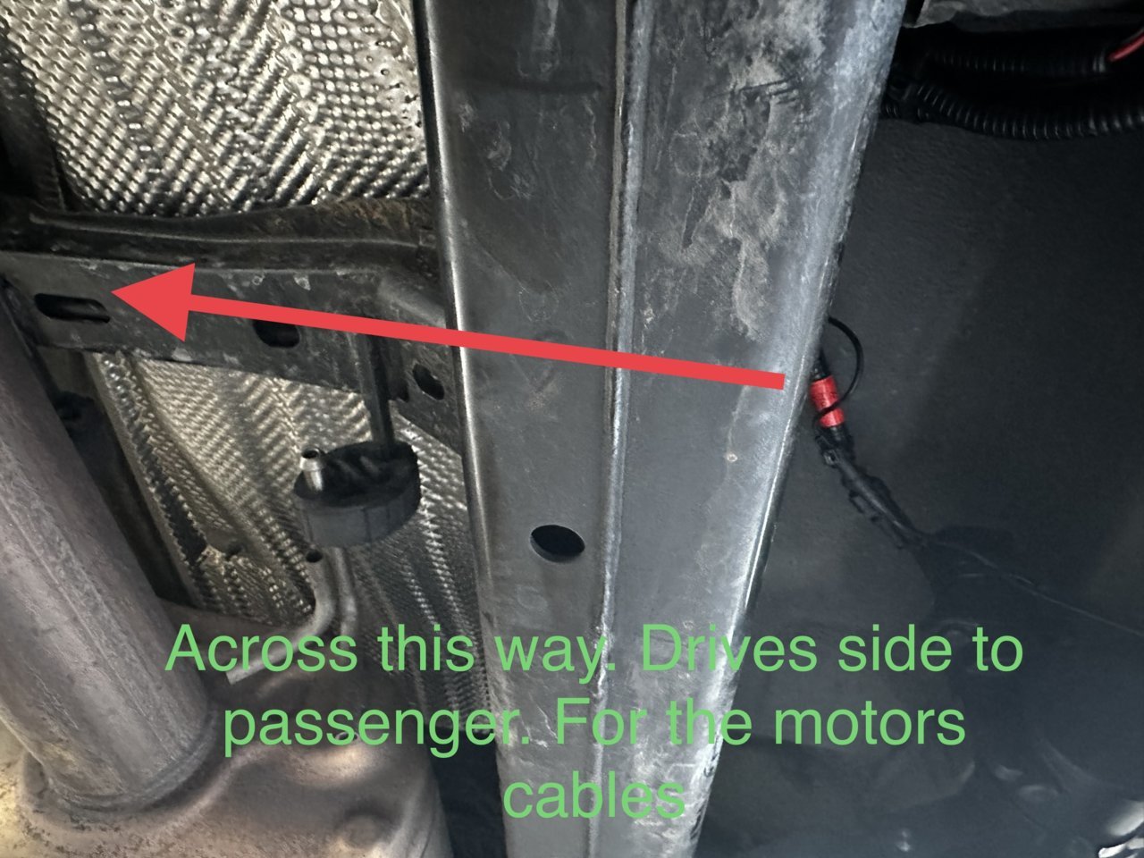

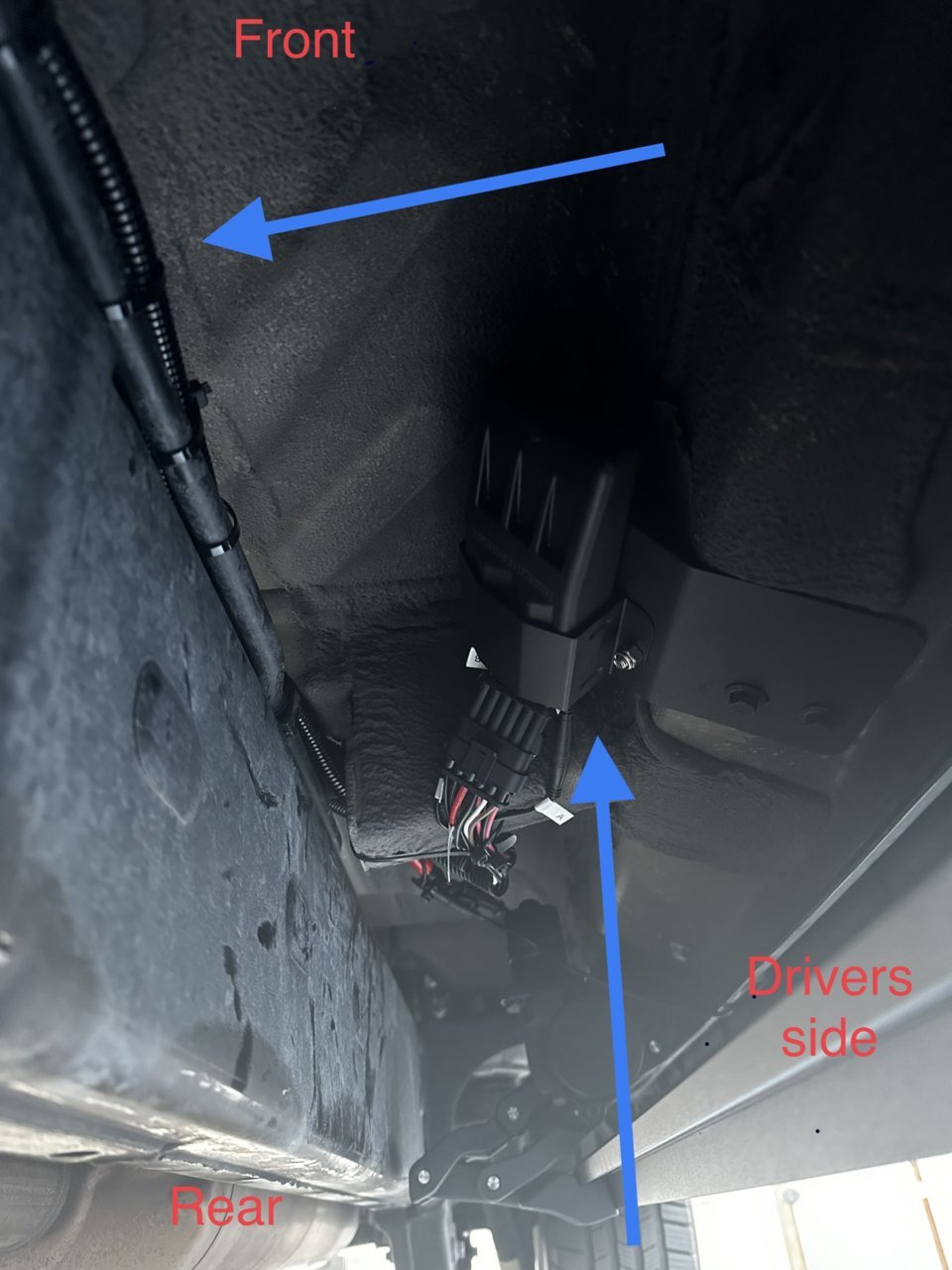

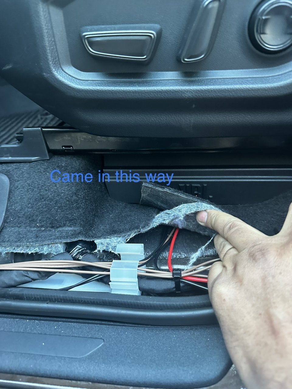

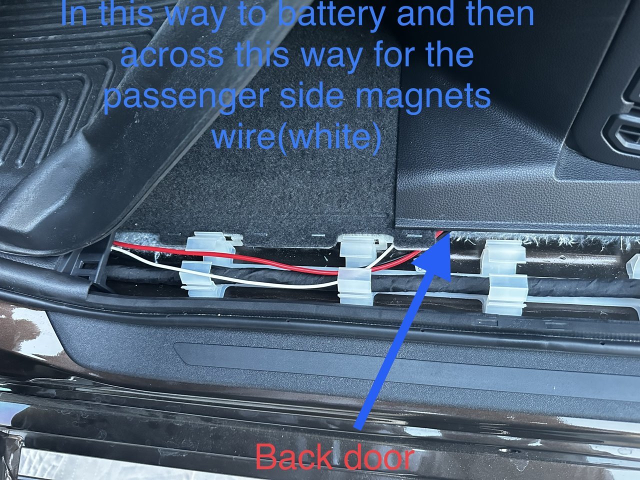

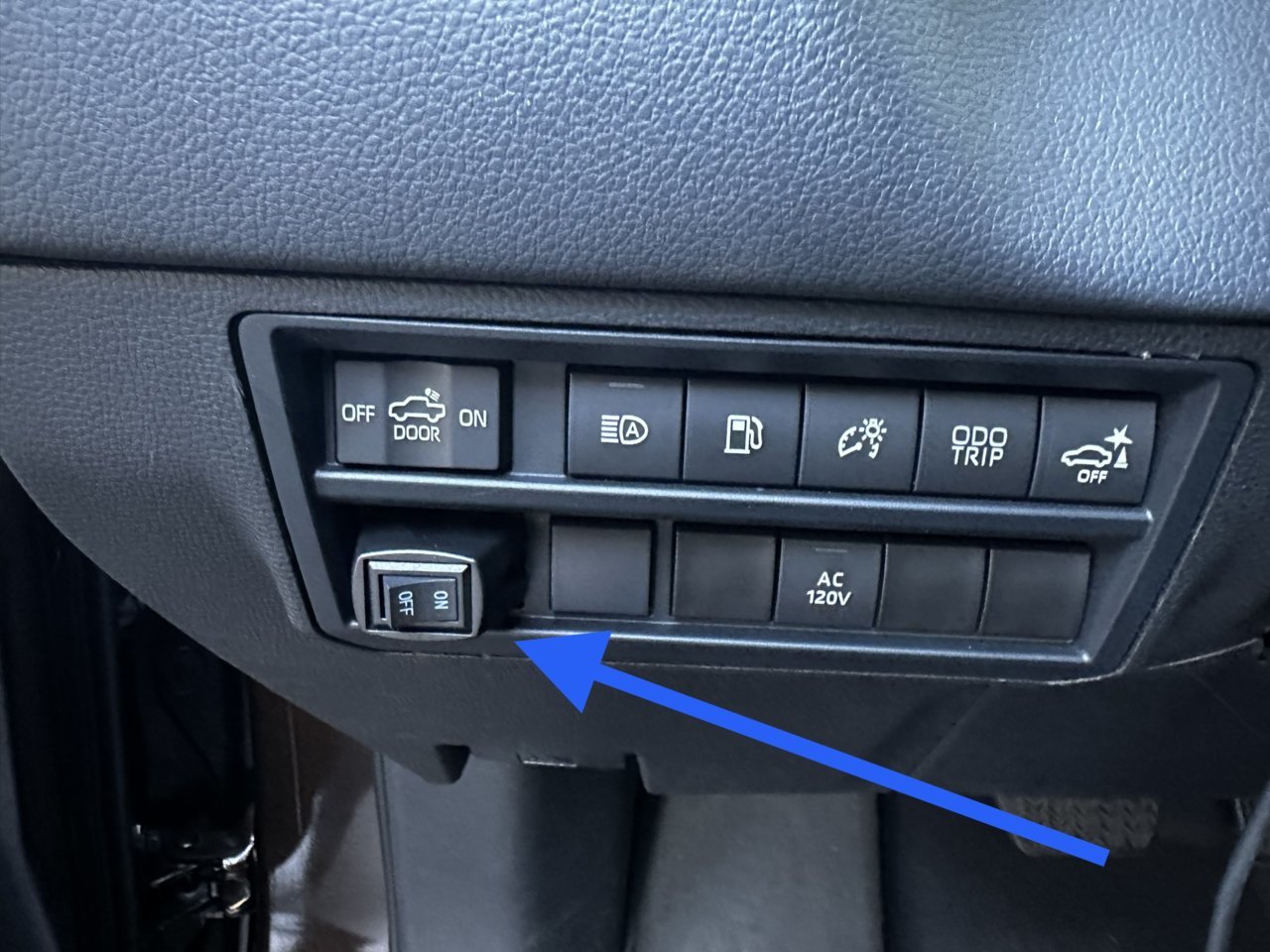

    Here are some photos. Light didn’t help for under the truck and it was cold so didn’t spent much time under. I can do more for under tomorrow if need.
    or if anyone have ? Let me know

    So, it looks like you ran the wires that had to cross from one side to the other UNDER the truck above the driveshaft and exhaust? No issues with clearance or heat? Doing similar with the Rhinos would make the job a little easier and not require mucking about so much in the interior.
  14. Feb 12, 2023 at 12:17 PM
    #104
    Tikisia
    Tikisia New Member
    Jul 14, 2022
    #80699
    23
    Yes and no.
    The harness that came with my had a heat insulation for the motor wire that was to make it across. But to be safe I removed the 2 front screws for the heat shield and runt it behind the shield and above the side Pilar. Way out of the heat and driveshaft then above the gas tank. the only wire I run across inside was for the passenger doors magnets. If I’m not mistaken your kit would be run the same way(I print it to get more references)
    Doing it this way saves so much time. Since everything at least for the hybrid will stay in 1 side and just 1 wire needs to make it across in the inside. I can make a video from under tomorrow to show better how I did the wires, hard to see with photos.
    raylo[QUOTED] likes this.

    The Rhino kit has both motor power harnesses coming from the front on each side so the only ones that need to cross over to the driver's side are the driver's door sense wires and master switch wires. The official instructions take those across through the interior. Which could be a PITA.

    I was scratching head on how bring wires inside without having to take much things apart and making a clean install. The way that I did it was so much easier. At least imo

    I installed the running boards on Sunday and I am 98% done. I just need to mount the switch in the dash but I need hide one of the cords a little better under the carpet so that it doesn't show under the drivers seat.
    The instructions are confusing in a few sections and are one of those jobs that would take half the time if you did it again. I wasted time at a couple different points just trying to translate what they are saying and ultimately found the pictures more helpful. Overall it took about 5 hours to get them installed compared to the 2-3 that they say in the instructions.
    There are 2 cords that need to route from the passenger side driver module to the drivers side. One of them is for the driver side motors and that one routes under the truck similar to what Tikisia has in his pictures and is straight forward. The other one contains the door trigger and plug for the switch. I was able to just push them under the rear of center console by hand without taking anything apart. The trick here is that you need to push them as far as you can towards the front of the truck and to the pull to the drivers side. There is ample cable for the door trigger but if you want to mount the switch to the left of the wheel then you need every inch you can get of the cable.

    So those wires you pulled under the rear of the console that need to go towards the front of the truck, did they go behind the driver's seat to the sill and then up? Or did you feed them under the console to the front and then over to the driver door? I am still having a hard time visualizing how to get these wires over there without removing the drivers seat.
    Yup, almost every job we do, if you had it to do again it would take half the time. That just the way this stuff is. :-/

    Under the center console and then under the driver seat over to the sill. I did not remove any seats or take apart the center console. You just need to push the seats as far forward as they go to be able to easily access the split in the carpet.
