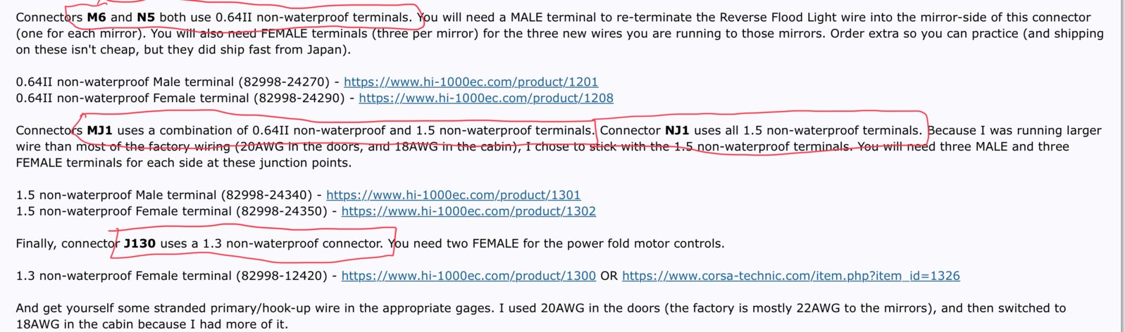

    Ah the side profile in that pic makes that terminal seem smaller somewhat looking like a tweeter connection.
    Yes, the terminals are female in the plug/harness.

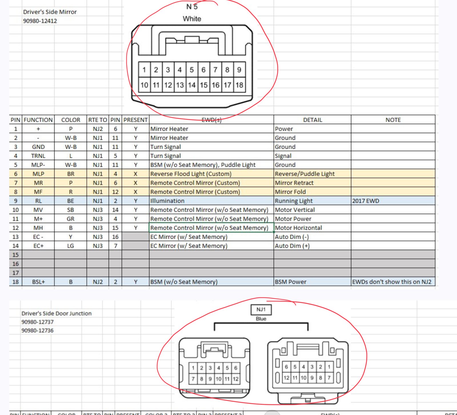

    The connectors at the mirror are 064 terminals (smaller). The mirror itself are the male terminals, and the door harness are female terminals.
    any time you see a connector name that is two letters (like NJ1) that’s a junction connector…like the ones in the lower kick panel.

    From the link in my build thread:
    Connectors starting with N are for the driver’s side front door. M connectors correspond with passenger front door. J connectors are instrument panel area (most of the entire dash).
    Look at the pictures with the wiring pinout info to see what the connector looks like compared to the ones on the truck.
    I realize that reading these diagrams is second nature for me, so a lot of this is pops and buzzes for others. Just trying to help clarify where to find the information.
    Also - you do not HAVE to route your wires through the junction connectors like I did (the Boost wiring harness isn’t set up that way anyway). I chose to only to make it look at OEM as possible in my installation.
    Finally, you can buy the terminals direct from Toyota using the part numbers I listed if you only need a few. Expect to pay $5-$8/each for them, but they will come with a pigtail of wire already attached so you don’t need to attempt crimping. Obviously I buy in larger quantities to justify the $30 per order shipping from japan on the ones I linkes

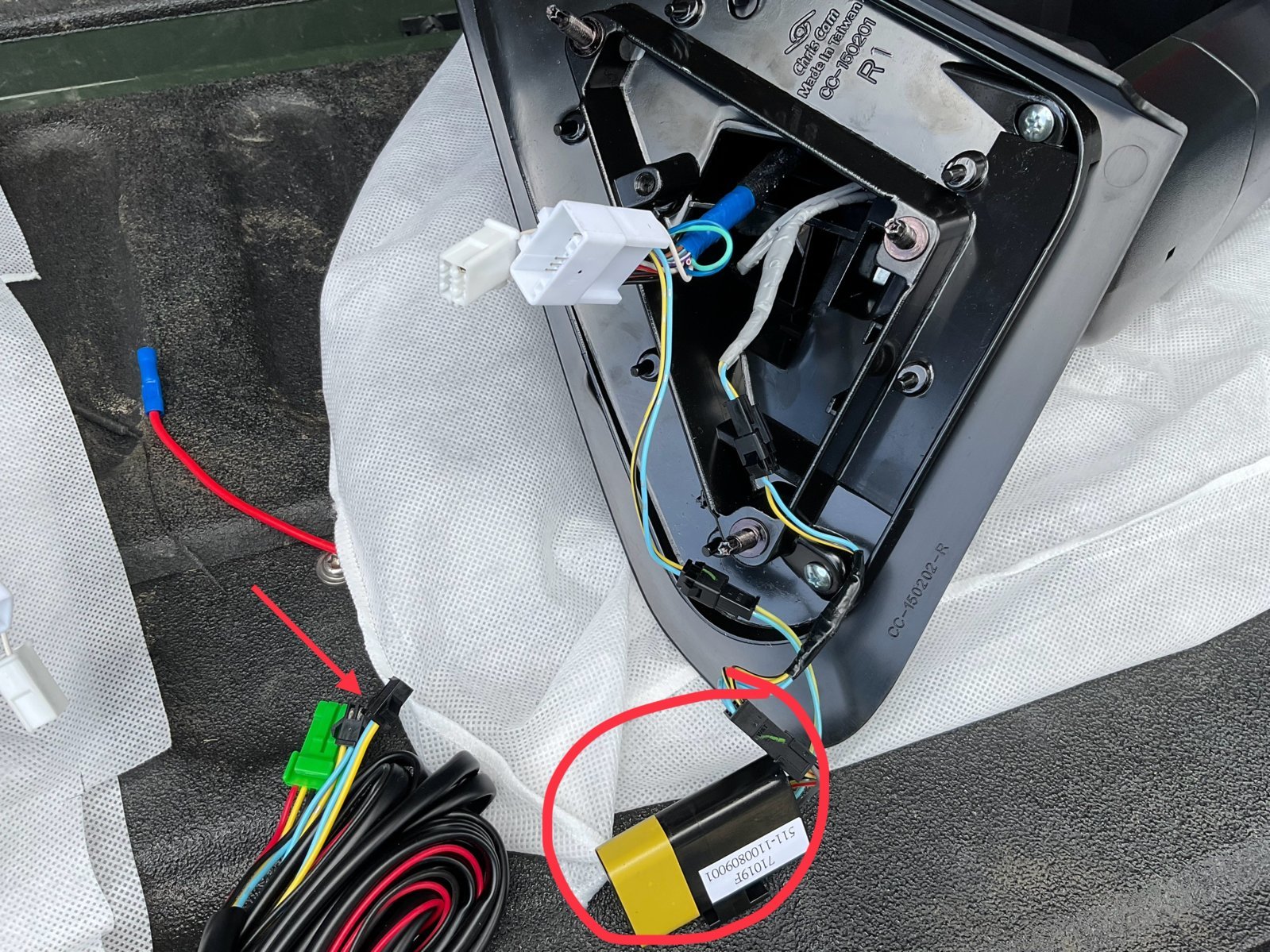

    Got it. Then I need 2 x female 064 terminals per side. Thanks!
    I am a wiring novice, so even though I read that post several times, I was apparently looking at the wrong connector. But now that I know the right parts to order, I think I’ll be good. In our emails back and forth today, Boost Auto said this thing is a circuit breaker. Seems obnoxiously large to me, but clearly I’m no expert. :notsure:
