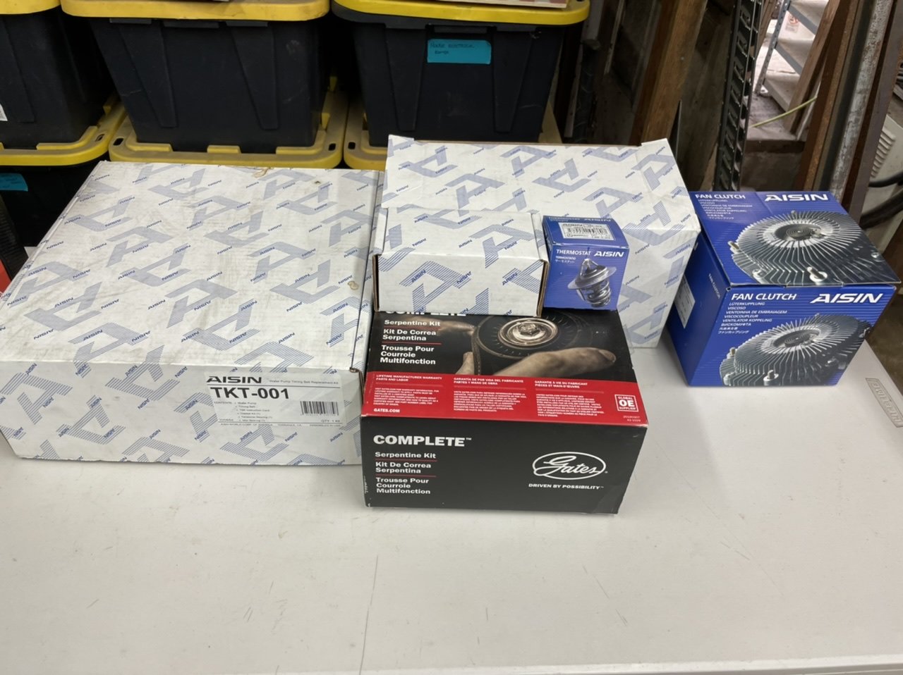

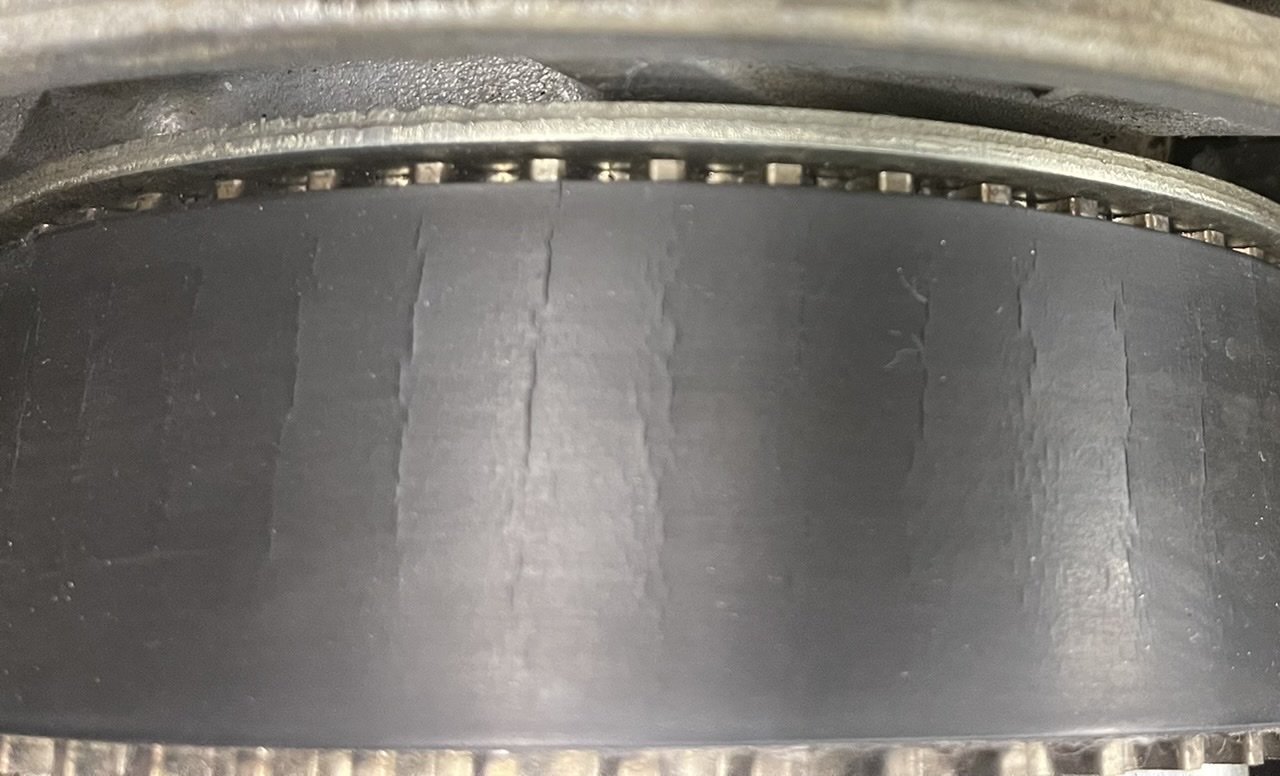

    There is some dumb in this thread. The 4.7 is interference, meaning valve touch pistons you’re fawked. I’d love to talk to someone who said the engine was fine after a T Belt snapped.
    Op, cut your losses. If you ain’t doing the work yourself, let it go. These first gens are getting old and are in need or work time to time. If you don’t work on your truck yourself, it’s time to move to something newer.
    I’m pulling mine apart now, looks like I dodged a bullet with my belt, showing major cracks no idea when the last belt was done and I’m at 280k.
    No real reason to go through Toyota for these parts. Remember you are going to replace them again in 90k. Aisin and Gates are fine. Less that $500 for all pulleys, belts and tensioner including fan clutch and mount.
    F040935A-CAC0-4046-9A8F-0D88C7F75BE6.jpg 2CF45F3E-9334-4A8C-A11B-C13EF7067040.jpg D76EB293-8F45-49BE-9304-1C3599A35275.jpg
