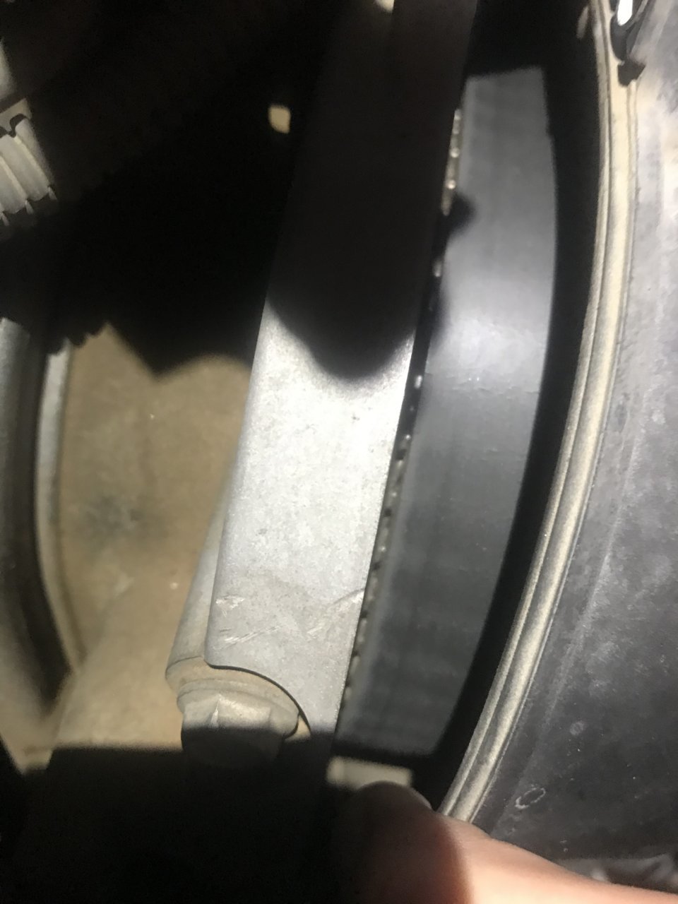

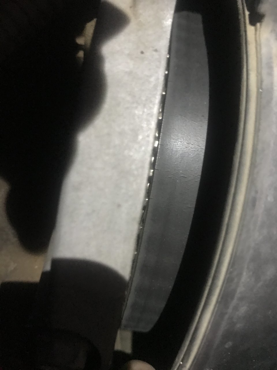

    This what mine looks like. Sucks that going to college is so expensive otherwise I would of replaced it as soon as I bought the truck.

    That needs replacing.

    Yes it does
