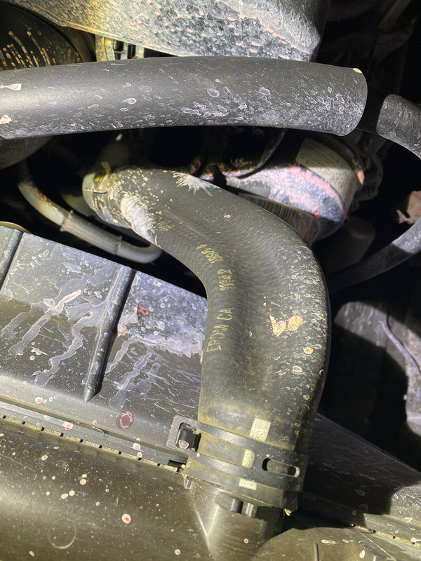

    Sequoia engine might be your best bet they are pretty cheap and more common in LA then a 05-06 tundra. Hopefully no damage was done.
    my buddy drove from LA -Vegas this weekend in a 07 sequoia. Truck over heated after Barstow the whole way, He just kept driving. Coolant blew up out of the res and had the lines all sucked in.
    Walked him thru how to check for issues, they put coolant back in 2 gallons (it was empty empty). Drove it back no issues. I looked at it yesterday and couldn’t find any issues. Taking it to a shop this week for a full look. Anyways these engines have a lot of give.
    any photos? We like phots

    Since you didn't report hearing any carnage I'm still hoping you get lucky like the other guys. I would think if anything, VVTI might be a bit more since there were less made with VVTI therefore there might be fewer engines to pick from. :fingerscrossed: for you though.

    Might suggest to change the thermostat, also I wouldn't ever be loaning any ride to that buddy if I were you!
    jerryallday[QUOTED] likes this.

    Funny thing, he did a oil change and had someone give it a look before heading out earlier in the week.
    It was 115 in Vegas this weekend. I told him to be cautious after Baker on the 15 because I have over heated there many many years ago in a 07 Camry ( ac full blast, fully loaded down with luggage and ppl, going 90+) he confirmed he was doing the same :).
    everytime I drive that that section I cut the ac now or anytime I see signs that say “cut ac to prevent overheating”
    One more photo
