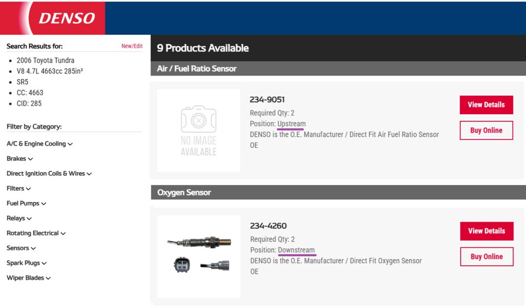

    O2 sensors shouldn't be the amount you quoted. Downstream are usually cheaper also. What codes are you getting?

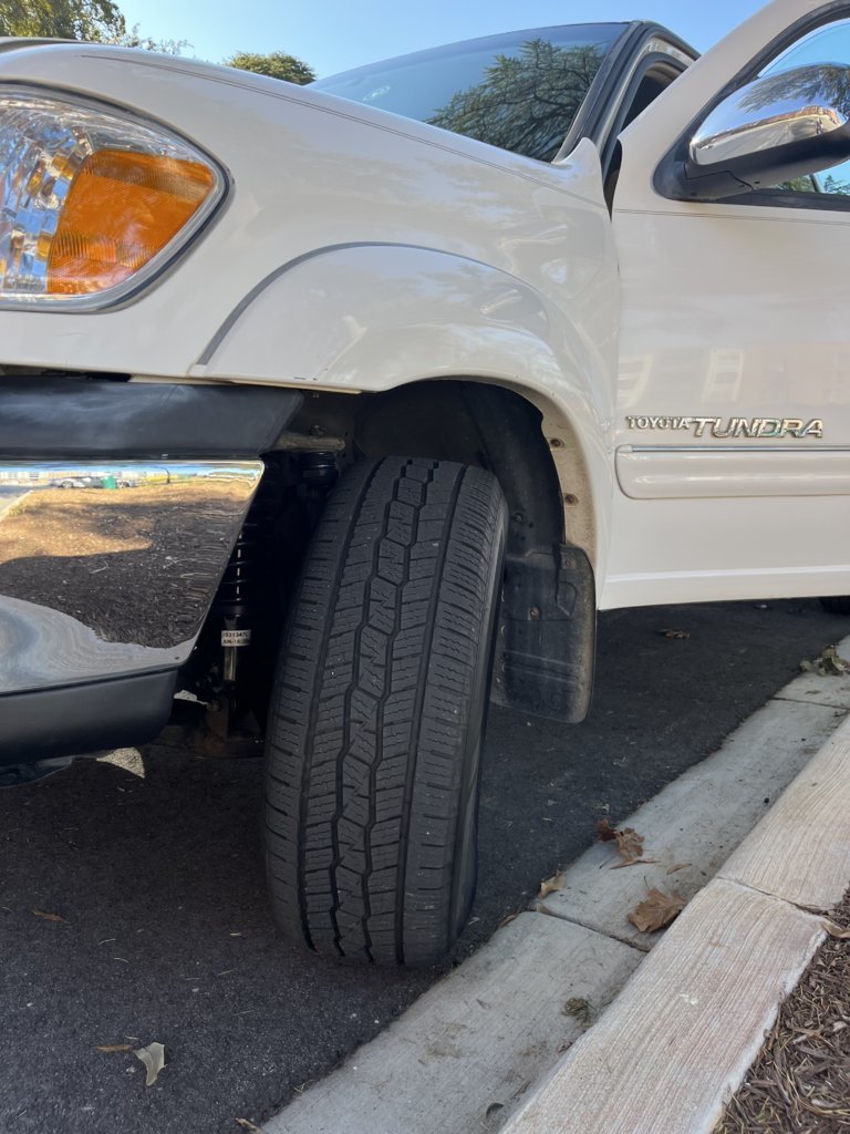

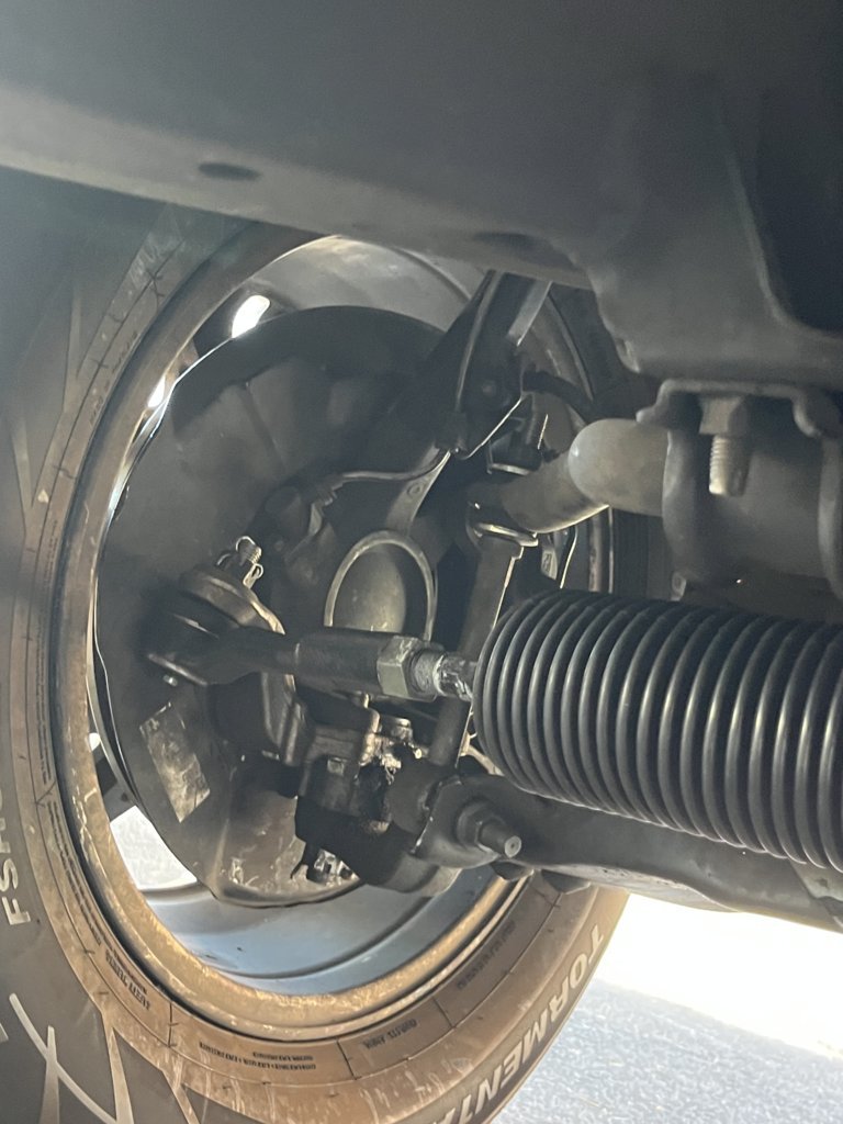

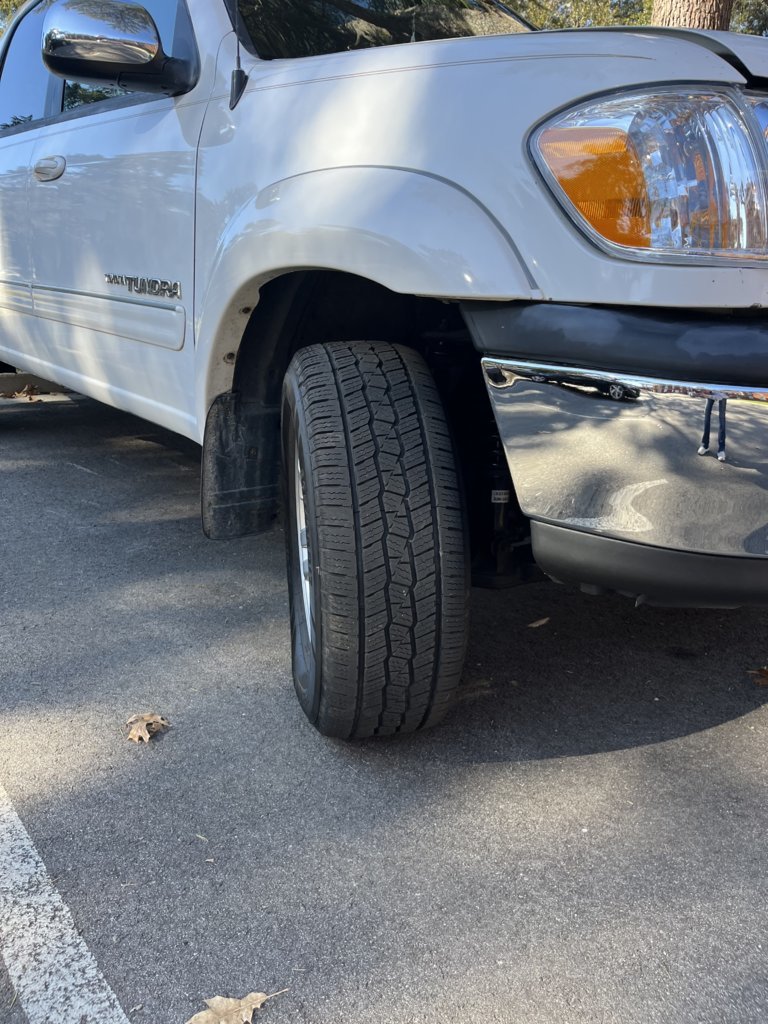

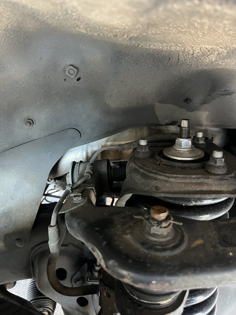

    Jen - can you take some photos of your truck showing the suspension, control arm bushing, alignment cams, LBJs etc? Also let’s see your carrier bearing.

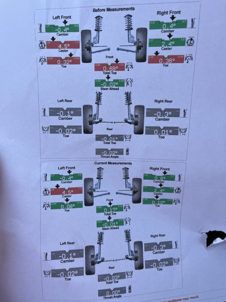

    Caster not moving ... wondering if the cam is frozen on that side. Maybe is the source of your alignment woes. @assassin10000, you're one of the few internet people I'd trust to give input on those alignment results, what say ye?

    Caster is the pull to the left most likely. If the alignment cam is seized in the bushing, this is why they were recommending new control arms/bushings. Not cheap.
    Unfortunately they only did a toe set, not a full alignment. You'd have to find out if their tech even did anything with the cam bolts. They could even be fine.

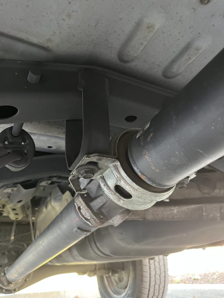

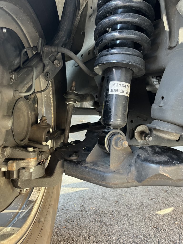

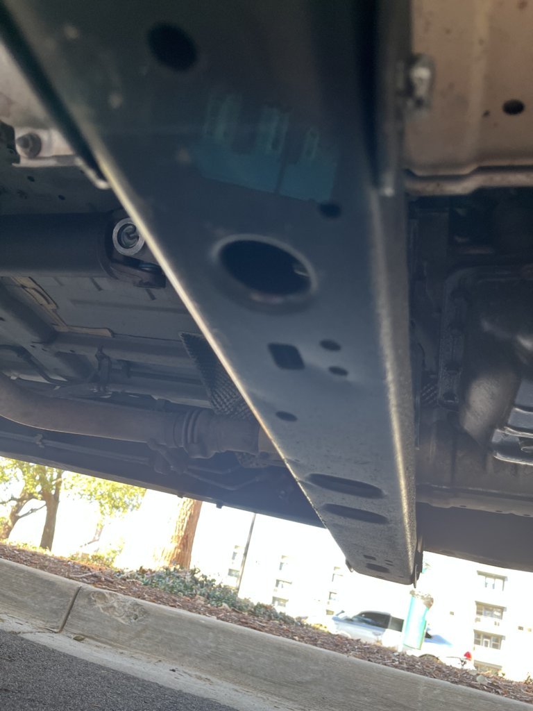

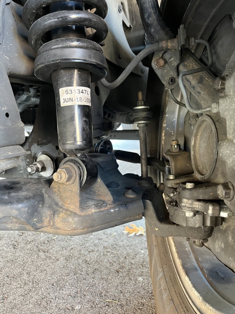

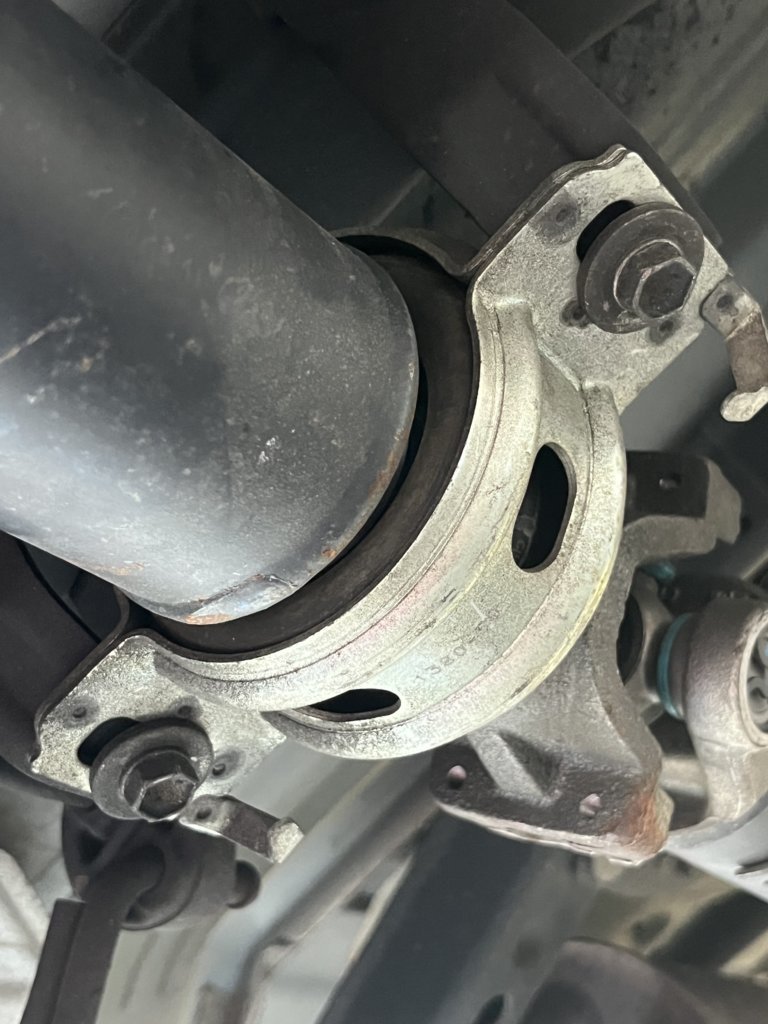

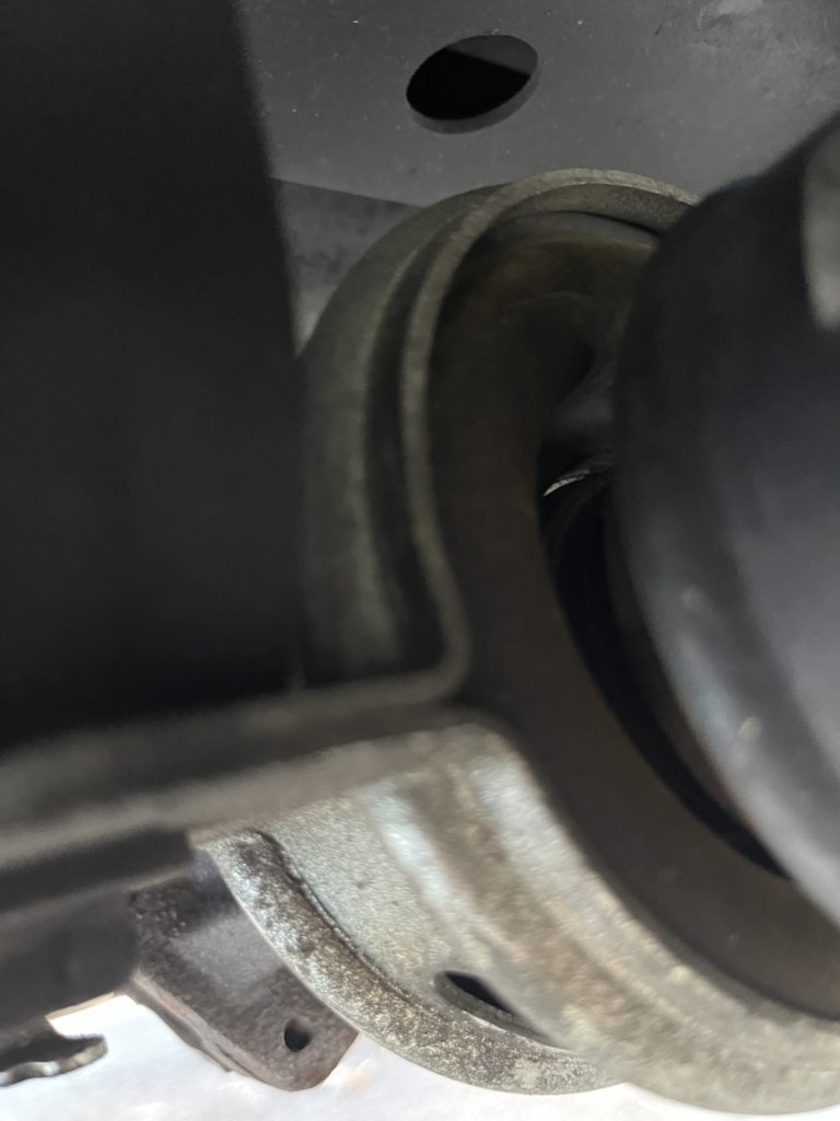

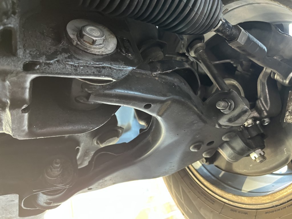

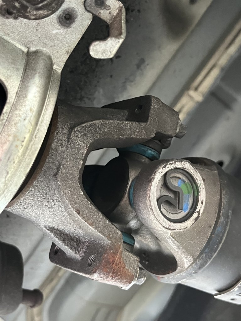

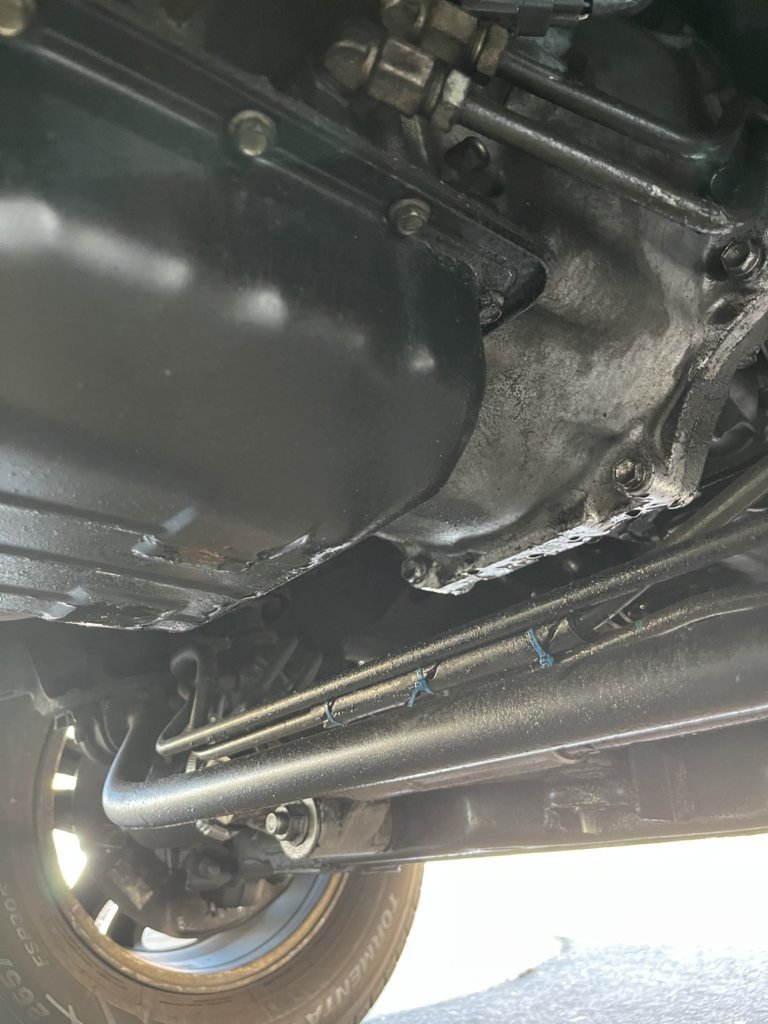

    Yesss! I'd be happy to! I'll go out on my break. Lbj is lower ball joint? And I got the big wigs on property today so I'll explain all the other stuff as soon as I get a chance. Thanks ya'll

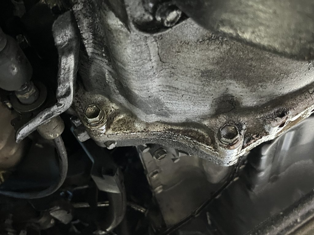

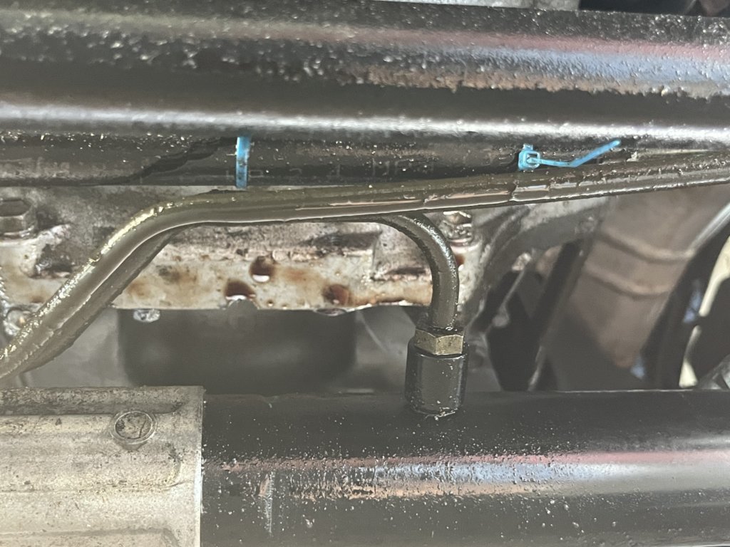

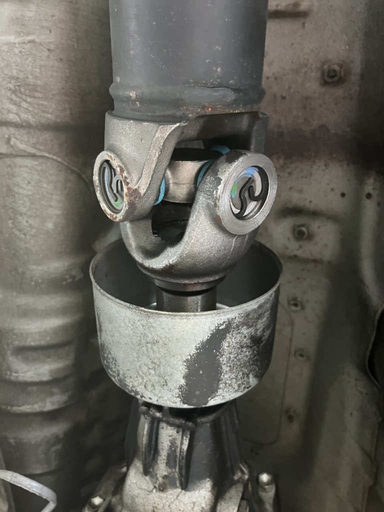

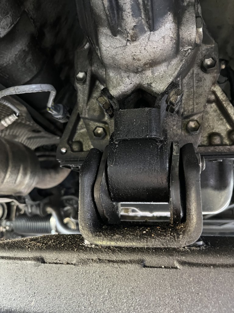

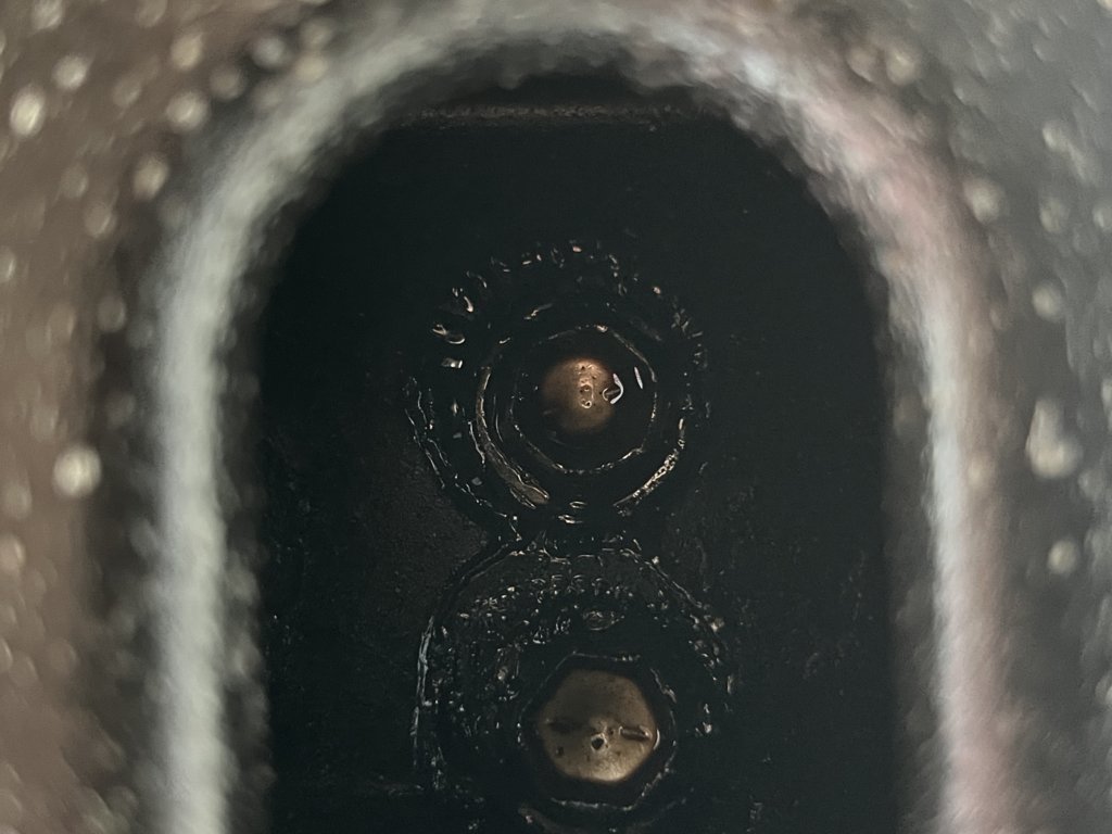

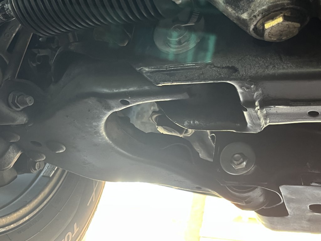

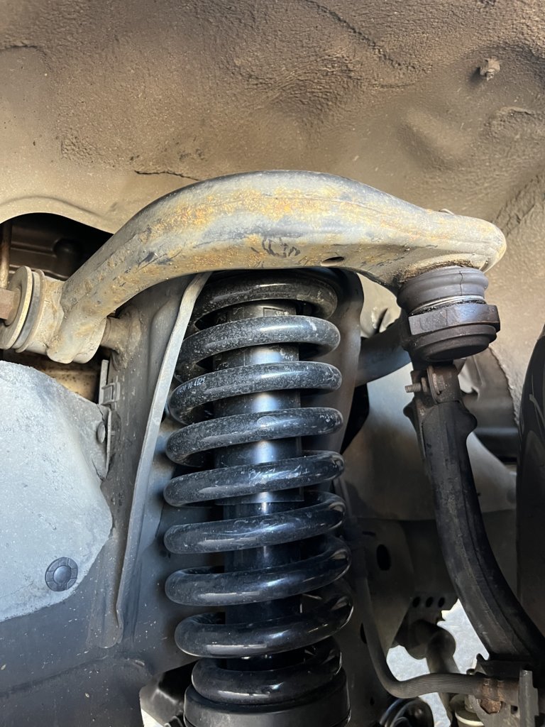

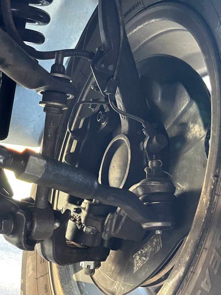

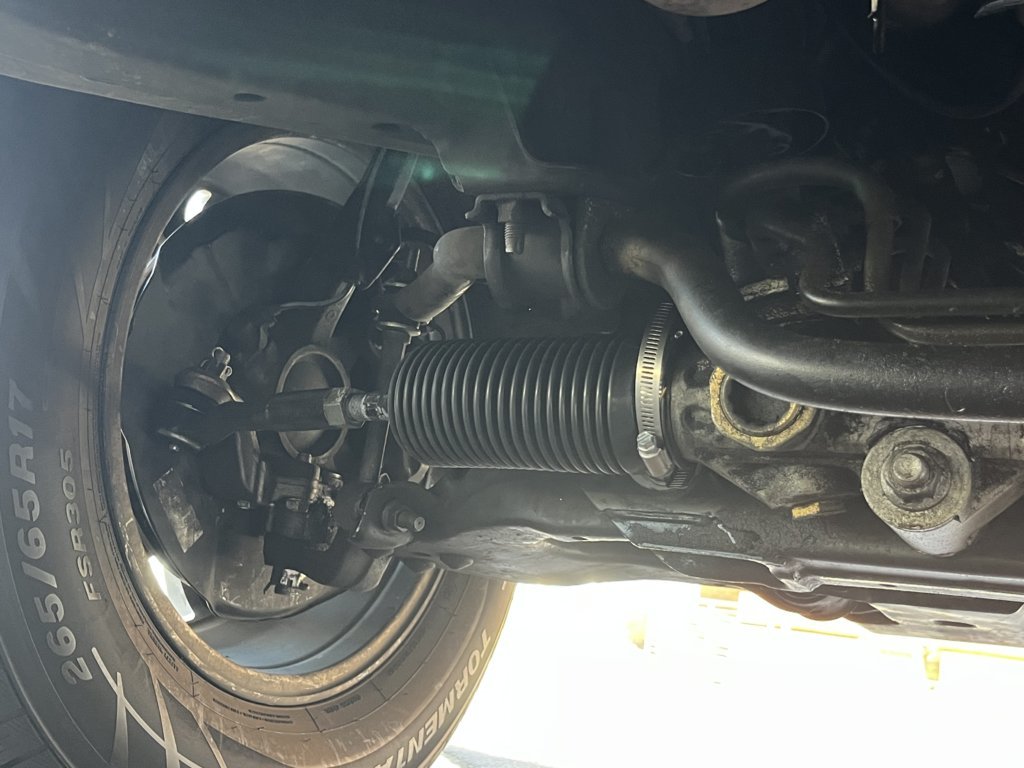

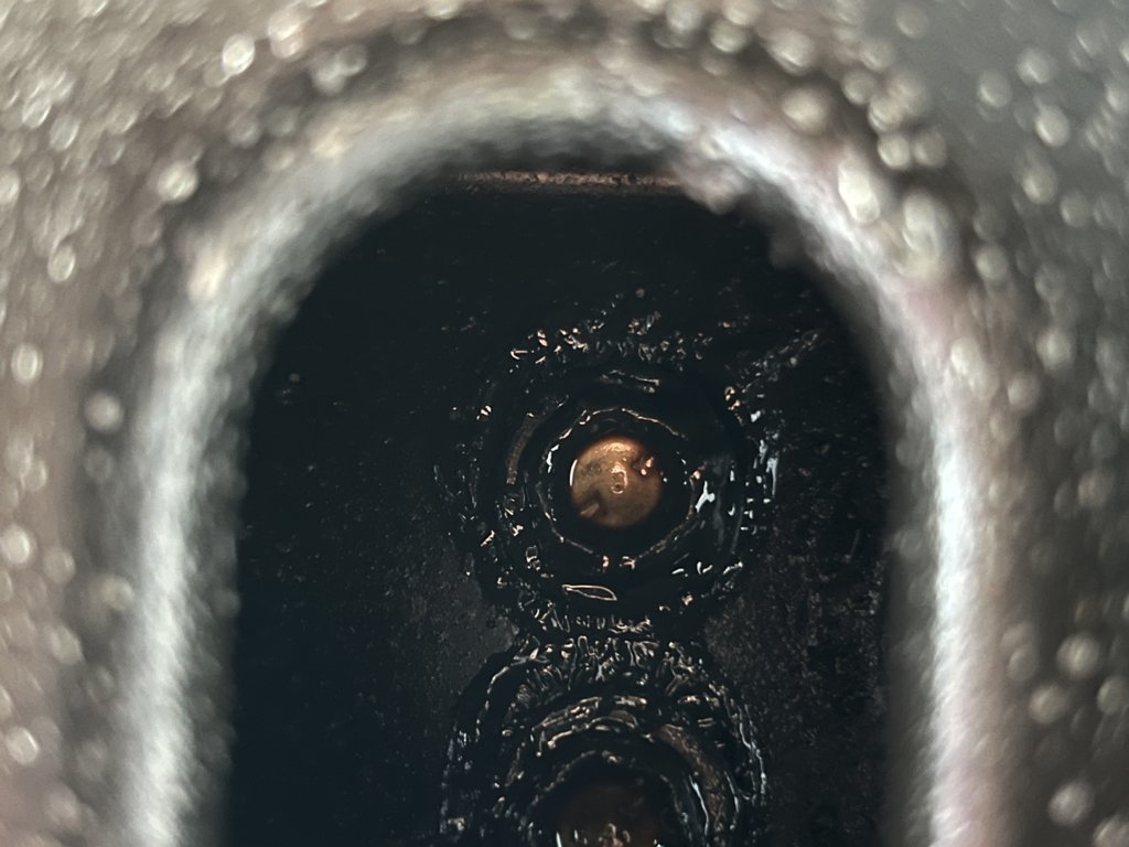

    I think I got them all? Did I miss something? And a few of those are of all the oil, I didn't realize it had gotten so bad. I just got back from running to the store and had a few min to get under her and take pics...I've got to get some of that uv dye and run out thru to find the leak. There's no oil on my driveway, so it must be just while I'm driving and it's coating the bottom of the truck. So you're saying they didn't do a full alignment? I ended up having to get the caster and camber bolt replaced on the front drivers side, then took it back for him to complete it, and that's when the boot got twisted up like those other pics I had sent before. So I took it back up again and the manager fixed it. As you can see in the 2 front tire pics, especially the driver side...the tire is sitting wrong. And I'm at the point that since I can't do some kind of conference call with ya'll (lol) I feel like I need to take her to that shop in Dalzell, that one of ya'll recommended. Do you think it's ok to drive her for about a week, while I take my car in to get the valve cover done, then take the truck and drop her off? Cause I've got to have a vehicle to drive while the other one is getting work done. This is so freaking stressful and overwhelming having 2 rides that both have needed so much work done, continuously!! Yes, I broke the rotors and pads in as soon as he got done. I didn't get home till he was already about done so I have no idea if he used brake cleaner, but I will find out. I still have to call him to find out why he suggested replacing the cross member bushing. But I did post a pic of it. The carrier bearing he said the rubber was worn and hard and that the driveshaft (while the torque is high? Did I say that right?) it tightens up and then relaxes(that doesn't sound right, but I don't know how else to describe it) but that the vibration could be coming from that. I just realized I didn't take a pic of the top of the cross member where the 4 bolts are, only the bottom. I'll do it as soon as I can. I'm trying to scroll up and down to the find all the questions that were asked. So if I'm missing some, I apologize. Also, the drive shaft is new, from auto zone and replaced a little over a year ago. Same time the engine was replaced. Brand new on both of them. And the truck has about 5,000 miles on it since it was done, if that helps anything. Oh yeah, so...it's it possible to chat on zoom or something like that to make things a little easier? Just an idea, definitely understand if it isn't an option. And still extremely fucking grateful to all of you!

    Jen - appears your lower ball joints have Zirc fittings. Those are not OEM. You need to verify this and if so, replace them ASAP. This is the biggest threat to your truck unless TB is also aftermarket. It's not a hard job if you have some basic tools and a floor jack. Valve covers are definitely leaking but that's an easy driveway job with basic tools - be sure to get either OEM or FELPRO only. I would replace the valve cover bolts as they have a rubber donut that gets hard. Delphi kit has the donuts. OEM you need to buy the bolts. Be careful not to overtighten these. Don't forget to use some FIPG on the half moons and corners. Steering boot is kinda funky and hose clamp is not the FSM solution - should be an Oetiker clamp. Carrier bearing is upside down but doesn't look that bad and they normally have some play. Need to compare with a good one.
    @shifty` - please look at Jen’s LBJ photo to make sure I’m not hallucinating.

    Them LBJ's are sus.
    100% looks like a zerk and someone filled the fuck outta it with grease to make it stop clunking/popping.
    carrier bearing looks fine.
    UCA bushings look fine.
    UBJ look fine as well, boot isn't greasy/wet looking.
    Lower shock bushings look fucked. Not sure if those are cheapo replacements, but those are notorious for the lower bushing giving out. Another source of clunks.
    Oil leak could be as simple as the valve cover bolts are just loose. (Mine were) 10mm rachet and snug them down. Takes all of 10min. Solved my oil leak.
    Sounds like the current mech you got is your typical bottom of the barrel shmuck. Lol
    could probably do a great job on a Chevy or ford. But these Toyotas are another animal all together.

    Pretty sure the carrier bearing is supposed to have the single hole down. Even looks like the helper tab is pointed upside down in the pic.

    Aftermarket lower ball joints need to be replaced asap. OEM only.
    Aftermarket cam alignment bolt and sleeve as well. They use plastic inside and can clunk.
    Struts are cheap china replacements and should be replaced one day. Unsure how long they'll last but the bushing already looks like its going out. This can be held off on until later.
    Crossmember has all the bolts but can still be cracked and its not visible with all the grime.
    Jsim[OP] likes this.

    Driveshaft is so far up in it, it looks like a buttplug too. Totally looks off.
    Looks like shadetree-level work, cheapest possible parts, across the board.
    I'm trying to figure out how/why there's so much grime UNDER that crossmember.

    Also, do the 2wd’s not get double cardin joints there?

    I think the grime is from having the oil leak and it being blown back onto everything when I'm driving, picking up all kinds of crap. But what do I know?! Especially from all the feedback from ya'll...so is there anything right?! And what needs the most attention first? Is it OK to even drive, or am I taking a chance of fucking up my truck and getting stranded? And thank you for all the feedback, but damn that shit is so hard to hear...especially after the amount of money spent. I have no idea about the drive shaft...as I said, the previous owner bought it from auto zone brand new and put it on himself. Everything else I've had done was by one mechanic, outside of the alignment and the front brakes that both just got done within the past month. I'm getting tires balanced again now. And honestly, damn near close to tears. No I don't have a 10mm ratchet, but I guess I'm going to get one. Thanks guys, I appreciate the bad news! Lol! But for real though, I really do...just sucks.

    No, 2000 2WD does not have a double carden joint. And yes the carrier bearing holder is upside down.
